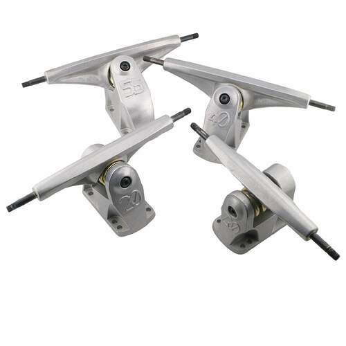

Have you heard about the Seismic Trucks with two springs? It looks similar to this design except it has two springs that support the trucks for turning
Believe it or not I am actually trying to improve a derivative version of them, although not quite it’s more of inspired by them and aims to solve multiple problems at once

It sounds very interesting. Have you figured out how you’re going to source axles? That’s often one of the more difficult and least “Over the counter” parts for making trucks, especially when wanting to use cheap and readily available components.
So I’ve actually been making trucks for a long time, and I was one of the people who helped with the product development on Other Planet trucks in the first place. IDK how much direct help I can be when you want to be careful not to spill the beans, but if you ever have any specific questions I might be any help on, feel free to reach out.
I would also encourage you to look at the HST truck.
If what you’re making is derivative off the S10, well. Hamboards has improved that design in several significant ways that are probably worth learning about. Taking advantage of the lessons learned by other people doing similar things is always a good idea, and there maybe be some applicable things for you from there.
So I actually didn’t know about that, thank you very much I’m going to be looking into that for sure
For sourcing axles I’m going to give them the option of getting 12 mm axles from MBS for the Matrix 3, or 8 mm axles from Aera, I figured that those are already well tested and liked and trusted and I’ve designed my trucks to be able to take those stock without any mods
