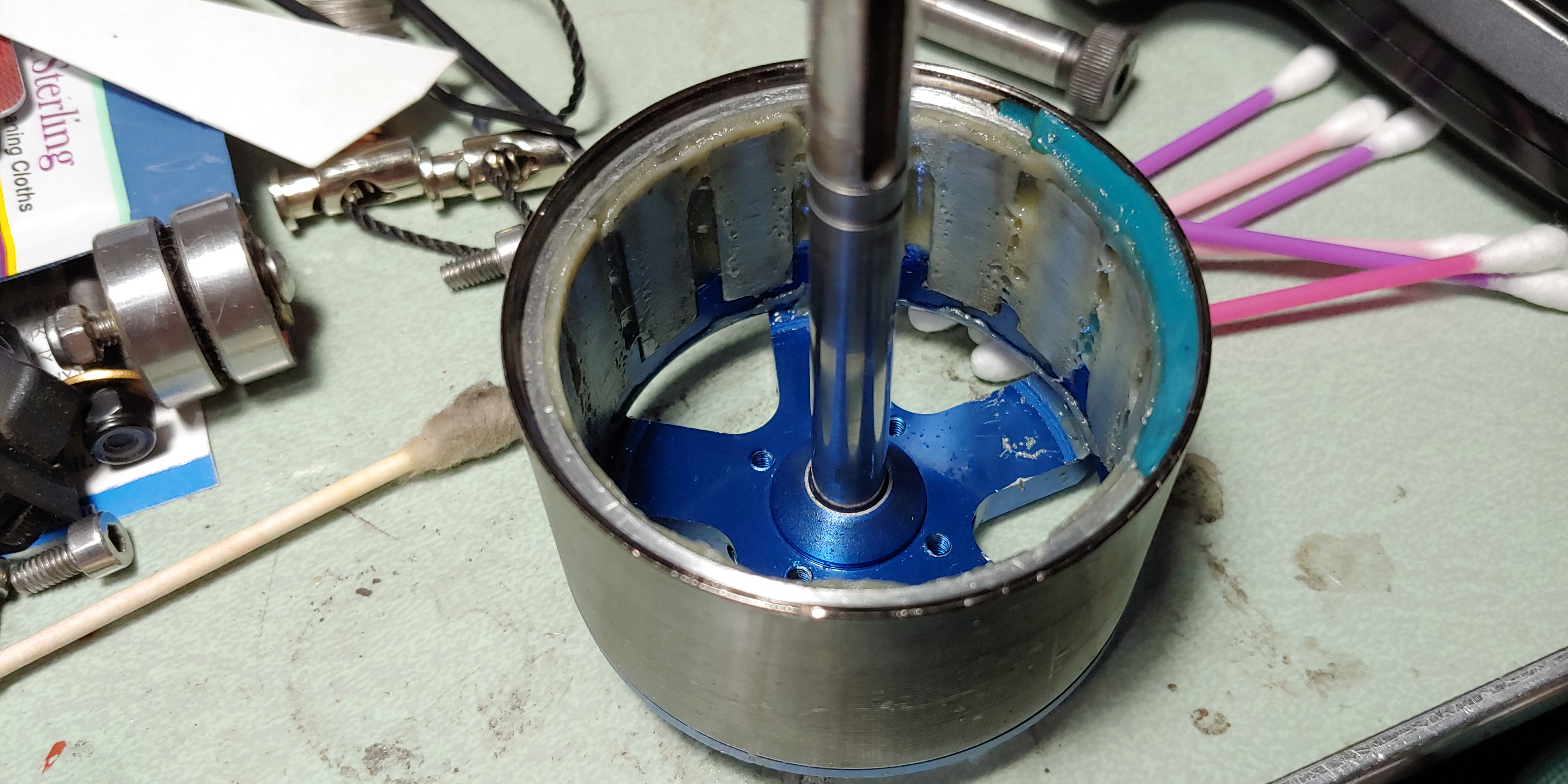

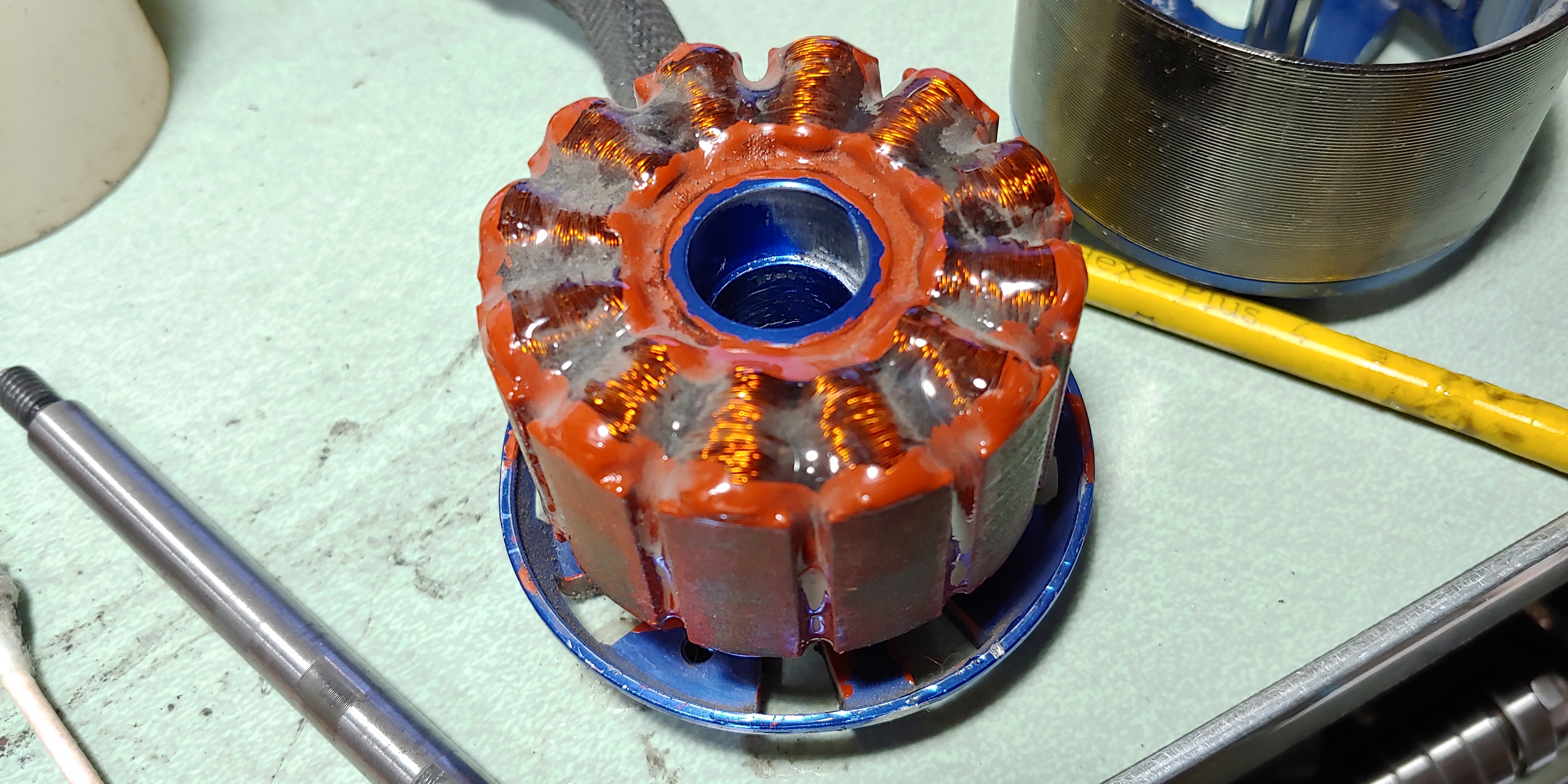

The right motor was having fits and trying to jam up and then go free again. I took it apart — and thankfully, there isn’t a loose magnet getting bound up, but it’s only a motor bearing about to shit the bed. Thankfully, I have replacements on-hand.
Might as well do a battle-hardening while it’s back on the bench…
I cleaned the rotor but the stator is still dirty.
what did you use to get the bearing out?
I used that yellow 4mm hex wrench next to it and a hammer
Since I was replacing them anyway, I didn’t care :rofl:
Turns out it didn’t dent it or anything though

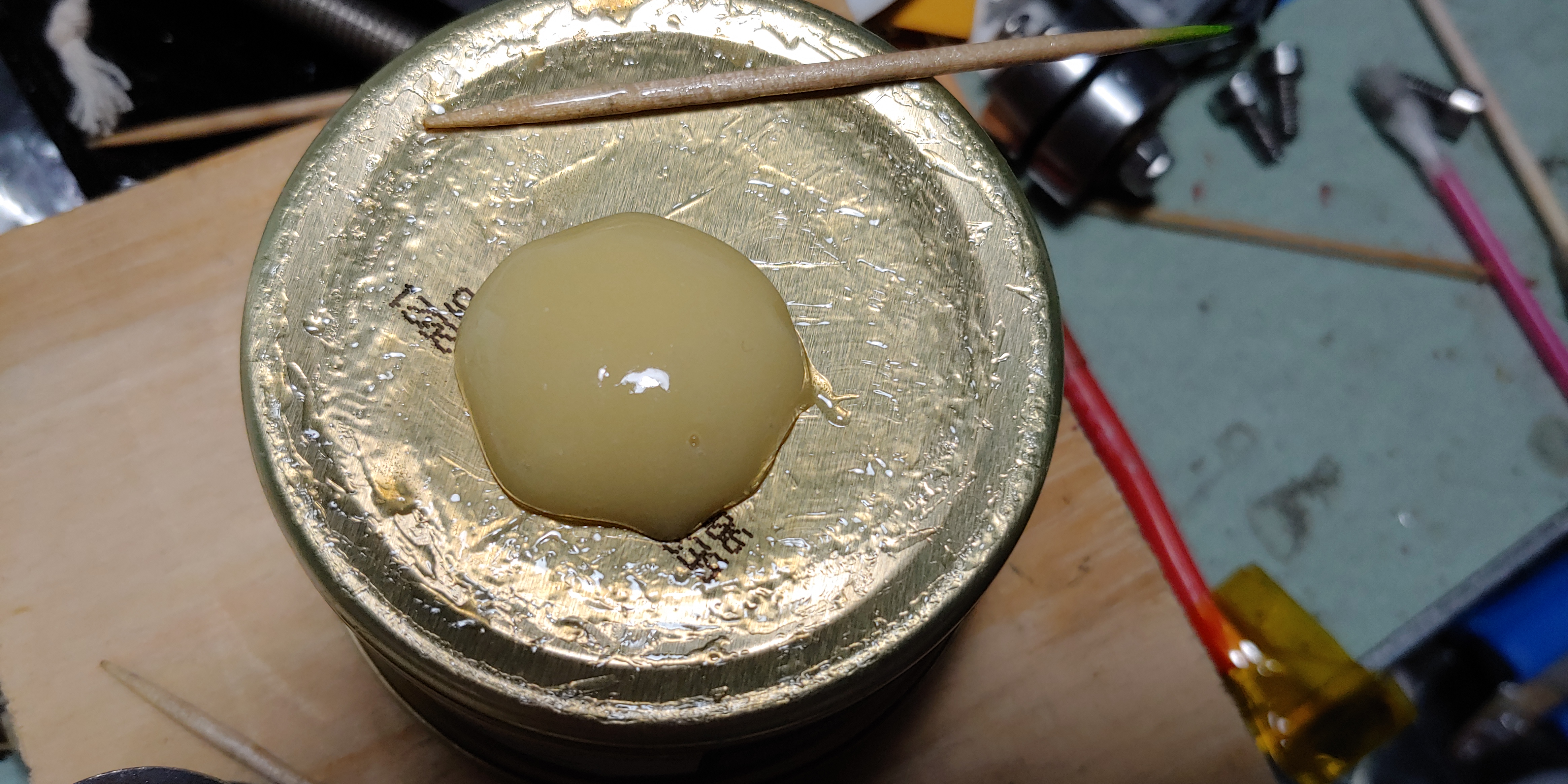

Not the best hardening job in the world, but better than the stock epoxy, I think.
