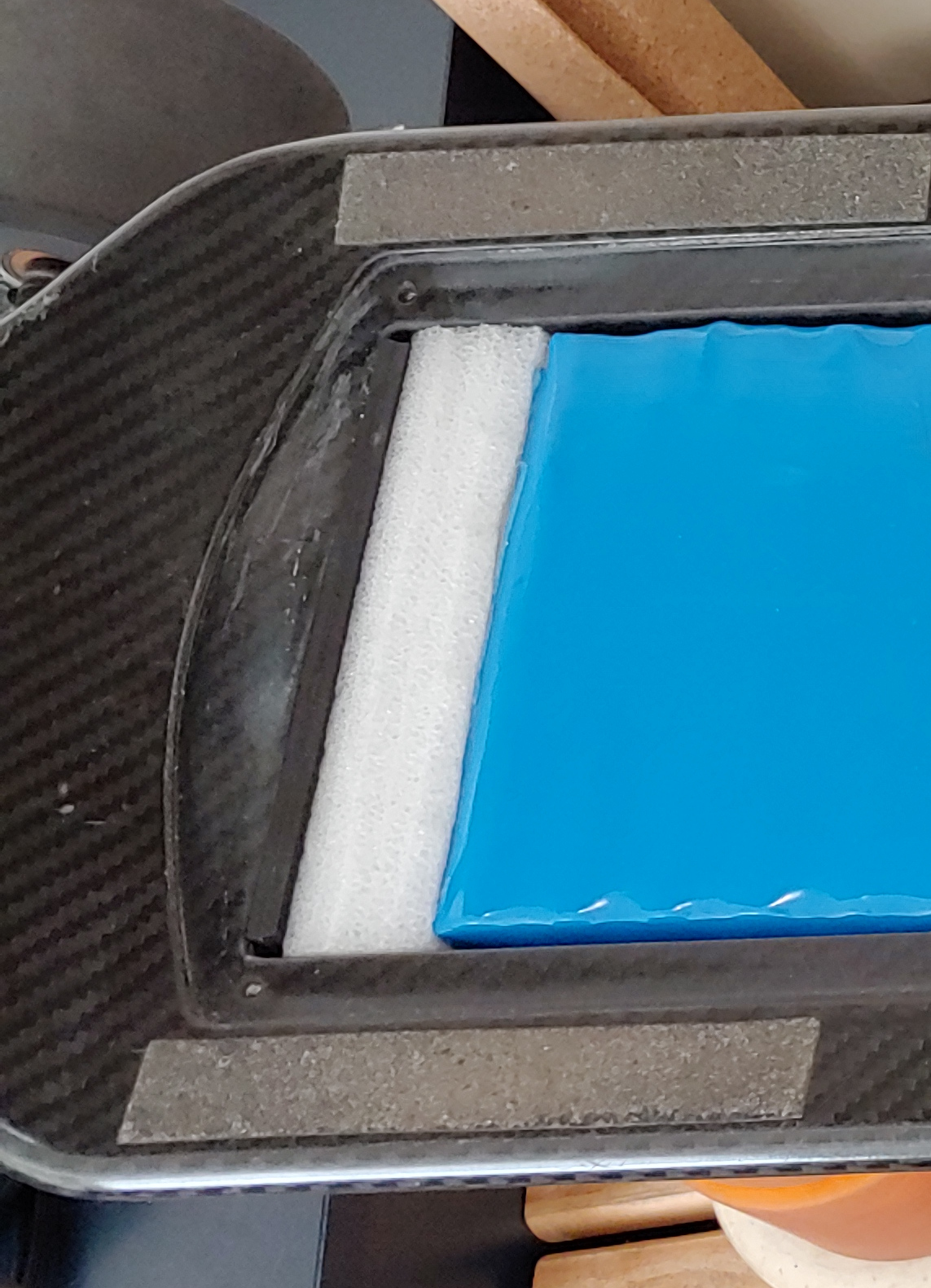

The inside compartment on this deck is not a nice shape. I’d go with a different choice. The compartment narrows in the front to where it isn’t even usable. See how there is 3.5cm of foam in front of the battery? That’s wasted space because it’s too narrow for 18650 cells. Also, the width of the space is so close to not fitting a battery that I had to construct the battery in that very specific way for it to fit, with the balance wires on the ends like @longhairedboy does his battery upgrades.
Overall, I can’t recommend this deck, but it’s what I had.

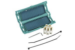

I saw on my local hw store a cable joint which uses a gel for water isolation:
Maybe this gel could be also well suited for our purposes. I don’t know what is made off neither if it is available to buy in retail though.
That gel is absolutely nasty stuff. Great for if someone does you wrong, then you put some of that gel under their car door handle.
Usually for waterproofing electrical connections, I solder them together, paint with acrylic, and while that’s still wet, shrink heatshrink tubing over it
Oh, I’m glad I asked :relaxed:
Tried to search for neutral cure silicone but it seems easier to find in the states than in europe. For example, GE 2+ doesn’t seem to be available. Also there are several types, metal, glass, etc.
Do you know any appropriate one available also in the EU?
Try ASI 388, although it’s an American company/product they might have it in stock.
It’s my fav silicone I’ve found so far :thinking::man_shrugging:t2:
