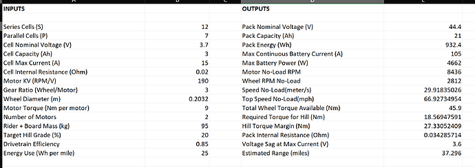

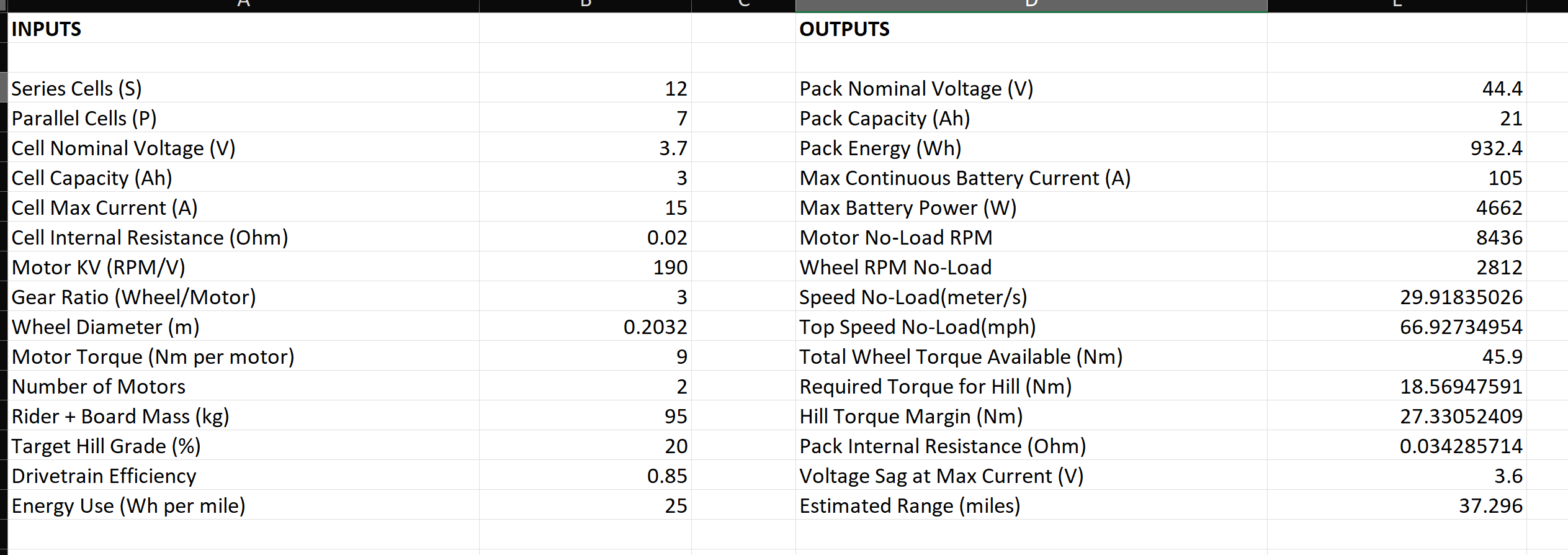

I am in the process of making my first DIY electric mountain board. I think I understand most of the build, but am super confused when it comes to what BMS to choose. I plan on running dual 6384 190kv motors, using a Go-FOC DV6s ESC, and am planning on making a 12s7p battery using samsung 18650 30Q cells. How should I go about choosing a BMS, any suggestions would help. also any anti-spark suggestions?
my nominal cell voltage is actually 3.6, not 3.7 sorry for the typo

Nominal is just a name, it’s not the actual cell voltage. Things saying “3.6V” or “3.7V” are all 4.2V cells, generally. Both of those work for 30Q cells, which are not the best cells you can get. This is mostly to differentiate them from LiFePO4 cells which might be named “3.2V” but are typically charged to around 3.65V. (not to be confusing or anything)

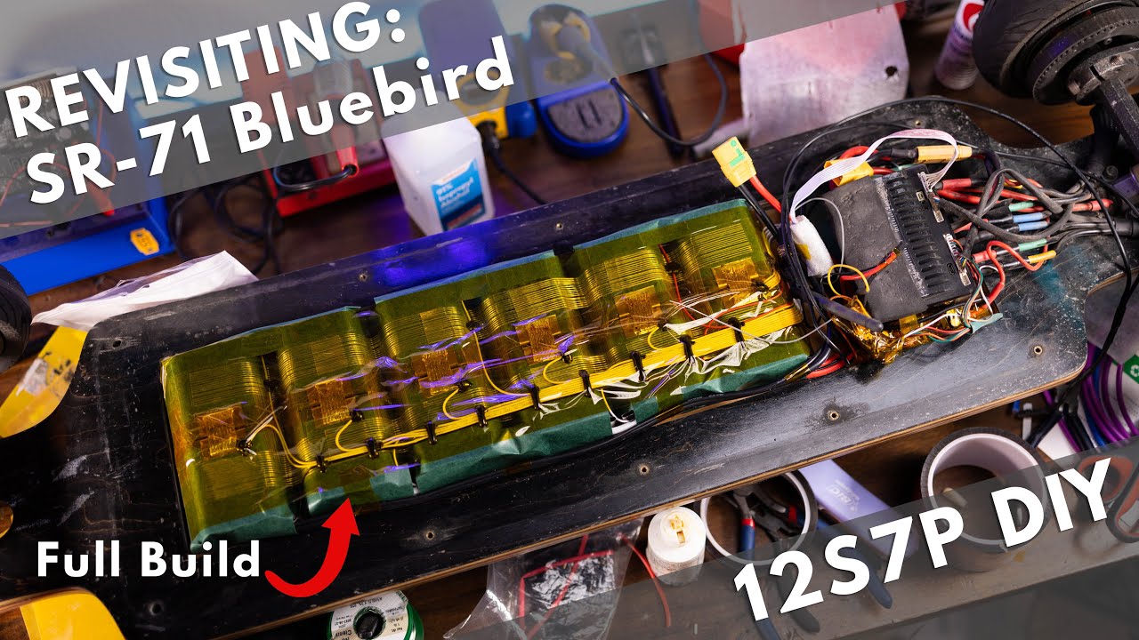

I found Shuttershocks’s videos to be a great watch when beginning to confront everything I did not even know that I did not know, about building an esk8 battery.
