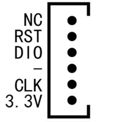

I need help with my bricked VESC
It’s a very simple PCB which does only have plugs for sensors, USB, and switch.
Someone mentioned that there is some pads to plug a ST-link in there but he never said where.
Could anyone help me with this?
I’d need reflashing this baby.
Cheers
They are marked SWD in your photo.
It’s not a true swd there is no clock pin.
Here is a swd pinout from a vesc.
20200620_214333_0000
Don’t try flashing the bootloader on these.
That not good. CLK is one of the 3 pins required to connect the ST link.
Looks like an Dual Controller from ESK8supply.
Best way is to ask themself their ESK8Supply Thread or via E-Mail at info@esk8supply.shop.
On inspection pin 3 appears to be clock pin once my new st-link gets here I will try connecting to it.
