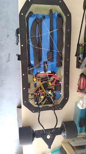

Does this count as short and clean? There is so much going on here but it fits and nothing moves. Lots of hot snot and tesa and adhesive shrinks
its like art you see something different every time you look at it :joy::joy:
I had it all nice and neat, then the bms had to move, so then the buck failed, then the replacement buck failed, then i stopped trying so hard lol
Also works like a magic eye, just squint and look past it
Hot glue, and anything resembling semi permanence, is something I have been avoiding inside my enclosure.
I have about 3 dozen low profile fiberglass leash loops on the inside of my enclosure, for.attachment points everywhere, and sacrifice small zip ties to hold wires where I want them, and so they can’t move or vibrate or chafe.
The battery is held down by a strand of paracord weaved back and forth.
This photo was my previous iteration I made it a bit cleaner the last go and this might look far different in a week.
