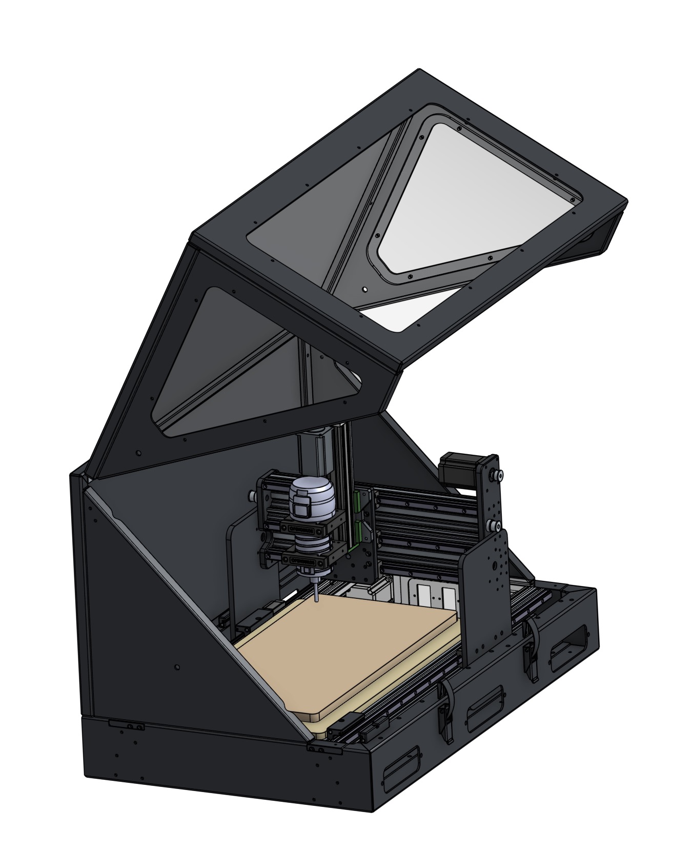

Kinda unrelated, but my buddy just designed and put together this machine for our non-profit. This will be used mostly for education. Almost fully custom except for the extrusions, ball screws, and linear rails from the queen-bee kit. Just wanted to share :slight_smile:
