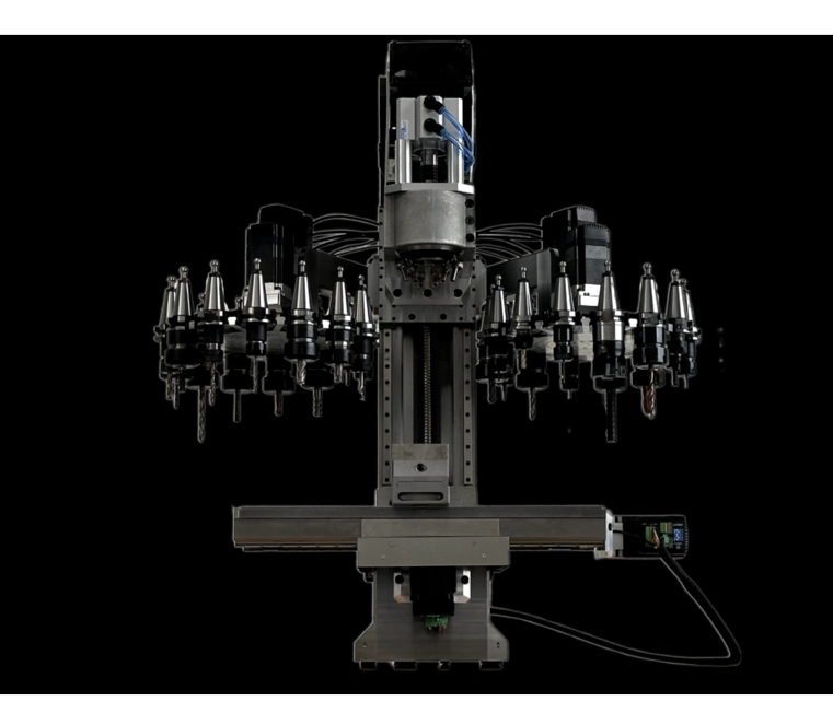

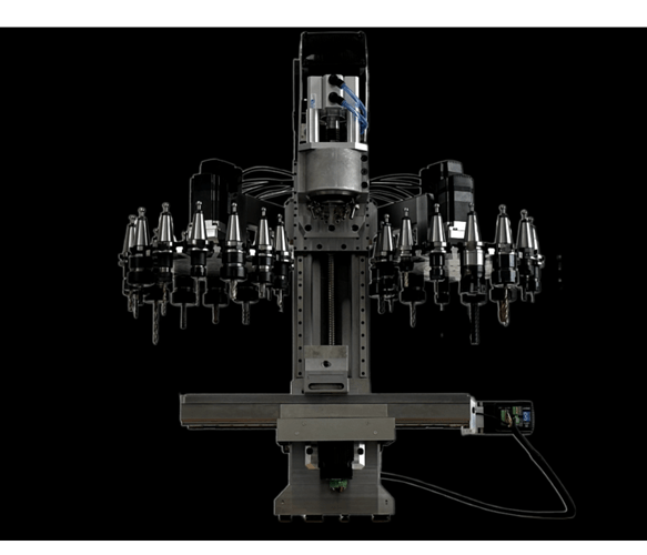

I’ve just found this machine. Looks killer for the price. What do you think? @Boardnamics @surfnacho
I’m thinking about getting it without the ATC (but it still has pneumatics for quick tool change) and upgrading to the ATC down the line.
I have seen ads for it. I find it a bit corny and rather unproven/undocumented.
Documentation and support is a huuuge deal when buying a machine. Something like that with virtually no long term users to vouch for it make me nervous.
