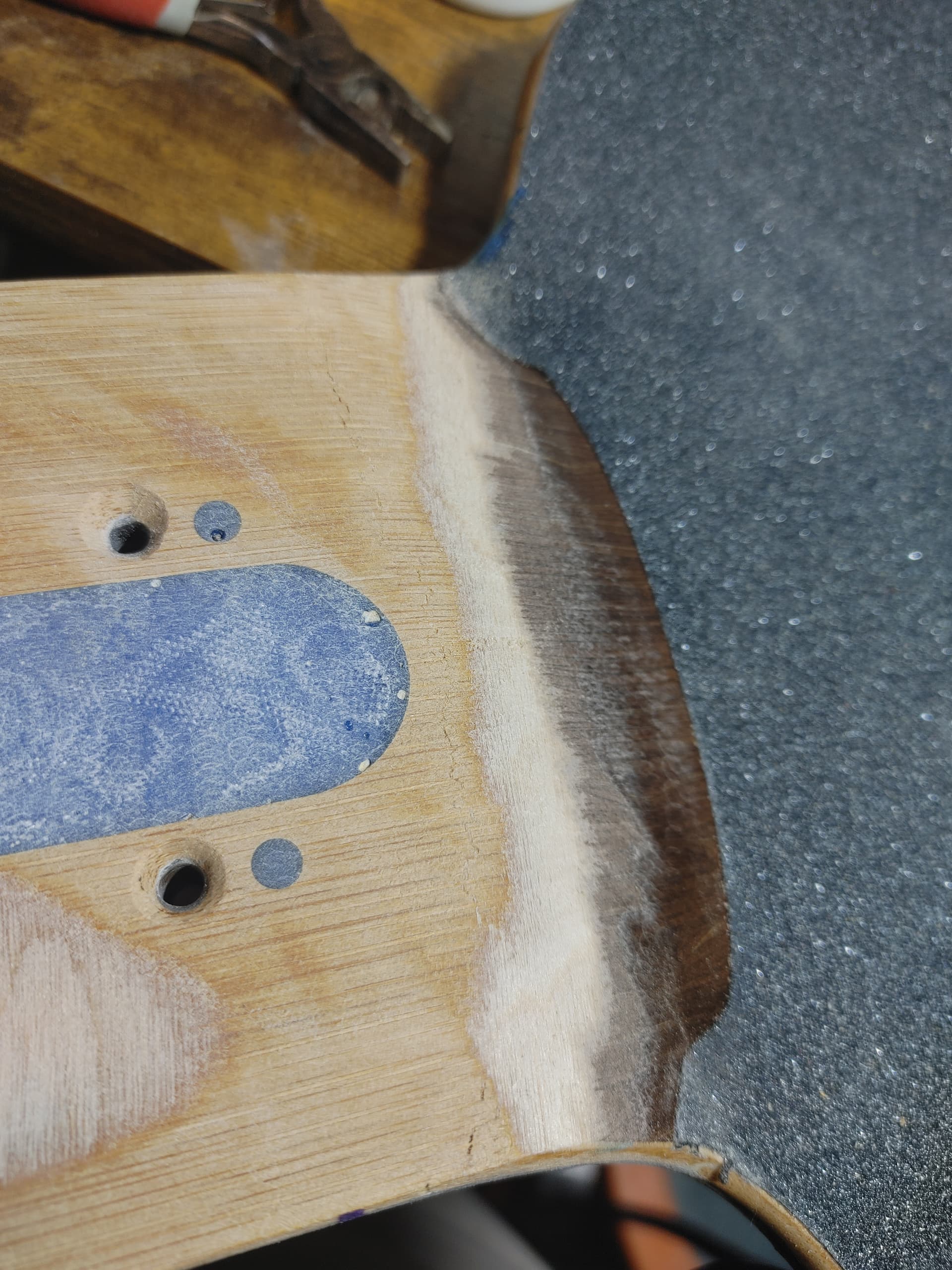

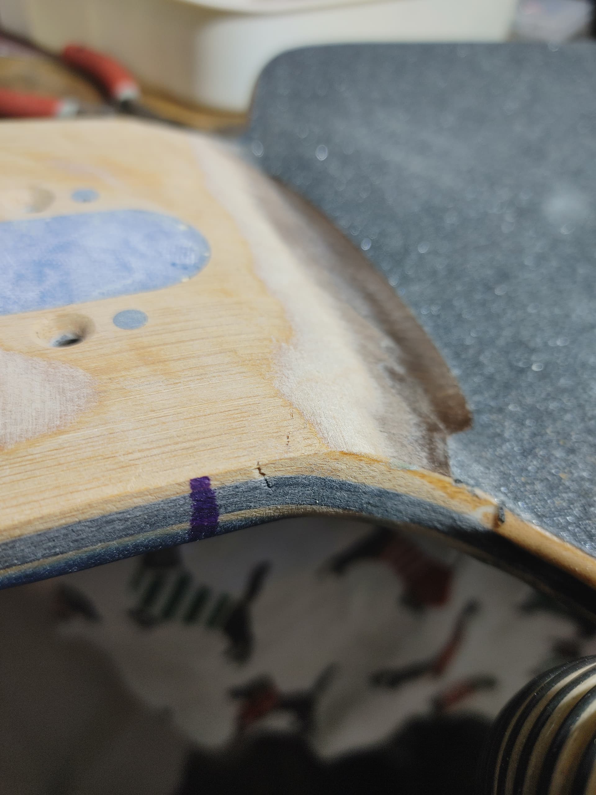

I know this is late, but I wouldnt trust their decks as is. The 2nd layer of wood has cracks at the deck’s weak point.

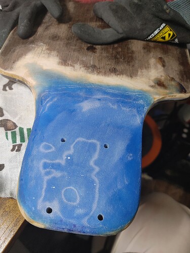

I didn’t buy a premade but did buy a Sportser deck. The only reason I noticed it is bc I wanted to add fiberglass reinforcment and lessen the drop on it.
I know the cracks look small but their decks having that when unused means they are already weaker than they should be.
I’ve never used it and nothing I’ve done could cause a crack. I’ve only added fiberglass and epoxy to fill the hole and to add strength.
I’m really glad I didn’t just buy longer bolts and risers to negate the drop bc this isn’t safe for esk8 use due to location of the crack
Edit: to be clear the hole being filled doesn’t add that nuch strength. I just do it to help grip tape lie flat. The reinforcement is on the under side
there are at least 6+ layers of fiberglass there but likely more. I lost count and just kept adding more to use up the epoxy I mixed up.
The epoxy is blue bc this deck will eventually be used for my 2nd board that is my blue board. Plus adding mica based pigments wont weaken the epoxy. Only adding too much liquid pigments can weaken it and cause longer cure times if it is water based

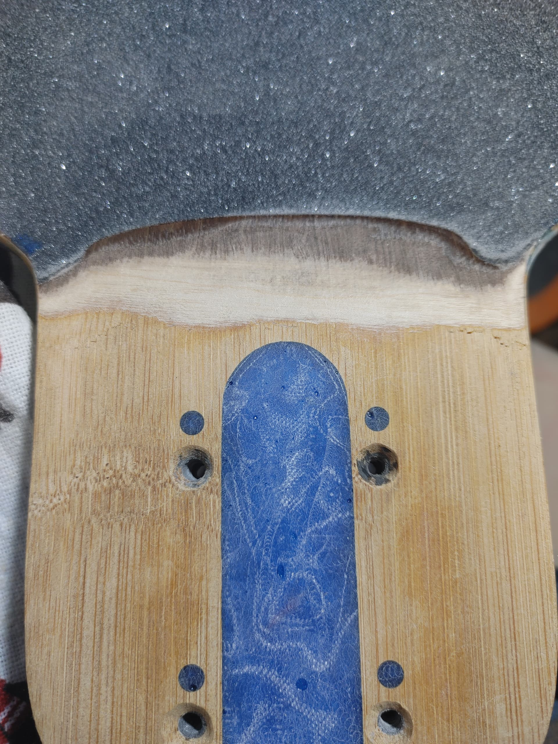

I contaced them about this severe safety issue two months ago. A month ago I reached out again and used the BBB site to try and get help. No reply to either method
They also blatantly lie about the deck composition aa seen here. The decks are made only of wood. There is NO fiberglass layer at all.
They are not only knowingly lying about deck composition but also are okat with cracking two or more layers of wood. I didn’t sand further but I wouldn’t be surpises if more layers come broken. This is not acceptable and their lack of response is damning. Don’t risk buying anything they make.
