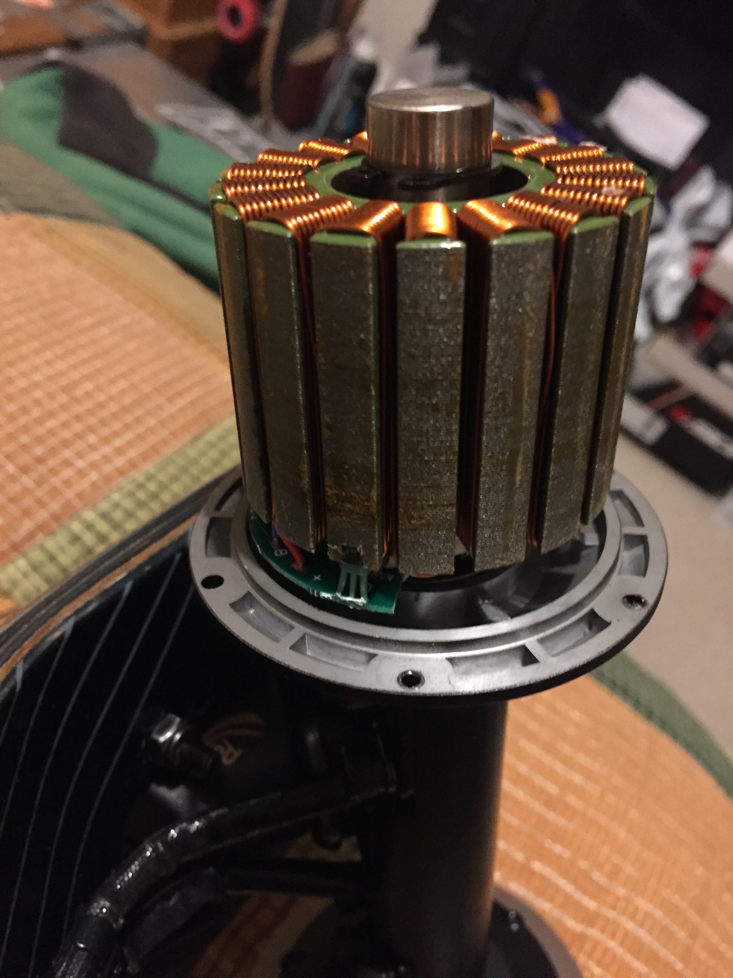

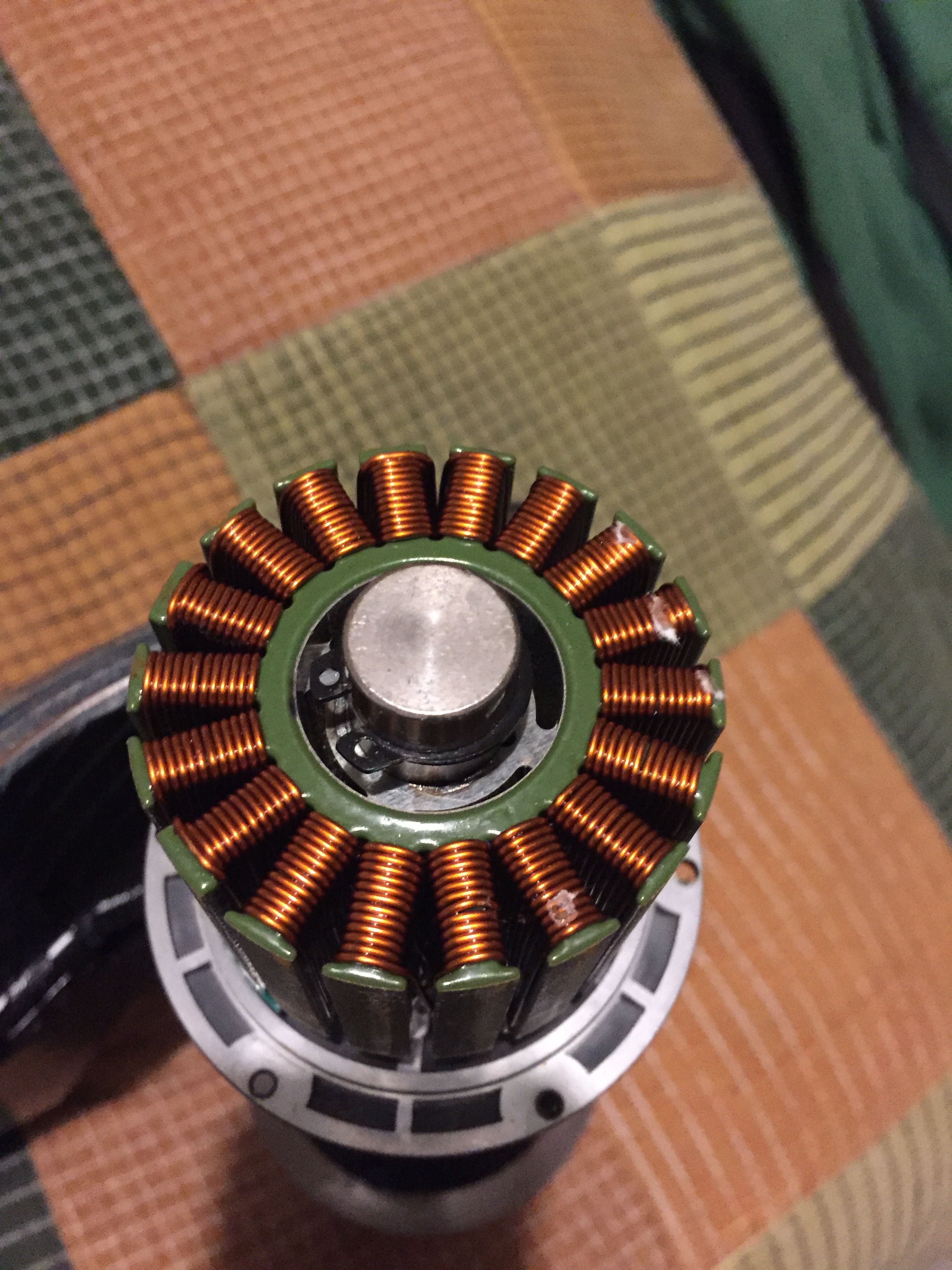

Here’s the motor pics

It’s neat but empty. Bet if u rewound it u could get like 25% more copper in the slot which would equate up like 23% better motor. And there’s tons of room for the end turns so u could do the whoop ass LRK winding.
@Fozworth69 thanks. 18 teeth. Can u please show the rotor too?
If u spin it on the bldc tool u can get the phase resistance and inductance and then we’d know how much torque to heat it produces and we can compare to any other electric motor
U know the dimensions?
http://www.bavaria-direct.co.za/scheme/calculator/
It has more cogging steps than the standard 12n14p so less cogging torque n easier roll but lower winding factor so bit less efficient w that combo
The pics are of the LRK winding. (Be same numbers either way)
Oo I take that back and the super typical DLRK winding is a lower winding factor than the LRK w every other tooth wound. And for sure u can get more copper in w LRK.
Weird that the 12n14p is different winding factor (kinda the magnetic circuit efficiency) w the lrk and also dlrk.

Wow, really neat construction, single strand wires, really well done windings, but it appears that we could fit a bit more copper :grin:
It’s the only single strand winding I’ve seen done on this forum.
The copper volume almost decides the power ability and efficiency when it comes to the motors we use.
that motor and all the end turn space is dying to be rewound lrk w massively bulbous copper mounds. a fat ass of copper. Way sexier
Act now
If u Record the resistance and inductance and send it to me I’d rewind it for the challenge to see how much better I could make it. (U get whatever kv it ends up but I’d shoot for the same)
