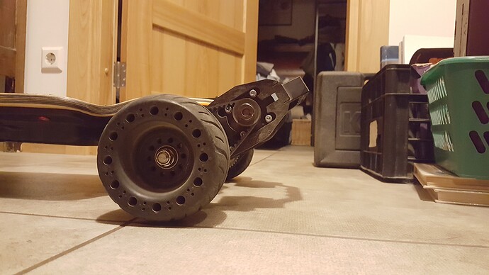

Drivetrain issues
  • On these mounts you adjust the belt tension using an idler. But this means the other side of the belt can be loose and skip. So I drilled new holes and had Kevin send me some extra idlers. No more skipping :slight_smile:
  • These mounts hold their angle using friction. They can slide down until the bolts hit the end of the clamp gap. To solve this I drilled new holes in the mounts for new bolts that would already sit at the end of this gap. Now the mounts stay fixed in place. (As you can see though, motor clearance isn’t the best. Motors get smashed going up and down curbs :confused: )
  • One of the motors had a faulty temperature sensor. It would occasionally report over 300 degrees C and then that motor would refuse to work. I have a TODO item to add a toggle in vesc tool to ignore temperature sensors, but in the meantime I just unplugged that wire.
  • My little brother was starting to grow tall and big, and these hangers were not going to survive in the long run. They were bending.

Version 2 - TB Direct Drives
I bought a steel Radium hanger for TB direct drives that I had. That + a duck handle should solve the issue with carrying the thing. Front uses a BN220 hanger.
I did a 3-way wheel swap with @Rudi and @RDs to get my hands on some Onsra 115mm rubber airless wheels. (They’re really comfy.) Now this build will really be rideable in the rain + my brother didn’t want pneumatics. Nor could we do that without running into wheelbite issues.

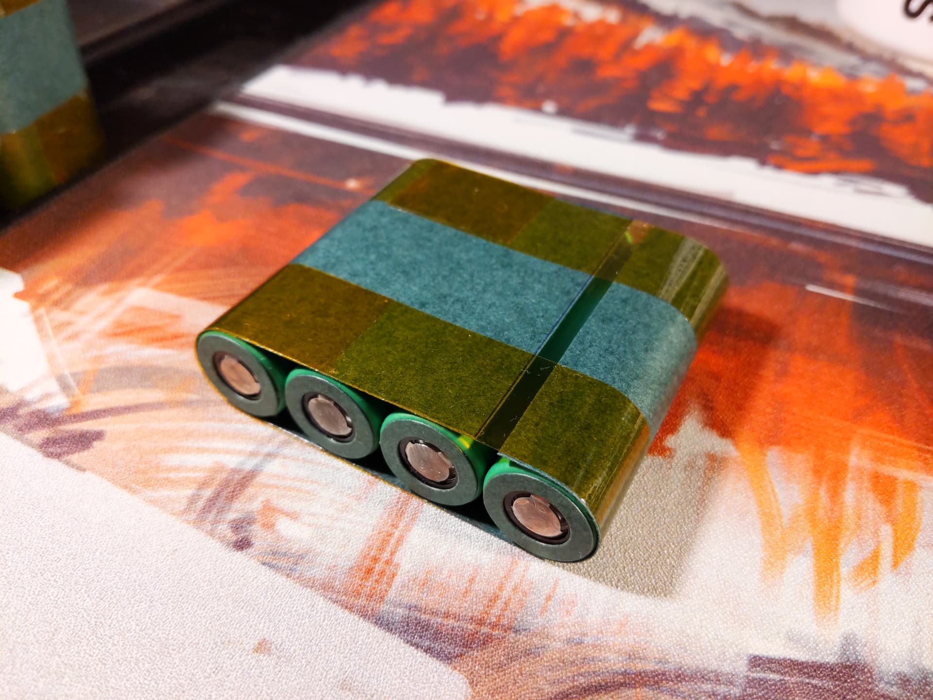

But most importantly – I had to build a new battery. With the buttons in the front, and the back full of electronics, I did not have space for a 12s P42A battery. I could have gone 10s, but I was transitioning my entire board fleet to 12s so that my family didn’t have to pay attention to what chargers we use. So I got busy playing li-ion cell jenga, and I came up with the following layout:
12s4p with 18650 cells :sunglasses: This will let me put the enclosure on with butyl tape since no thick gasket will be required. I ordered reclaimed VTC6 cells for cheap, dremelled leftover welds from them, and built the thing:
I’m using an LLT BMS from Apex so that I can monitor the cell voltages / diagnose battery problems. Must have for any board that’s made water-tight with butyl tape, since taking that off SUCKS. Also you’ll notice that I have closed-cell neopreme foam around the battery modules, and beneath them. This is to prevent them from sliding around, and adds another layer of protection. Took a while, but it’s nice :slight_smile:

My friend rode the board to a group ride. Seemed alright, although we ran out of battery at the end. Then I rode it once to test something, and it was a pretty rainy day, and I was still using the jank neopreme foam as the only gasket.
The board thermal throttled on me in 3 minutes time. Later in the city, one motor completely refused to work. I thought I had killed something with water damage, but it turns out the ESC just forgot its motor config. Nice. Also there definitely was a bit of muddy water on the inside when I opened it. Luckily the kapton over the battery caught most of it.
I don’t know what’s up with these drives, but they’ve been nothing but a headache for me since I bought them. I’ll be putting them up for sale later, but for now I knew one thing – I needed another drivetrain swap. Also the VX1 Pro cut out on me on the next ride (had no signal for a whole 5 seconds), so I don’t trust that thing either. Also up for sale soon.
