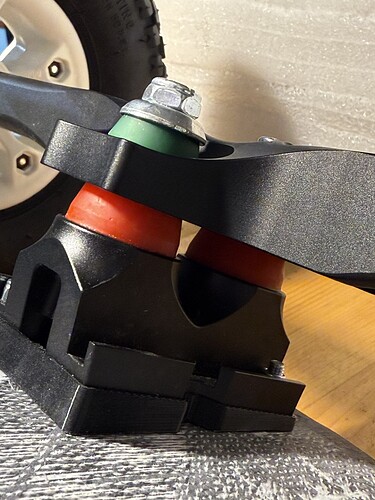

I replaced some bushings with whatever I had lying around. Durometer mostly unknown, but significantly softer. The softer ones at the front.
A completely different riding feel. It’s been done. Tight carving / rail-to-rail with decent lean and counterpressure, but still easily controllable at 38 km/h. If I push in again during the turn, I can make the tail drift slightly. Real street surfing.
I think it could be even better or more defined.

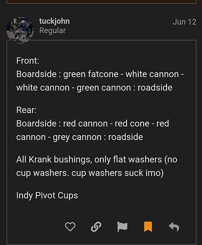

I’ve now found two completely different setups in the forum:
Stuff about double kingpin trucks - #45 by RipTideSports?
and completely different:
Tynee Explorer Discussion - #115 by tuckjohn?
What would you recommend?

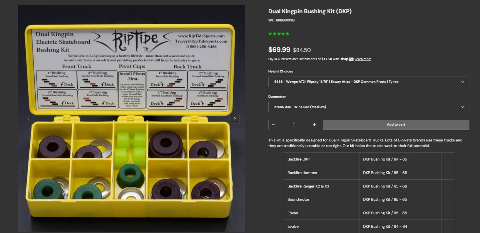

I recommend our kit in KranK 93a found here: Dual Kingpin Truck Kit – RipTide Sports, Inc.
Configure the order as shown in this screenshot:
The web picture needs to be changed to reflect all the bushings in the kits are the same color and duro.
Thank you very much! Unfortunately, I can’t find the 6666 set for Wowgo, Tynee, etc. here in Europe. The link to the ‘retail shops’ on your site seems to be down at the moment. Does the 6666 box contain 8x 93a cannon bushings? If so, I would order them individually along with the pivot cups.
Cheaper to buy just direct from us then, our website will calculate shipping for you. It is much more expensive to buy the components and there is only one FatCone and 1 Chubby in the kit and no one sells them individually.
Sorry, but your shipping policies prevent me from ordering to Europe. There you refer to the retail stores yourself (broken link).
Please send me an email and we will sort this out. We ship to Europe almost daily. brad@riptidesports.com
