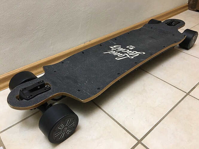

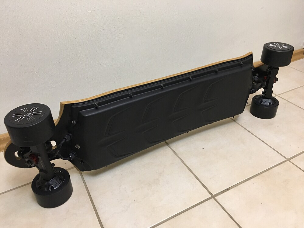

@RipTideSports Im looking for a bushing upgrade for my 4wd meepo.
Pictures
  1. Meepo v3 shredder hub motor trucks (50 degrees). The outside of the wheels are 280mm apart.
    They came with cylindrical 25mm x 19mm 100a bushings. No washer boardside. Cupped washer roadside.
  2. /
  3. The current bushings just don’t feel that great. I played around with different washers and tightness but even tough they are 100a they still are not very stable in the middle.
    I want high rebound that stays centered and is stable at speed up to 60km/h
  4. I like to ride straight with fast acceleration and breaking. I don’t care that much about turning circle and carving.
  5. Im using a landyachtz switchblade 40". The trucks are mounted drop through with 100mm sleeves and maybe 105mm sleeves in the future so the wheels are somewhat close to the deck but no wheel bite so far.
  6. 65kg
Since the old bushings are 25mm x 19mm does that mean I need tall canon? I cant even find tall canon bushings anywhere ^^
Changing from 19mm to 15mm high bushings would decrease truck angle that would be good for stability but im not sure if its okay when the bushing is not perfectly parallel.
What bushings would you recommend?
Thanks for your help.

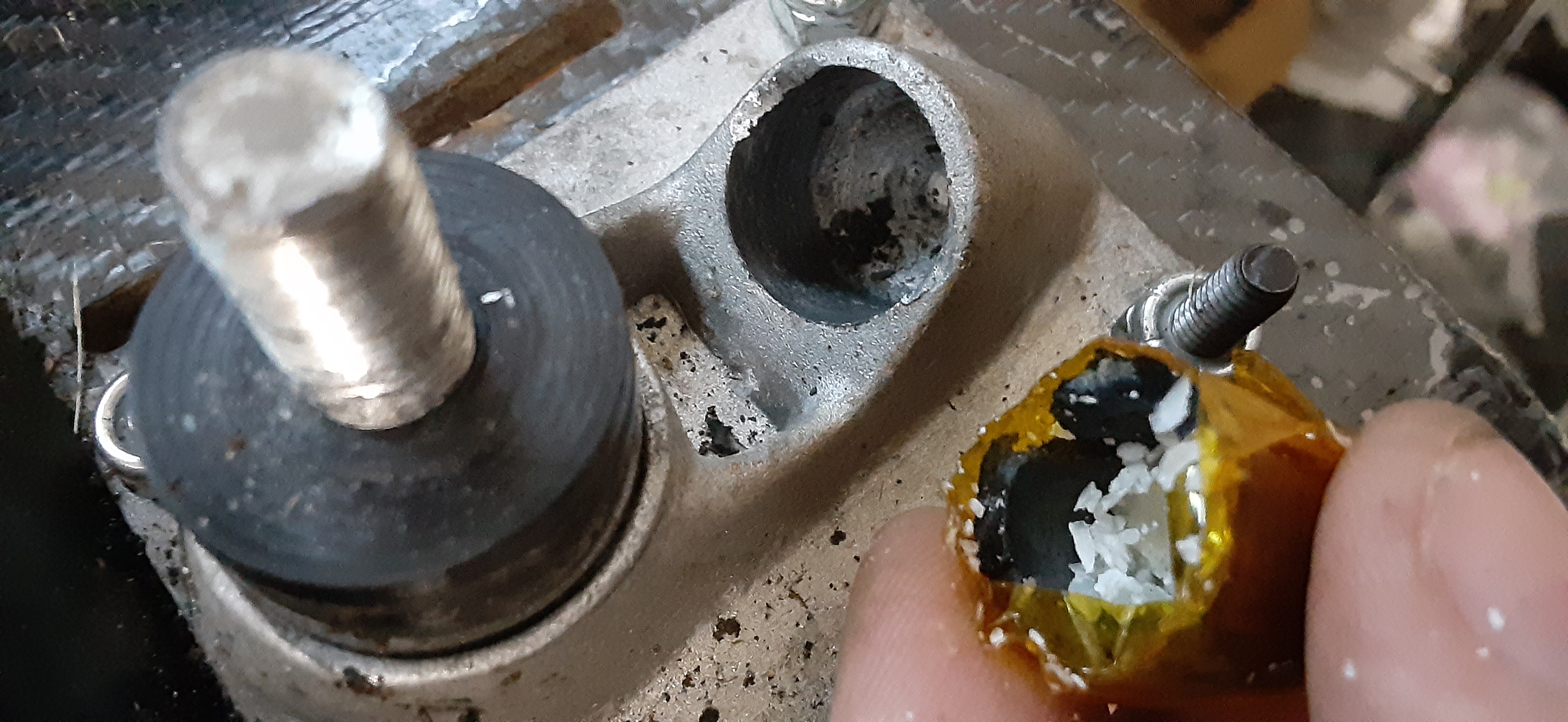

Oh I wanted to ask what people thought the best material to stuff into a pivot cup with a hole in it but I figured out the best answer was wax…
Kapton tape around the outside, shaved parafin wax inside

50 degree truck are designed to turn, not go straight fast. In addition they have low leverage over the bushings so I am surprised that 100a bushings to not feel at tight as hell. Our Tall series are 19mm tall so I would go with that series. Are both bushings in the truck 19m tall? Also, what do you mean by “The trucks are mounted drop through with 100mm sleeves”?
