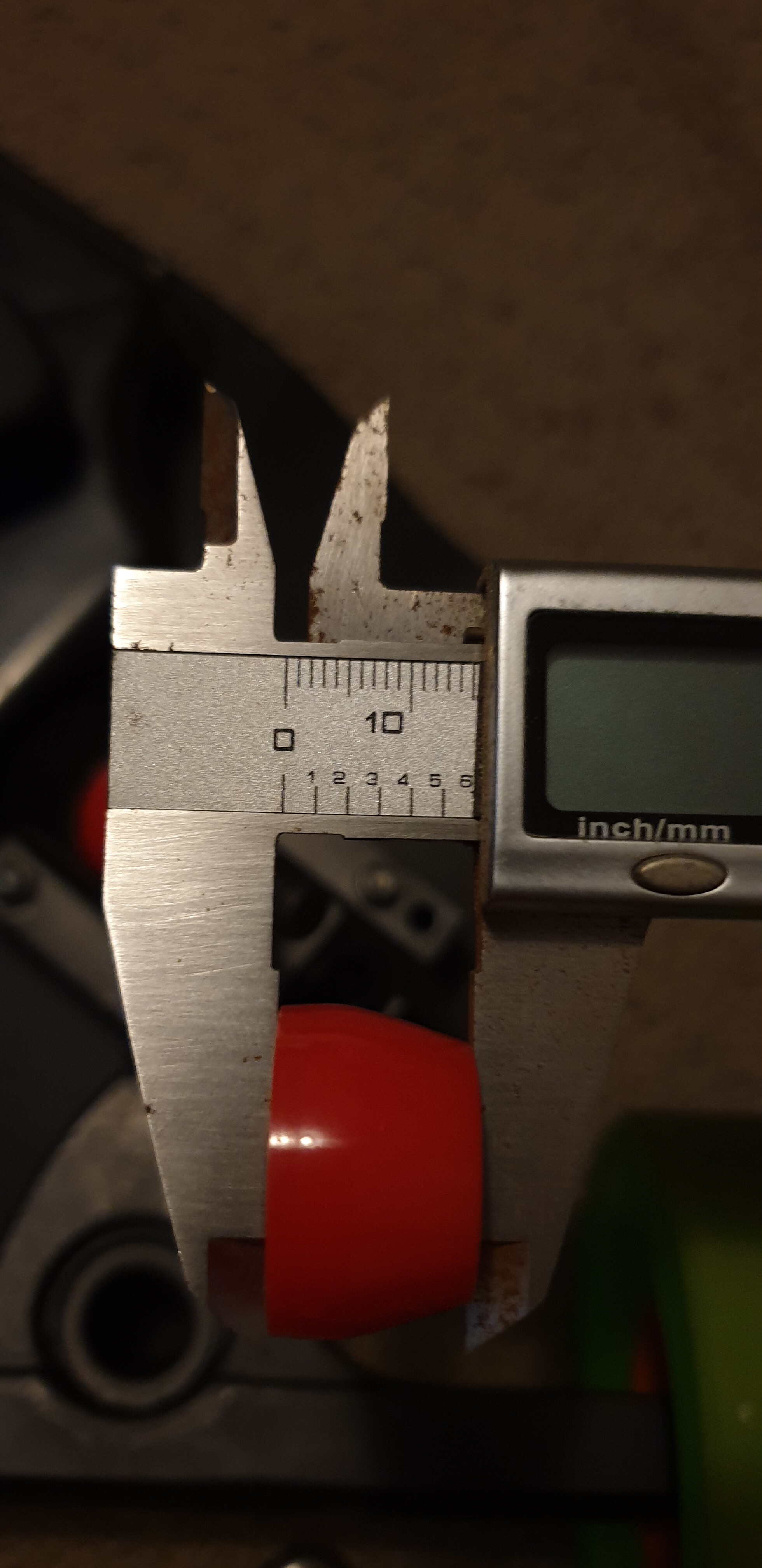

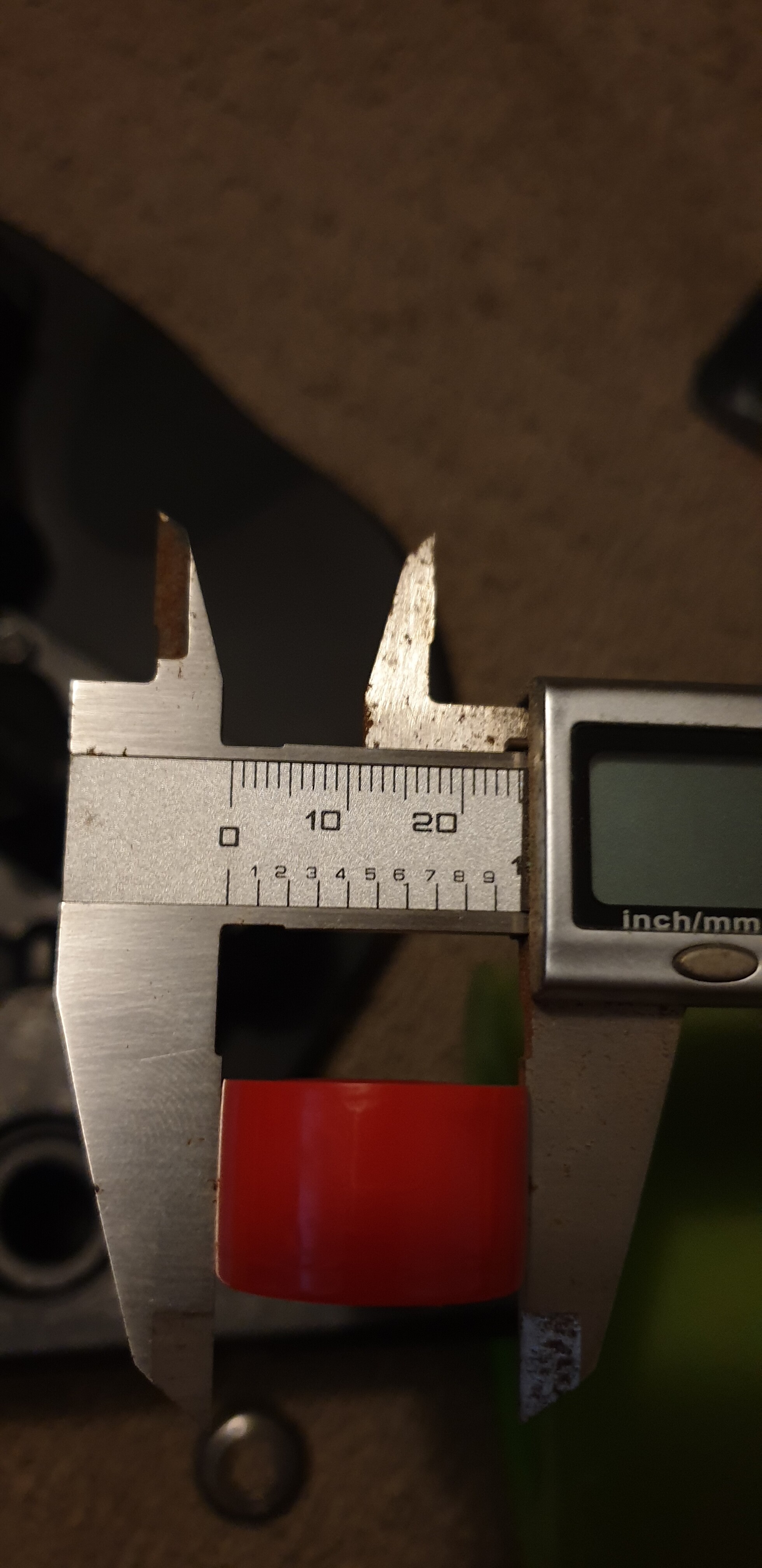

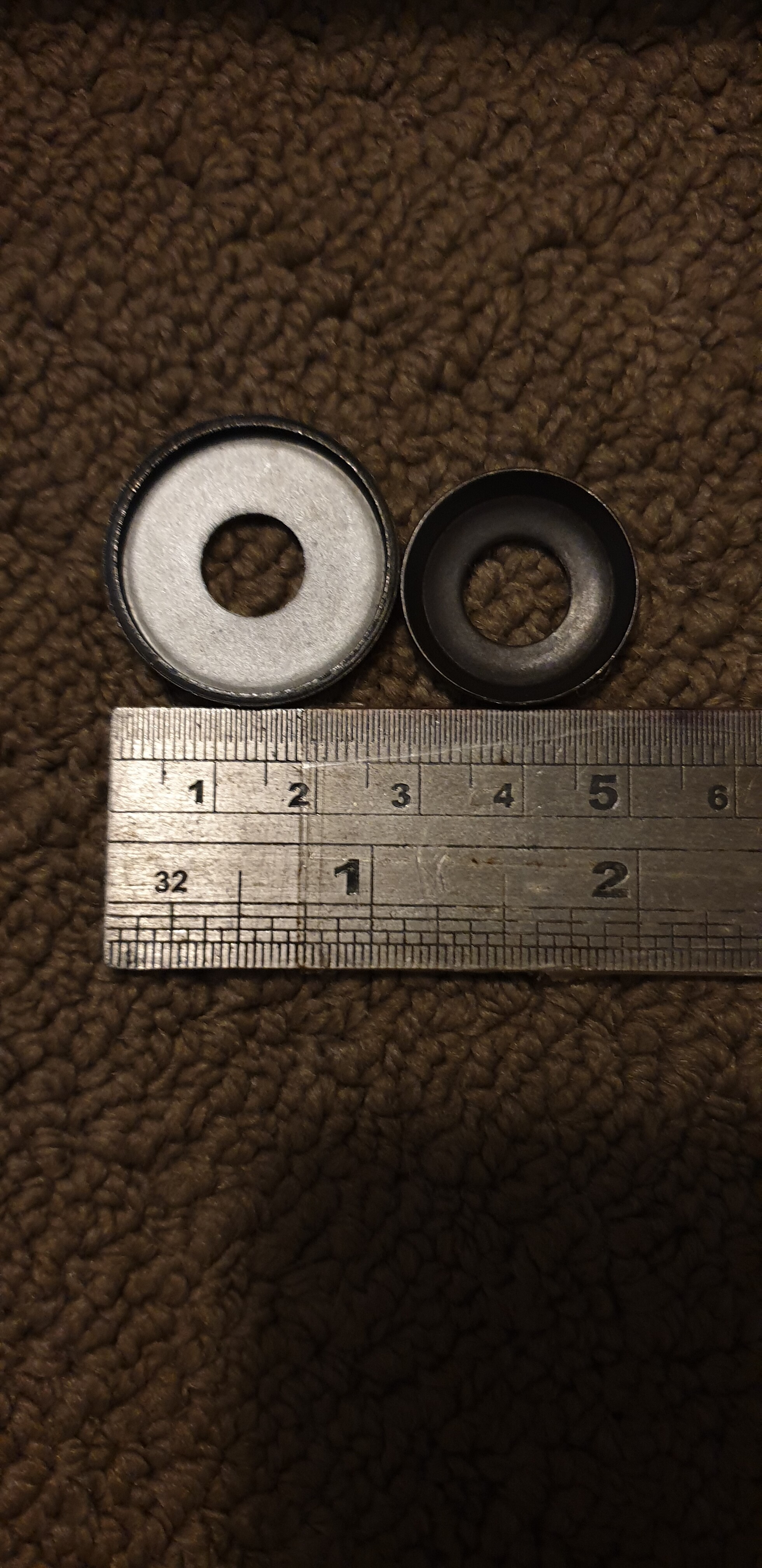

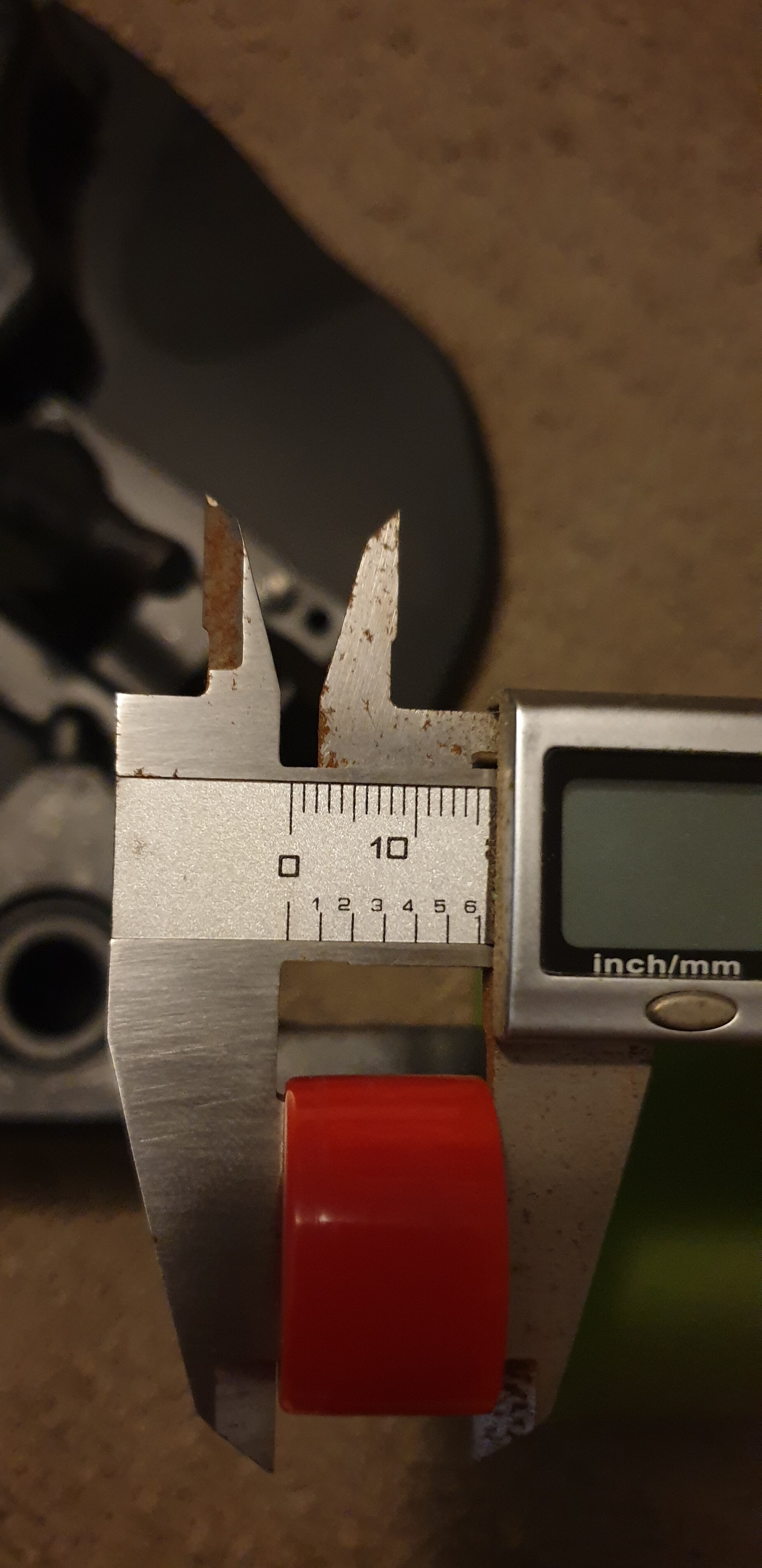

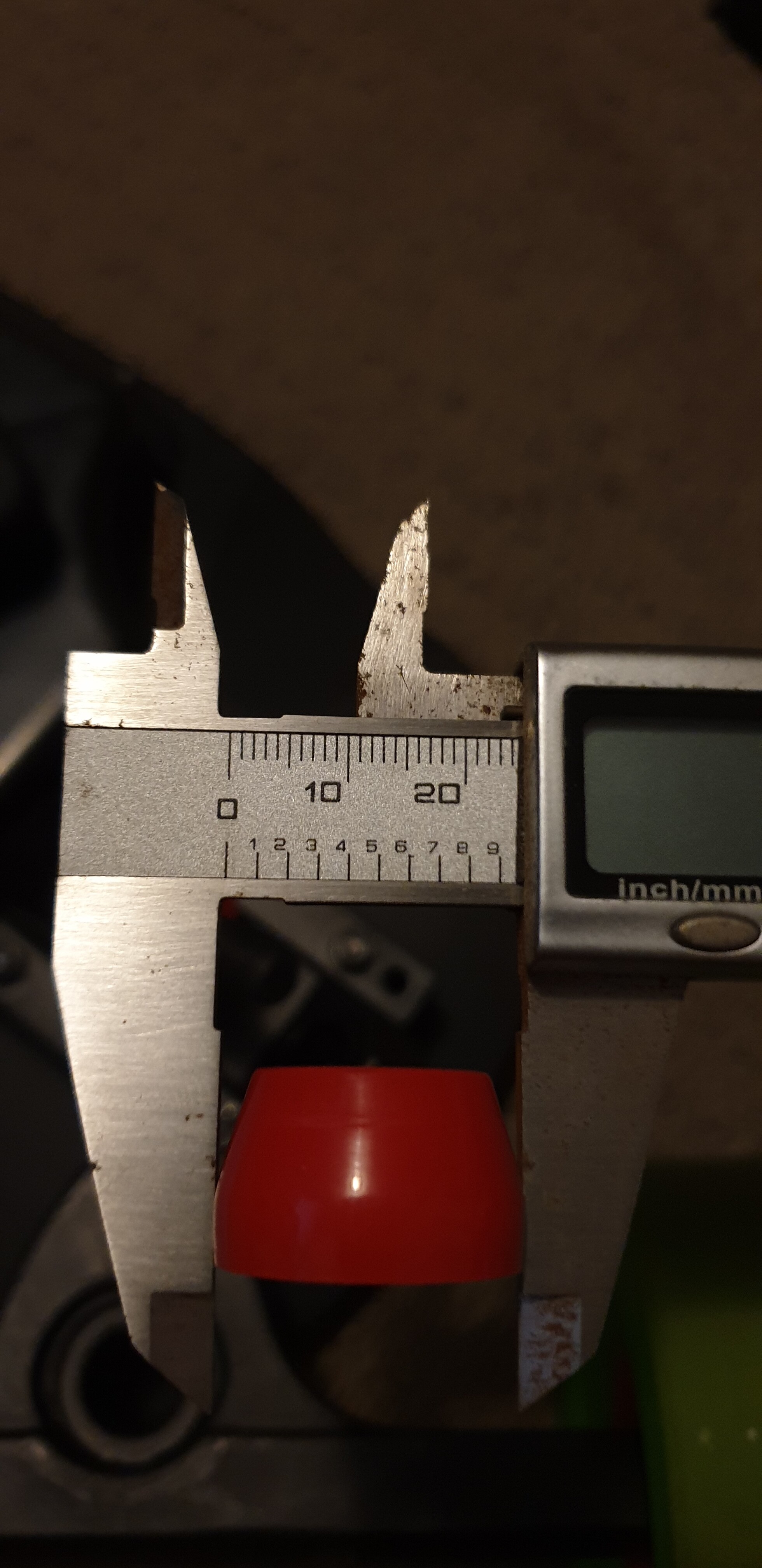

Hi Brad @RipTideSports,
I have a BKB single with the 31" Tayto deck.
Caliber II clones 50 Degree both front and rear. 10” wide but the gap between the rear wheels is 1/8 wider than standard due to spacing for the motor.
Running 107mm ABEC11 74a superflys with 1/2" risers.
Bushings are 86A, shape and dimensions as below:
Washers:
I find I have to crank the trucks up pretty tight to stop speed wobbles, at the expense of turning ability. The straight line stability in particular is terrible - the trucks seem to have a lot of ‘play’ when centred and I have to make them pretty tight to get rid of that. I guess I want what everyone wants - stability at speed but be able to learn the board over for nice smooth carving, and tighter turning arc at low speed. I weigh 70kg.
Appreciate your advice on any component change to achieve this. Bushings, washers, pivot cup etc.
Cheers.
Try using both barrels in the back and the cones up front to start with
