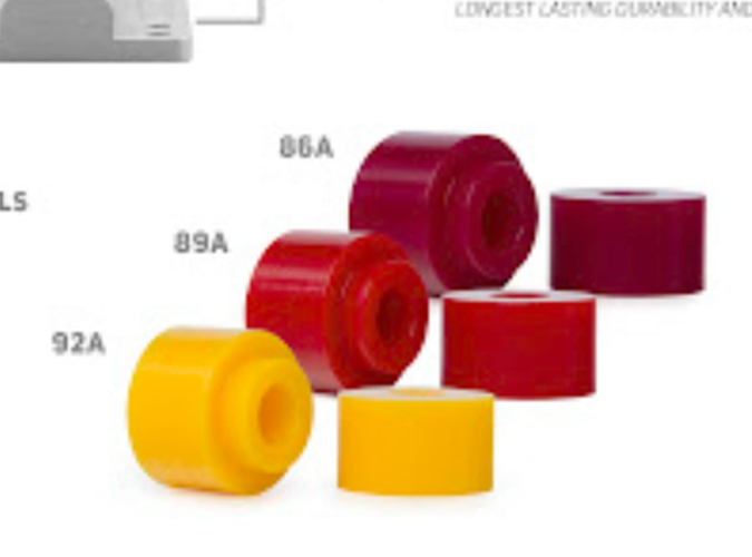

I want a similar bushing as the one found in caliber 2 trucks. This one just in red:

Are you referring to an insert bushing, one that is the diameter of a Barrel but has a detail than fills the space in the hanger?
Yes exactly.
The stock caliber 2 trucks come with this set of bushings (i have the middle ones)
the problem is that i have more trucks/hangers than i have bushings.
I could use the spare cheapo Chinese bushings that came with my board but I’m used to the caliber ones so i want to recreate that feel.
We do not make that style of bushings for several reasons
A shame! I like that setup. (to be fair, that’s the only setup I’ve used apart from the first 3 months)
I am not really sure of the functionality of the insert, if the bushing fits the kingpin and the bushing seat, there is no slop.

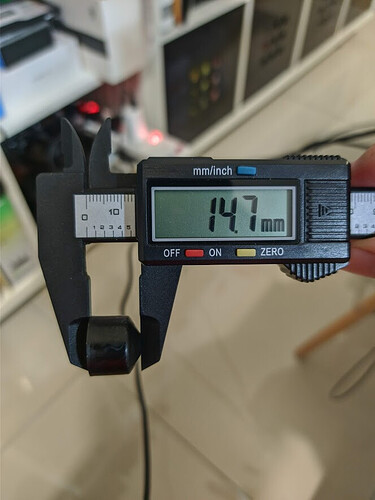

@RipTideSports Hey Brad, i noticed there’s no pivot cups options for the Exway Trist trucks (which am not surprised) but I am wondering if the other brands one will fit, I’ve included some measurements below :+1:
Our Kodiak Pivots fit the Trist Trucks
