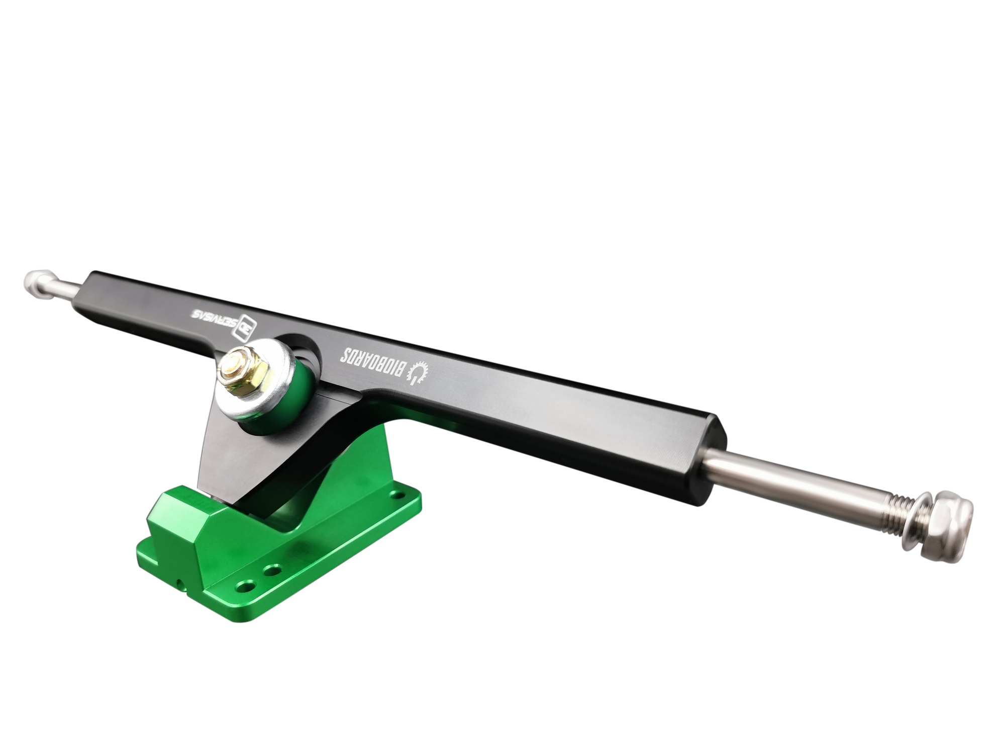

Try to duplicate the Bioboards Thorium approach and sell the Surf-Rodz trucks
@GlitterSpitter what @RipTideSports is trying to say is ehhhh get you some Fatboyssss.

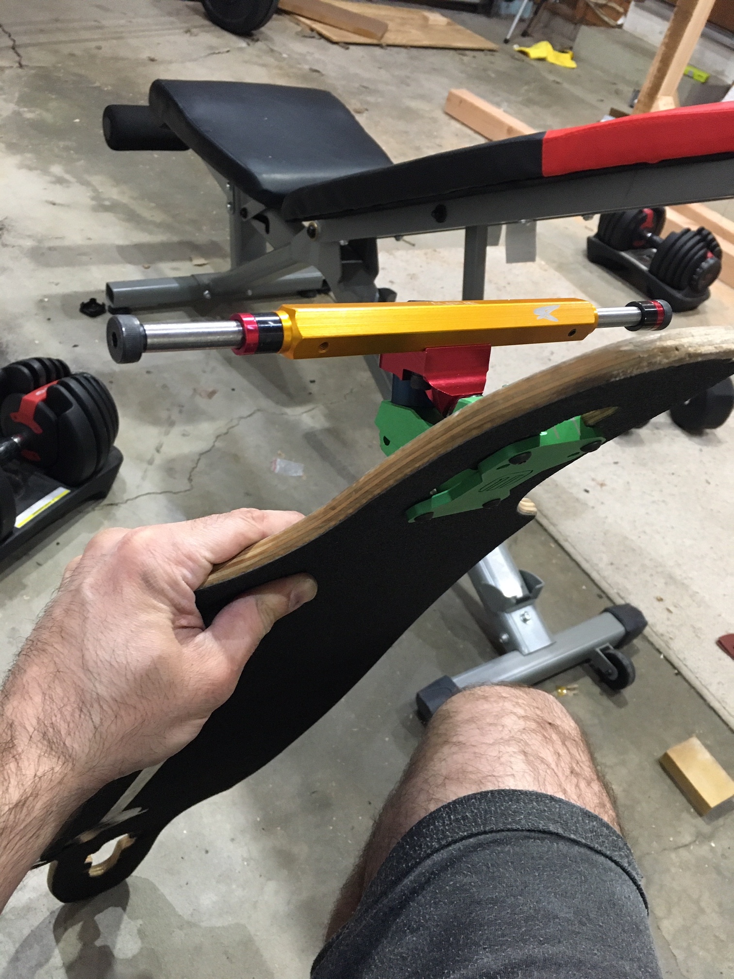

@RipTideSports Brad, I’m doing a really nonsensicle thing…for science reasons…I’m using SR TKP Adjustable baseplates (hammocks) drop through through a bustin’ maestro.
How would set up the angles for the most stability at high speeds…I know, it’s a slalom set-up, but plz, entertain this non-sense =/ FOR SCIENCE
Bushing/pivot cup/washer combo recommendation welcome as well =)
