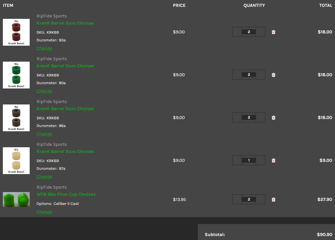

I’m sure for the higher speed setup it will be high duro kranks like my current boardnamics trucks, I was just not 100% sure what to pick out on the website given Kahua trucks are not in the list. Would really like to just pay for a personalised invoice haha. I’m good at buying the wrong stuff.
Oh yeah, what type of pivot cups.
It’s been said by Timo that cal II style are best for Kahua. So WFB 96A Cal II.
That aside… if you plan on being in esk8 for a bit, bushing aren’t very expensive in the grand scheme of things for experimenting…
Just buy, all Krank barrels:
2x 96A, 4x 93A, 4x 90A, 2x/4x 87A & be happy

$100 in bushings is about all I can handle for a little while, this seems like a good selection to get started with.

I placed order #19417 btw, should it be modified?
I suggest changing to Canons and trading one of the 96’s for a second of the 87
