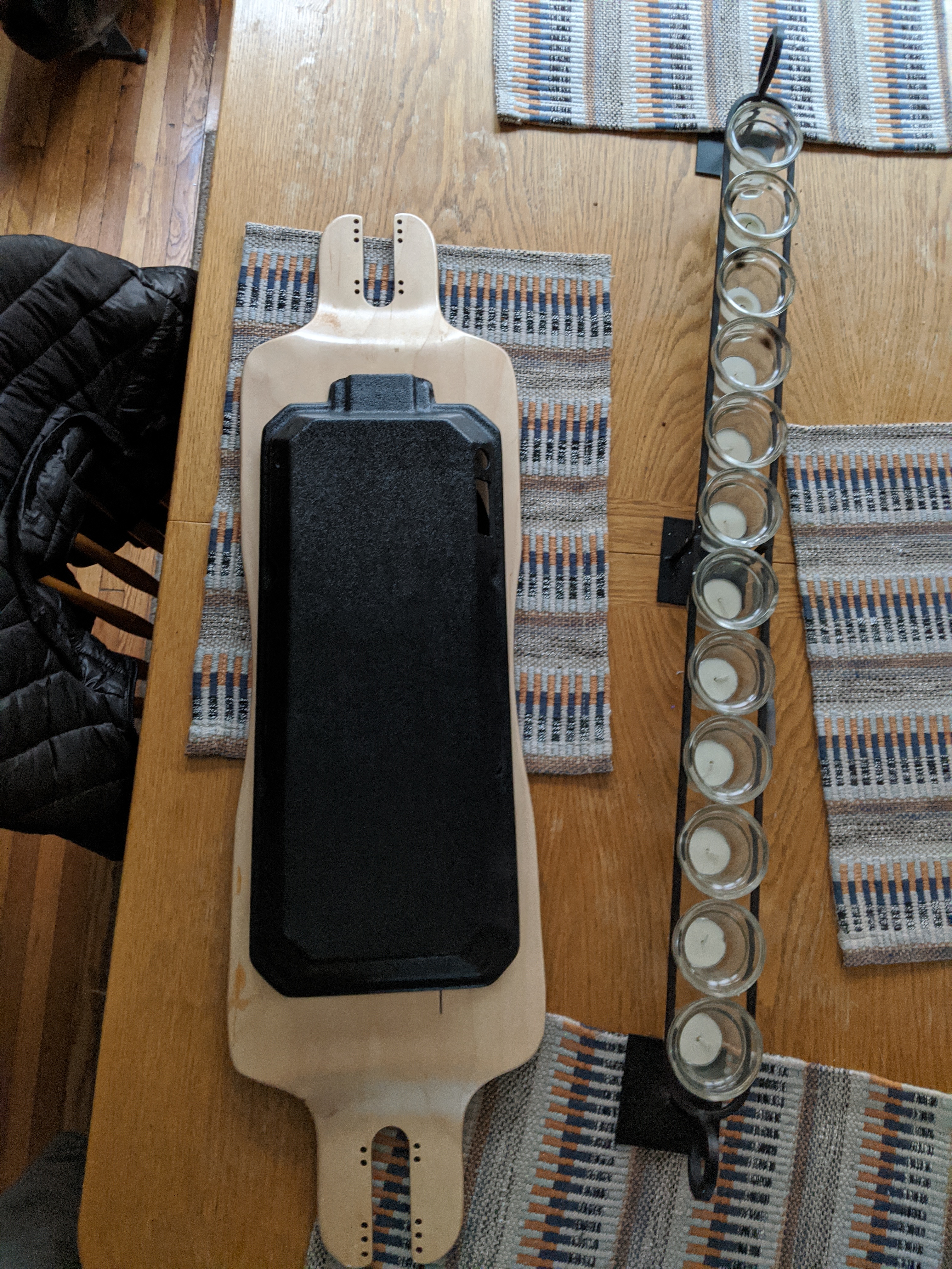

I’m gonna attempt to keep hidden though we shall see. I think I can create a cavity big enough for 10S3P 40T with plenty of room to spare
Battery decision will be tough for me. I haven’t gotten into building my own get, besides NESE

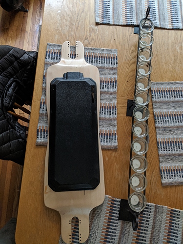

A psychotiller one fits. I put a 12s 4p easily in it back in the day.
Good to know! Appreciate the input a lot :+1: gotta be able to consider all the options.

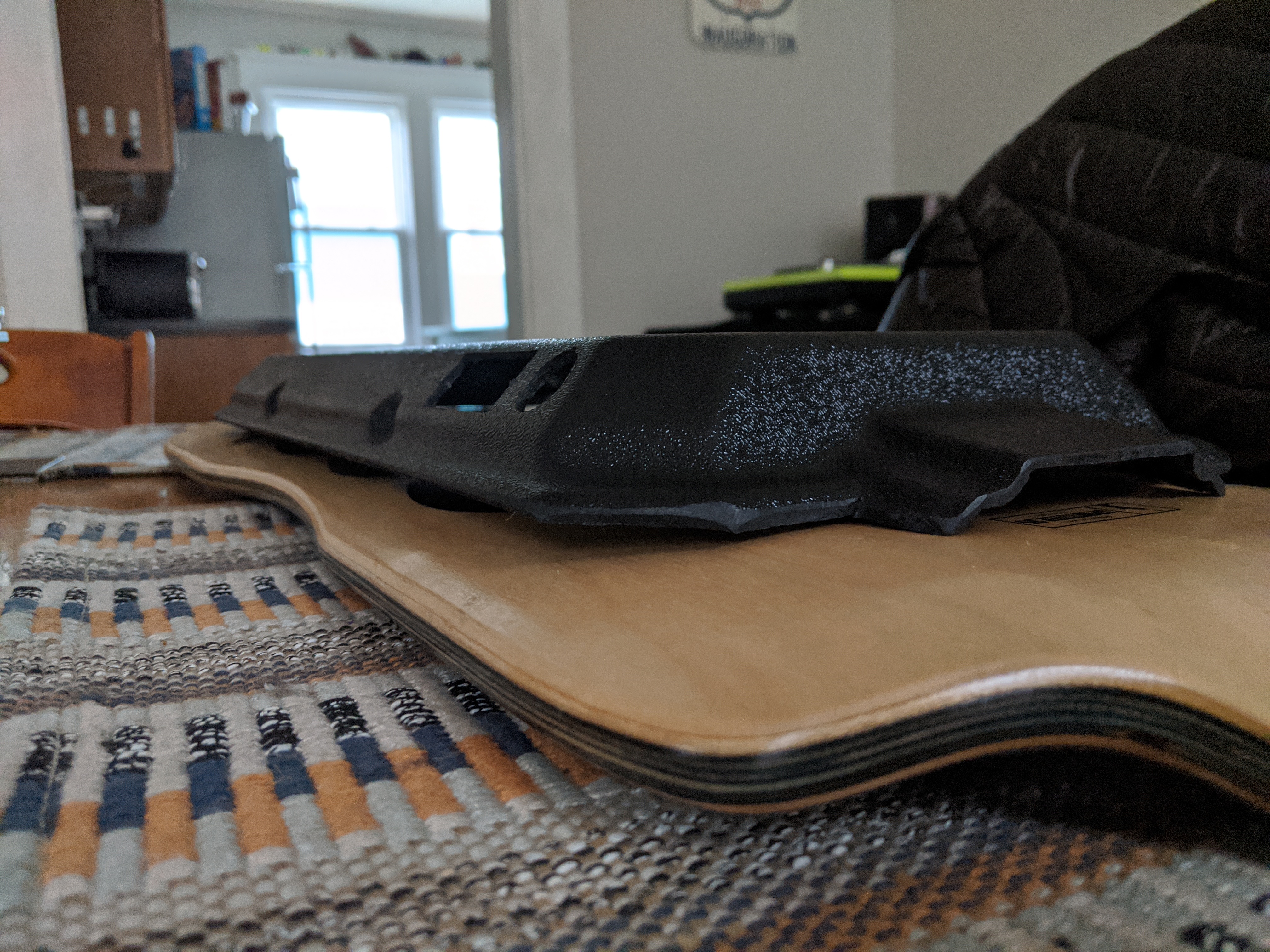

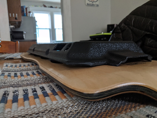

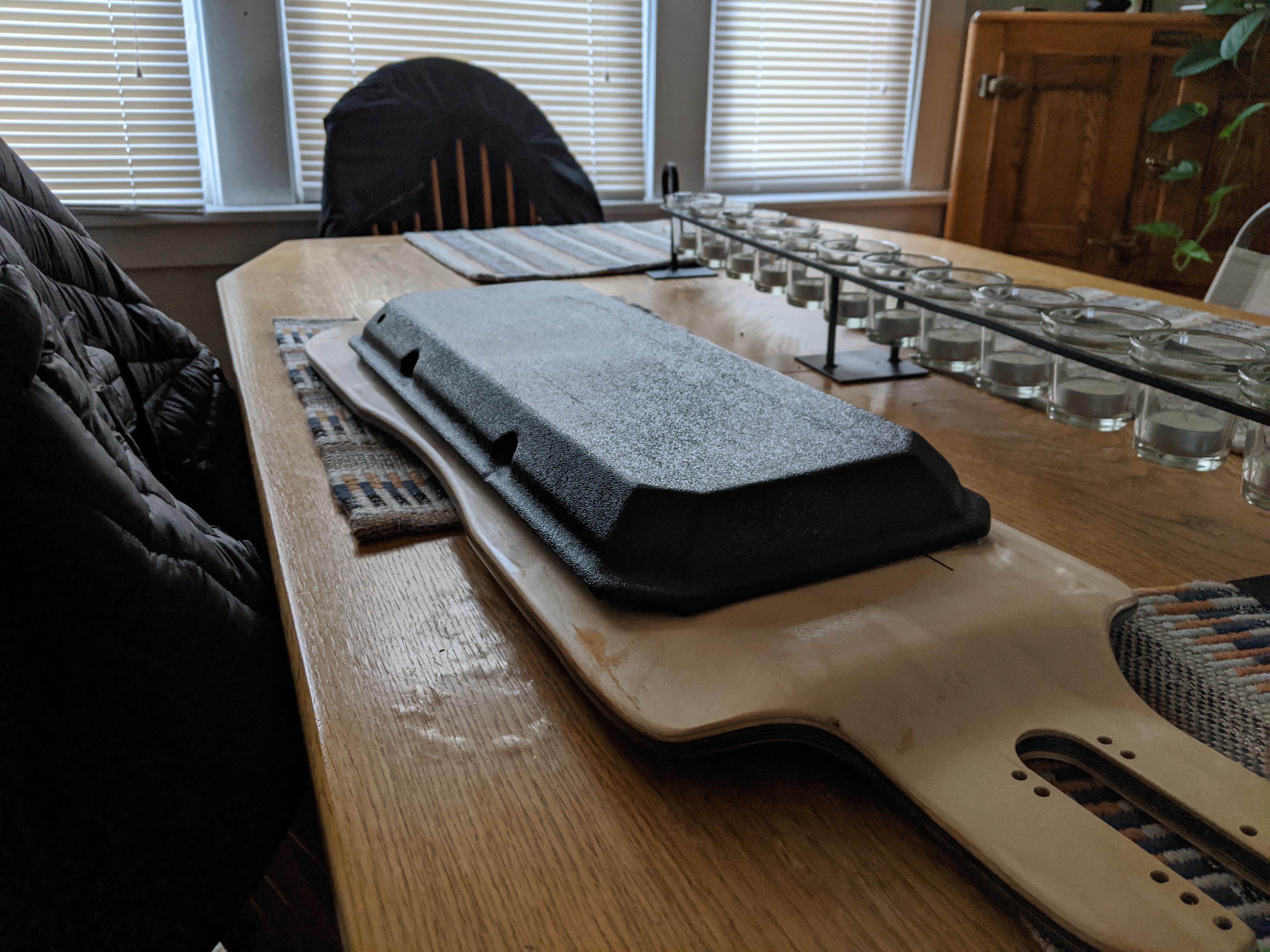

I don’t think that enclosure will fit the profile of this board
But it did. Worked for me.
Ah 7 1/2 looks wider than the flat profile on the one I have
Whats the other deck you have next to it?

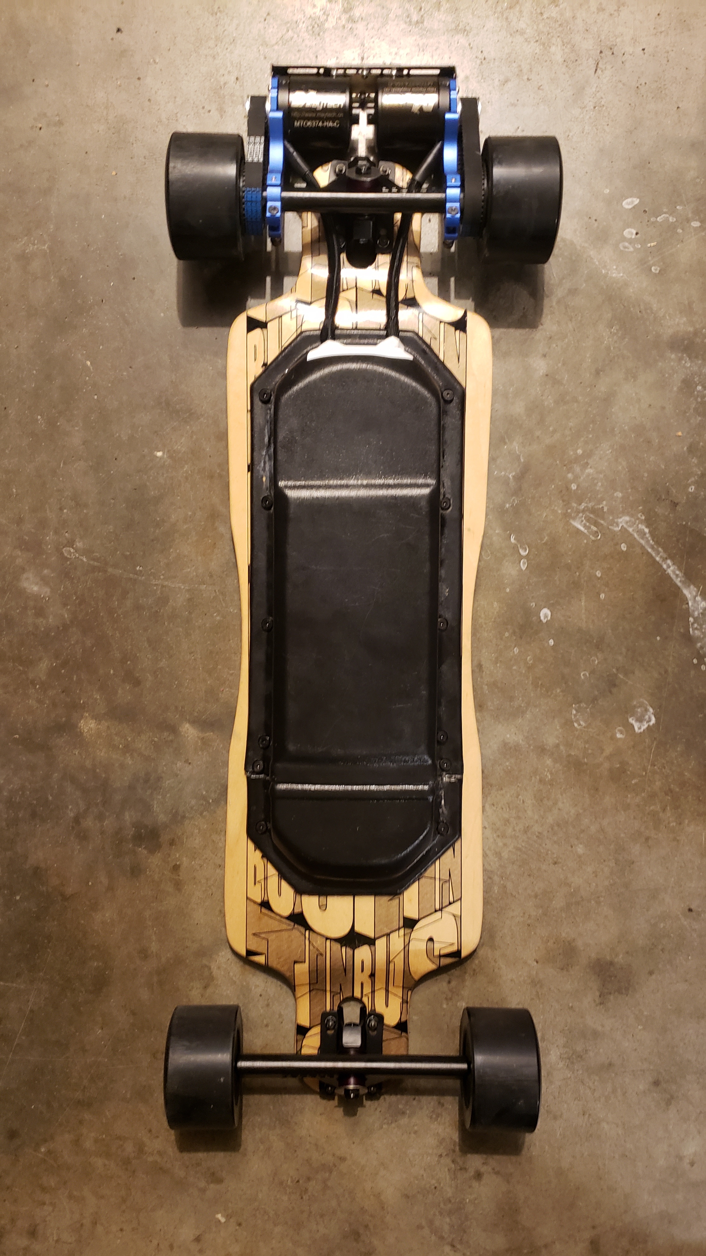

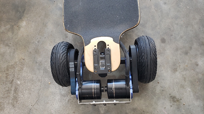

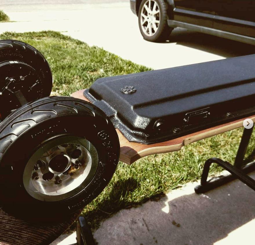

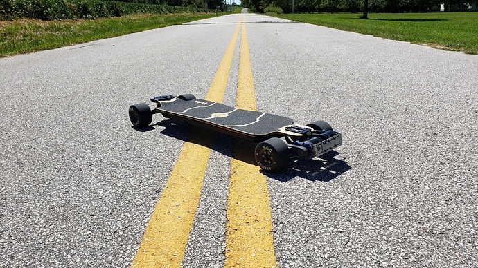

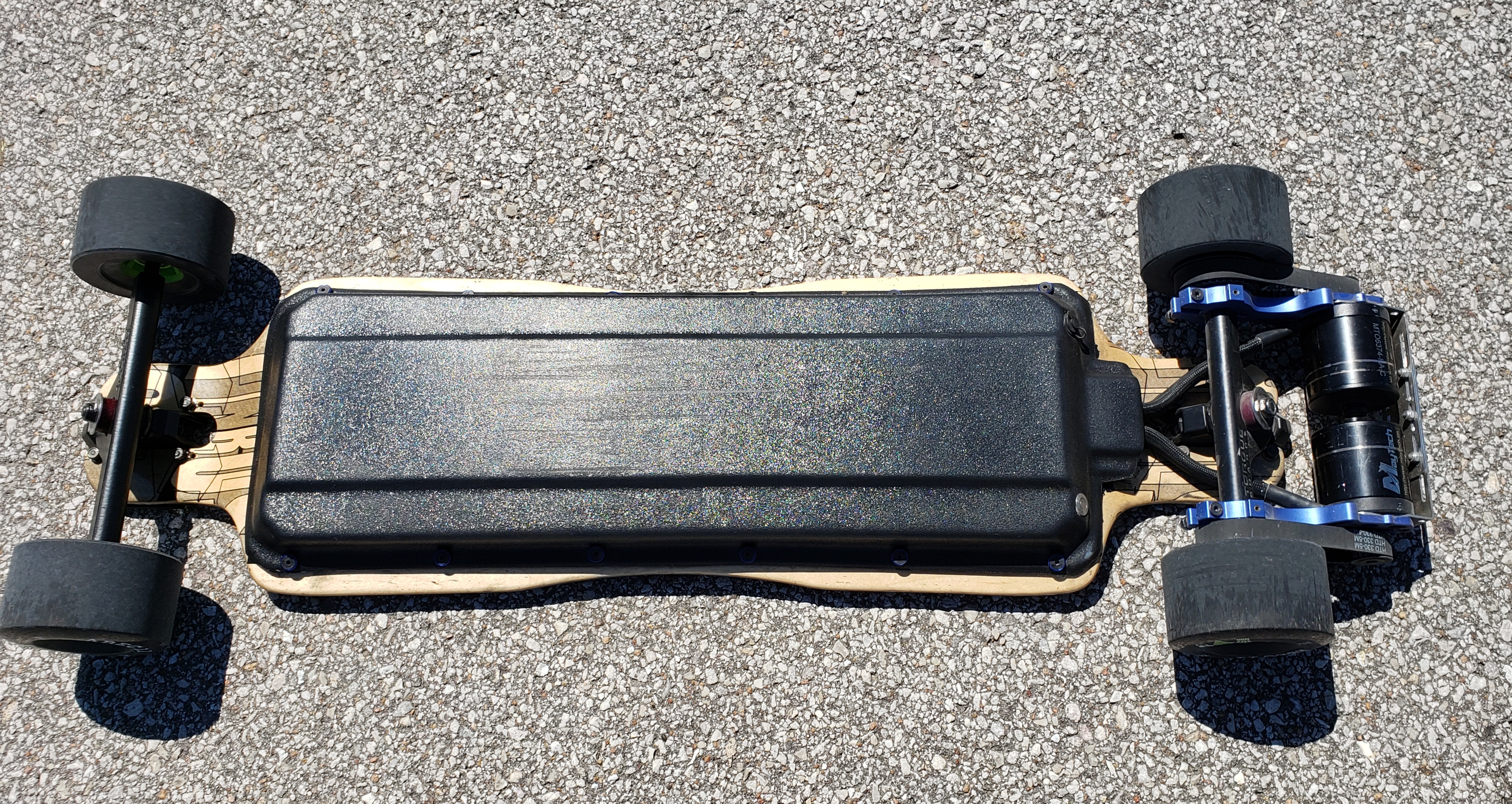

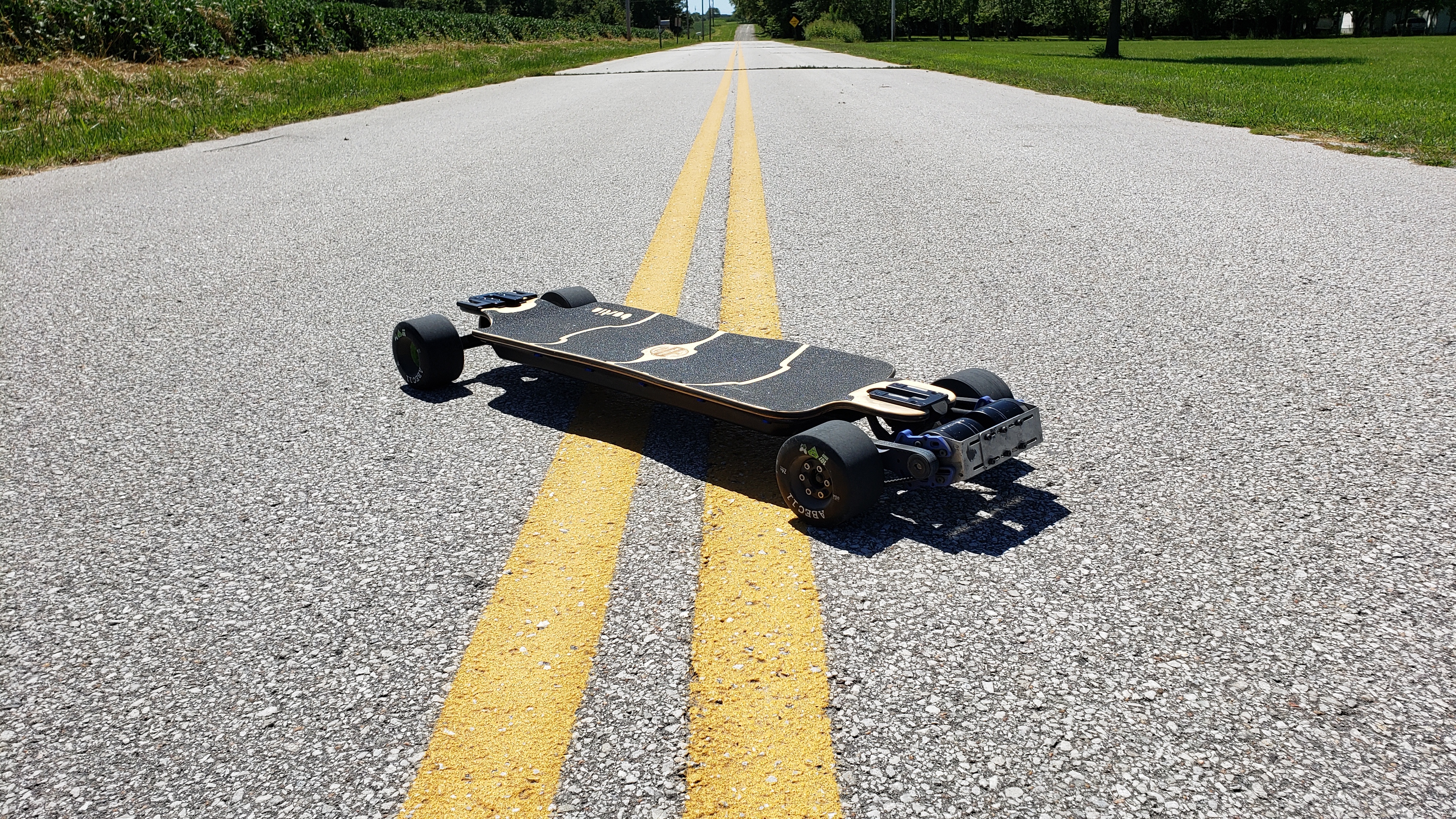

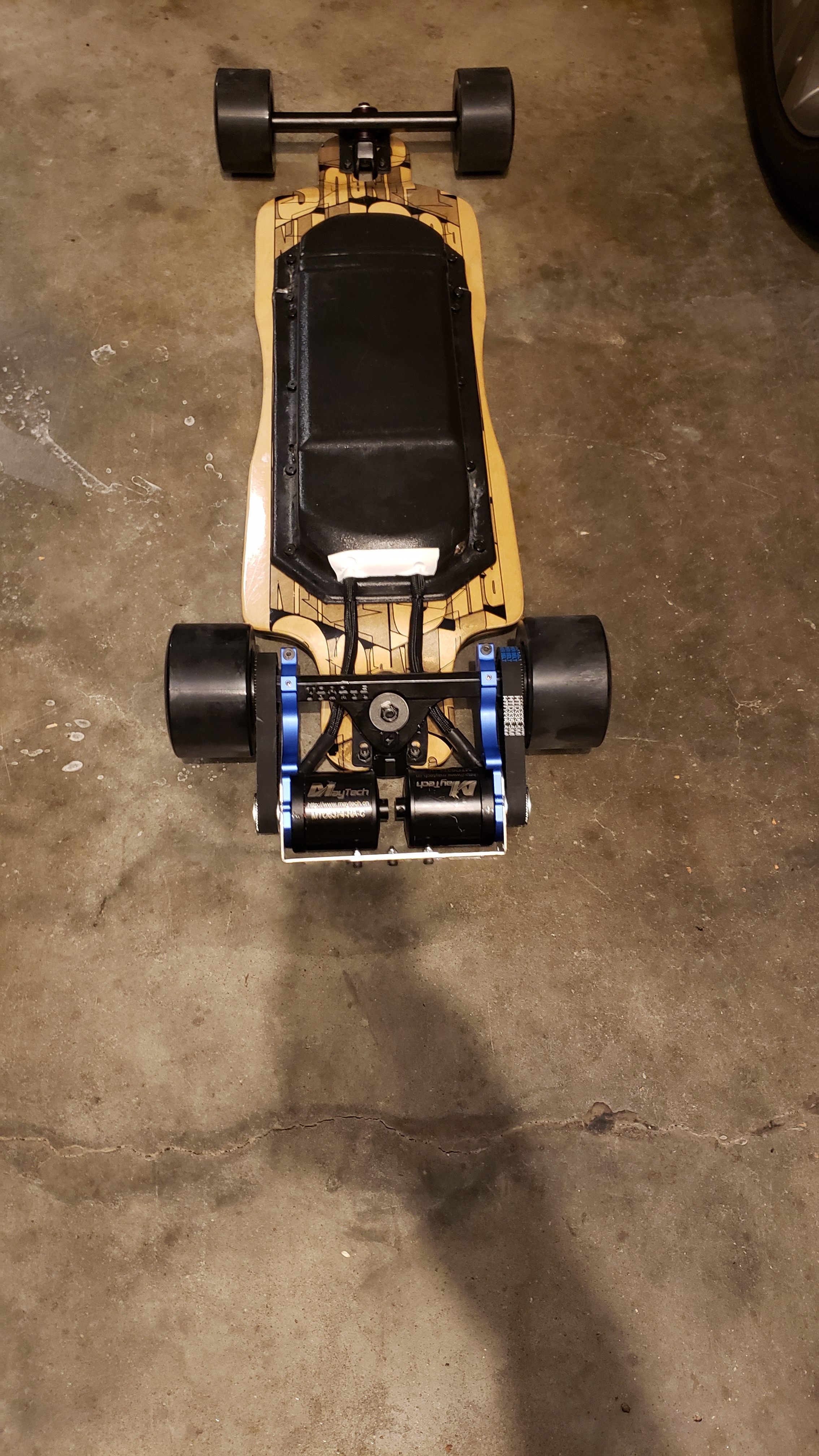

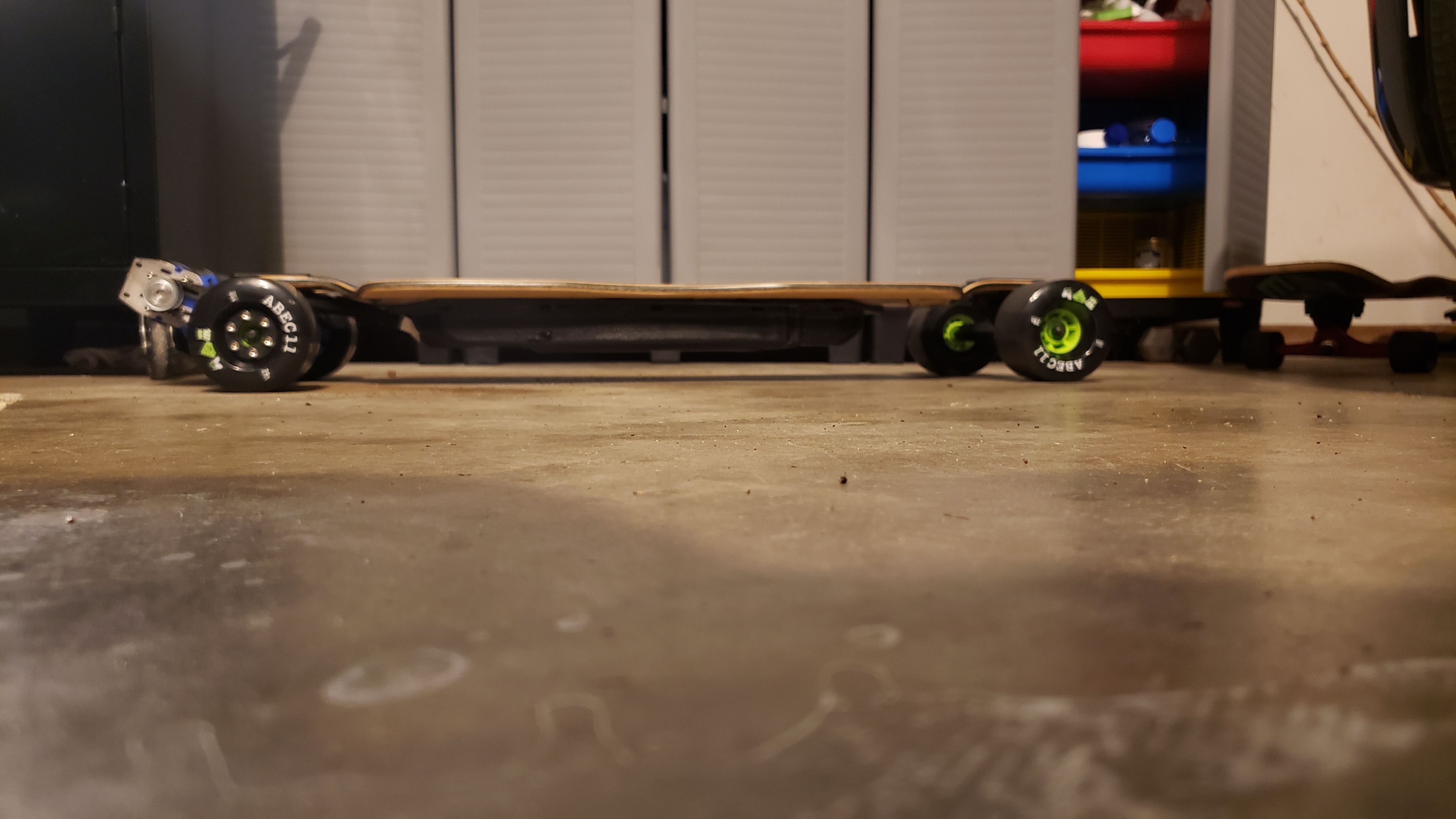

Here are a few pics of the builds I had on my Sportster. I used TB 218s and a psychotiller enclosure.
I started with the split sym enclosure which was not ideal and then moved on to the altar wedge.

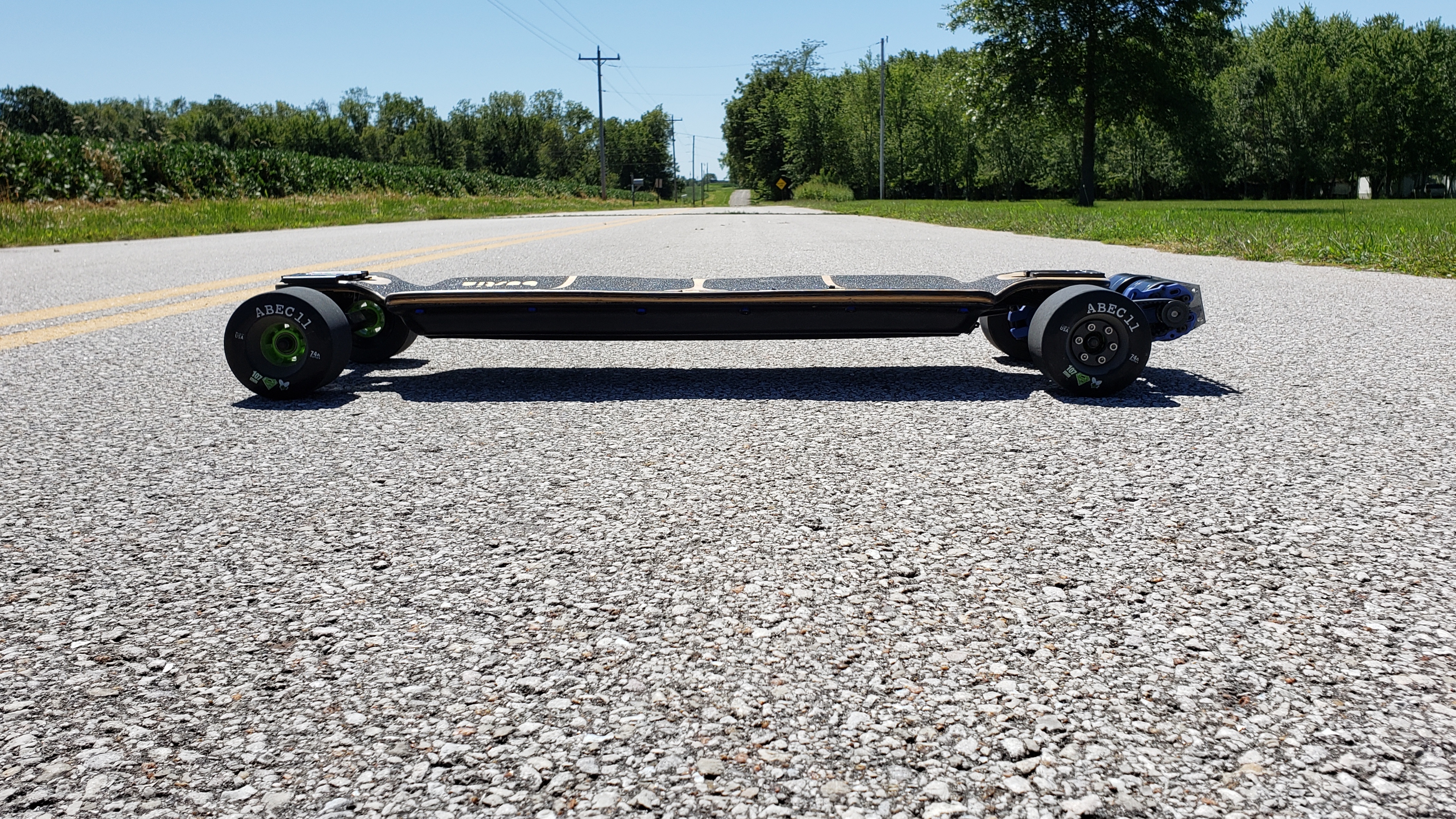

Then I put on 6 inch at wheels. I had to drill out another set of holes to avoid wheel bite.
When you say material removal in the corners for the Abecs - do you mean wheels or deck? How is that done on wheels?

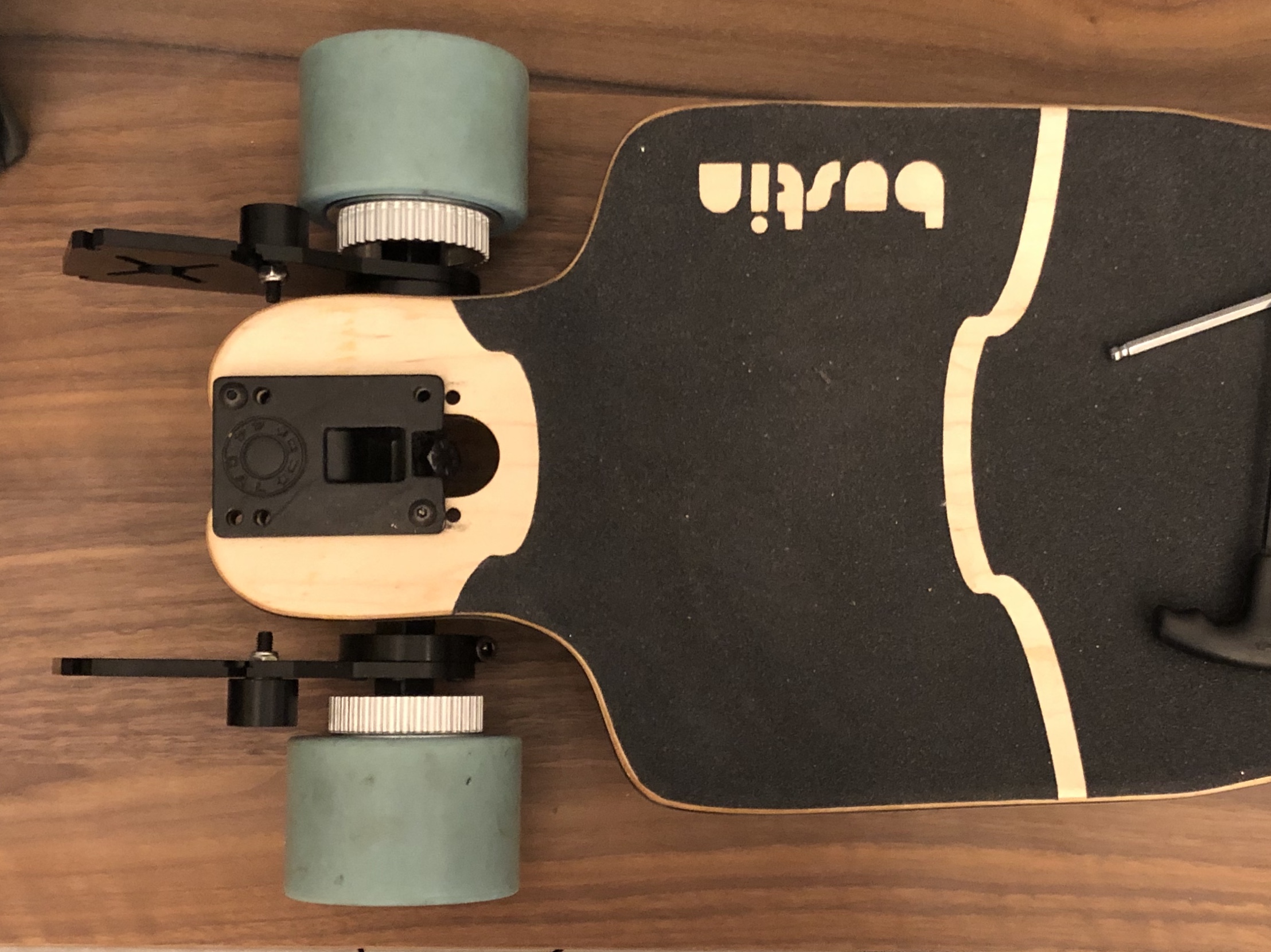

No the deck. I’ll see if and how much clearancing the deck requires. I’m hoping that with the 184 hanger and 10-13 mm spacers (ill space the front to equal the rear pulleys and bearings), I’ll wind up with a wide enough profile that they don’t rub

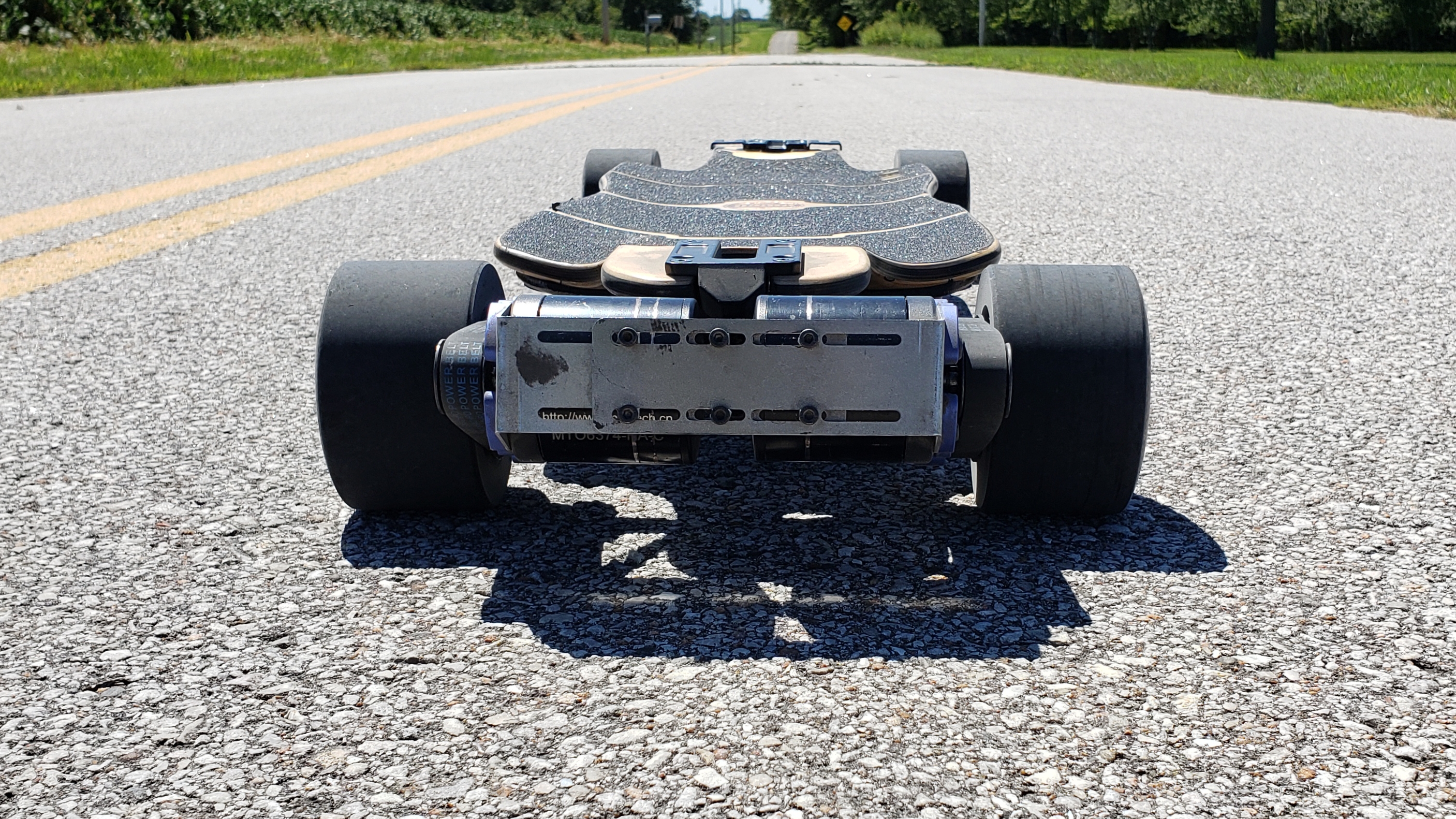

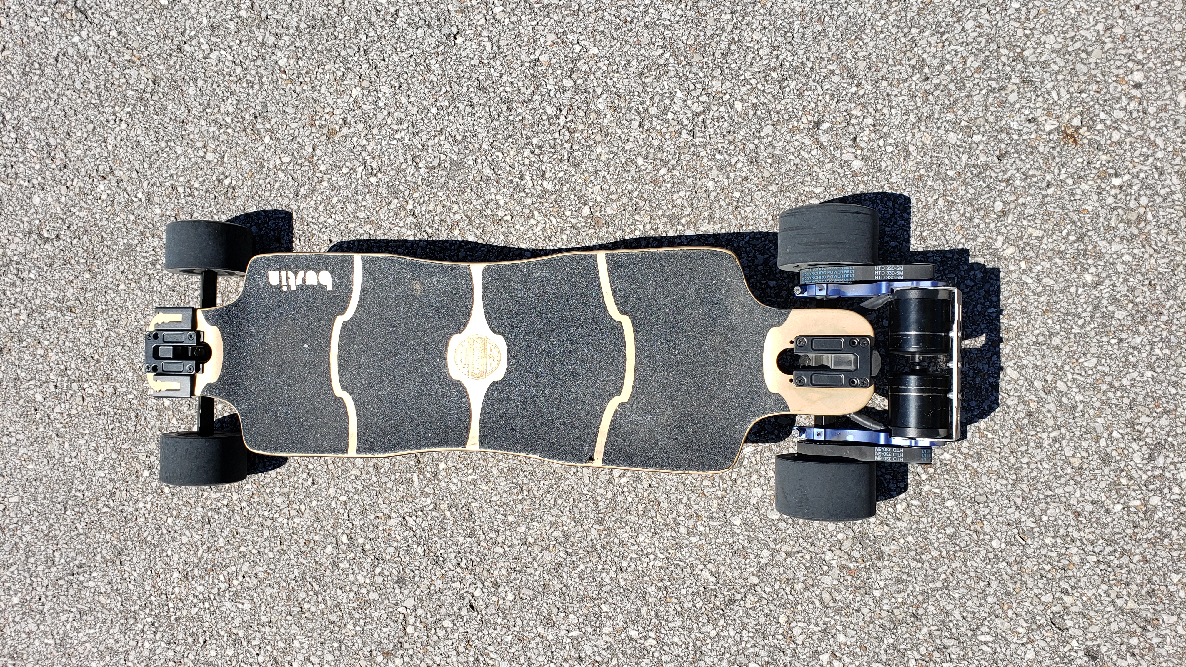

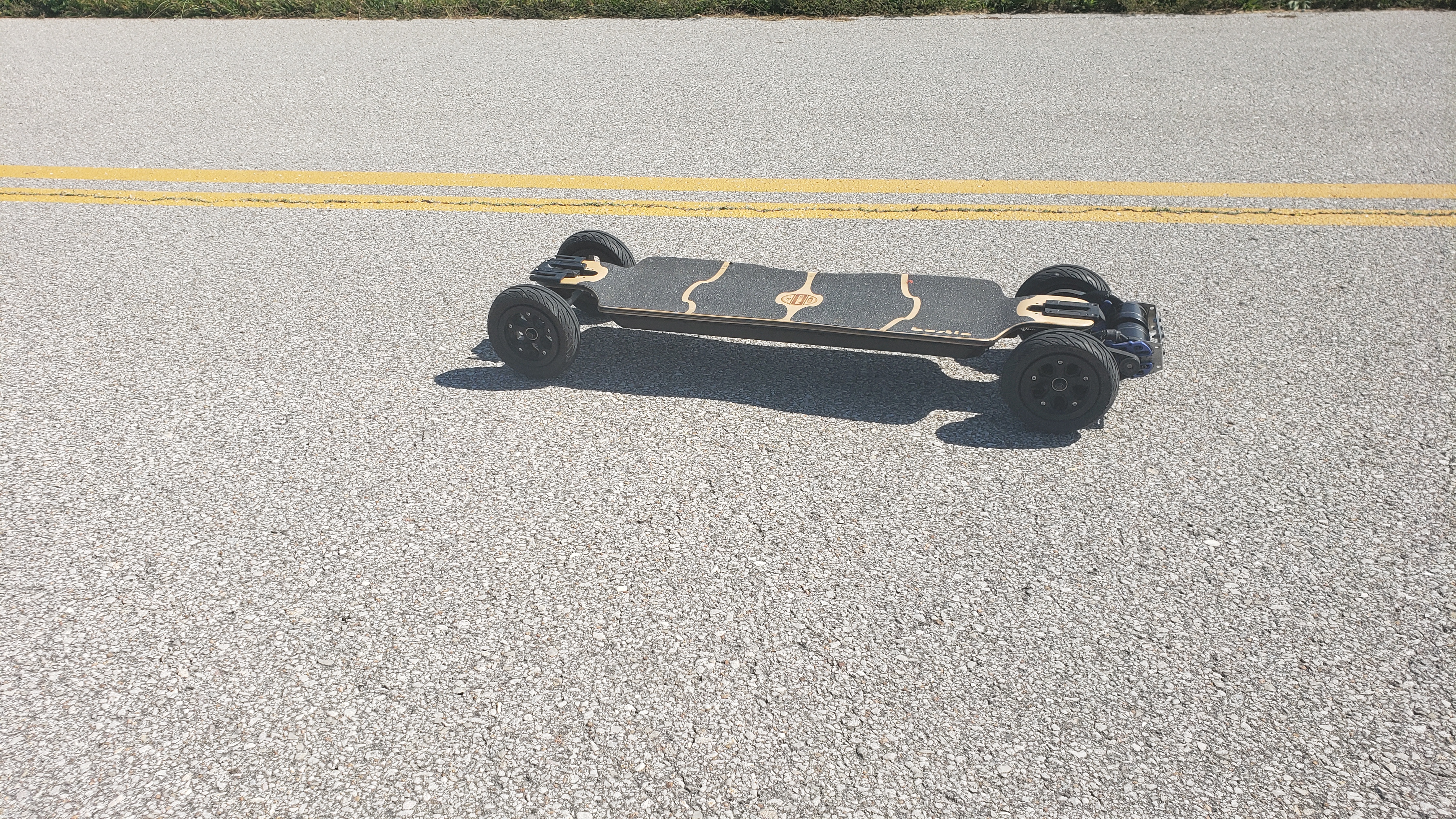

Here’s some more pictures. Just received BN184s and just threw them on
The pics above were with a wheel width of 10.5“ outside to outside
This is 12.25” outside to outside with cags
I don’t think rubbing will be too much of an issue
