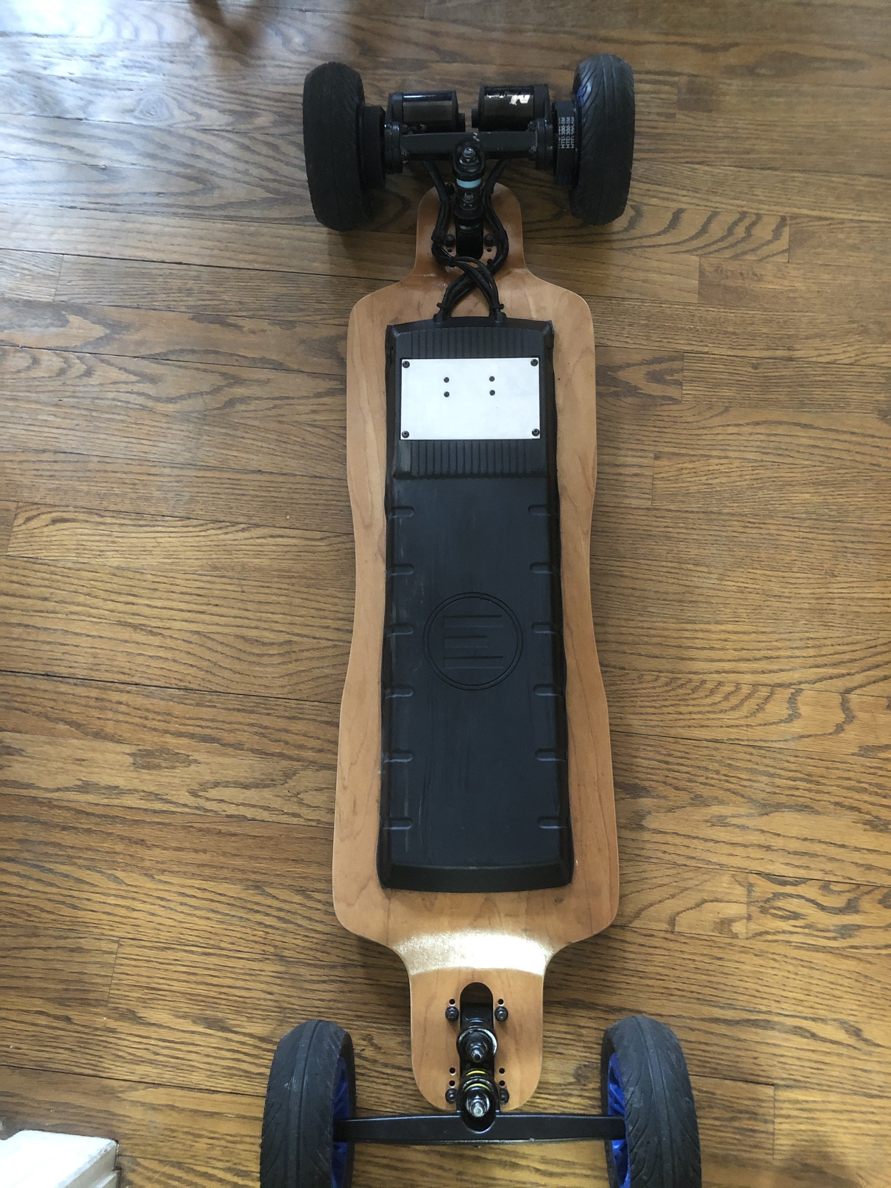

No build thread? Can you show us some pics of the underside and inside?
Looks great. Already love the look
I don’t have any of the inside but i have a unity in there along with a 10s4p.

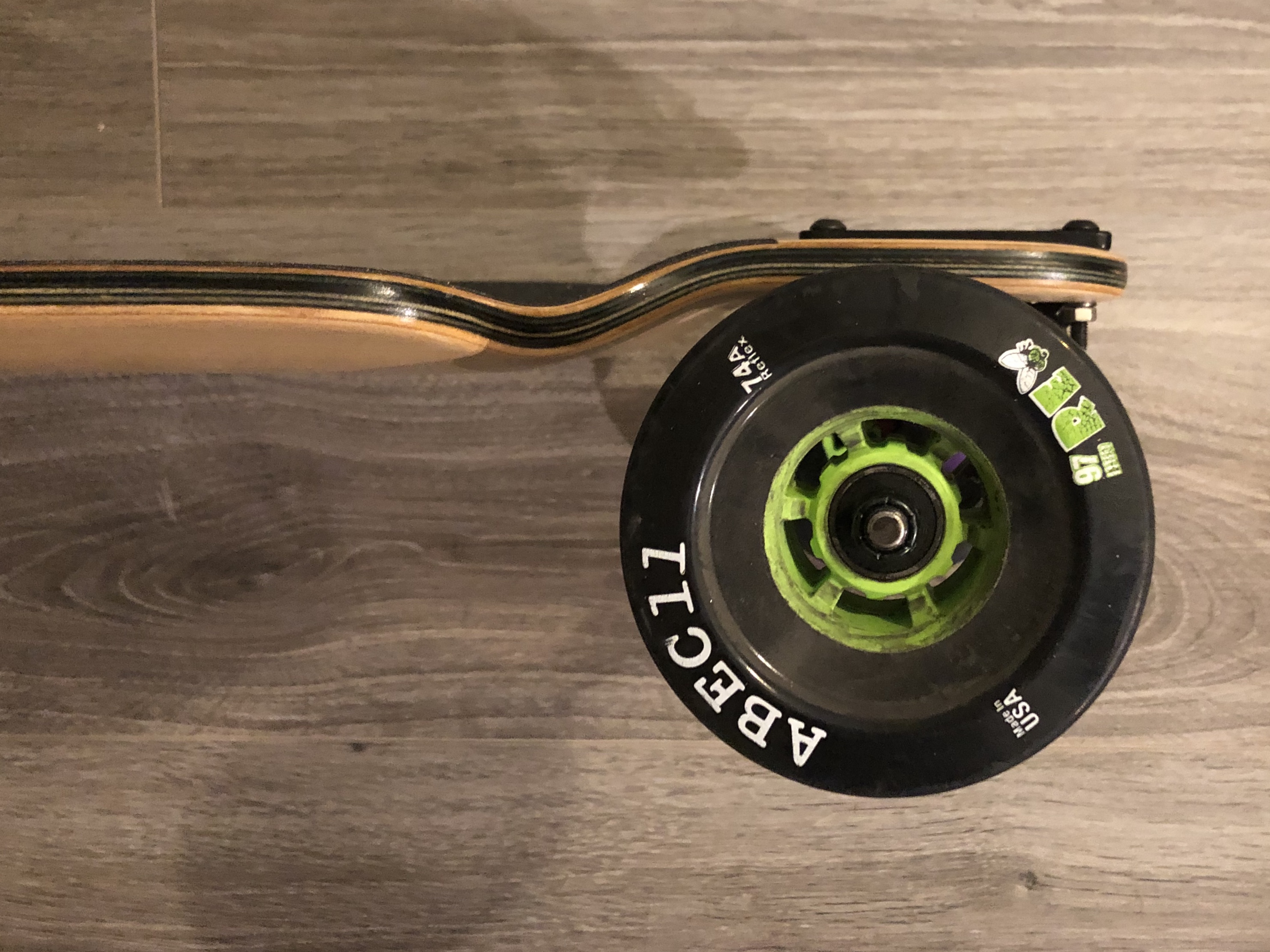

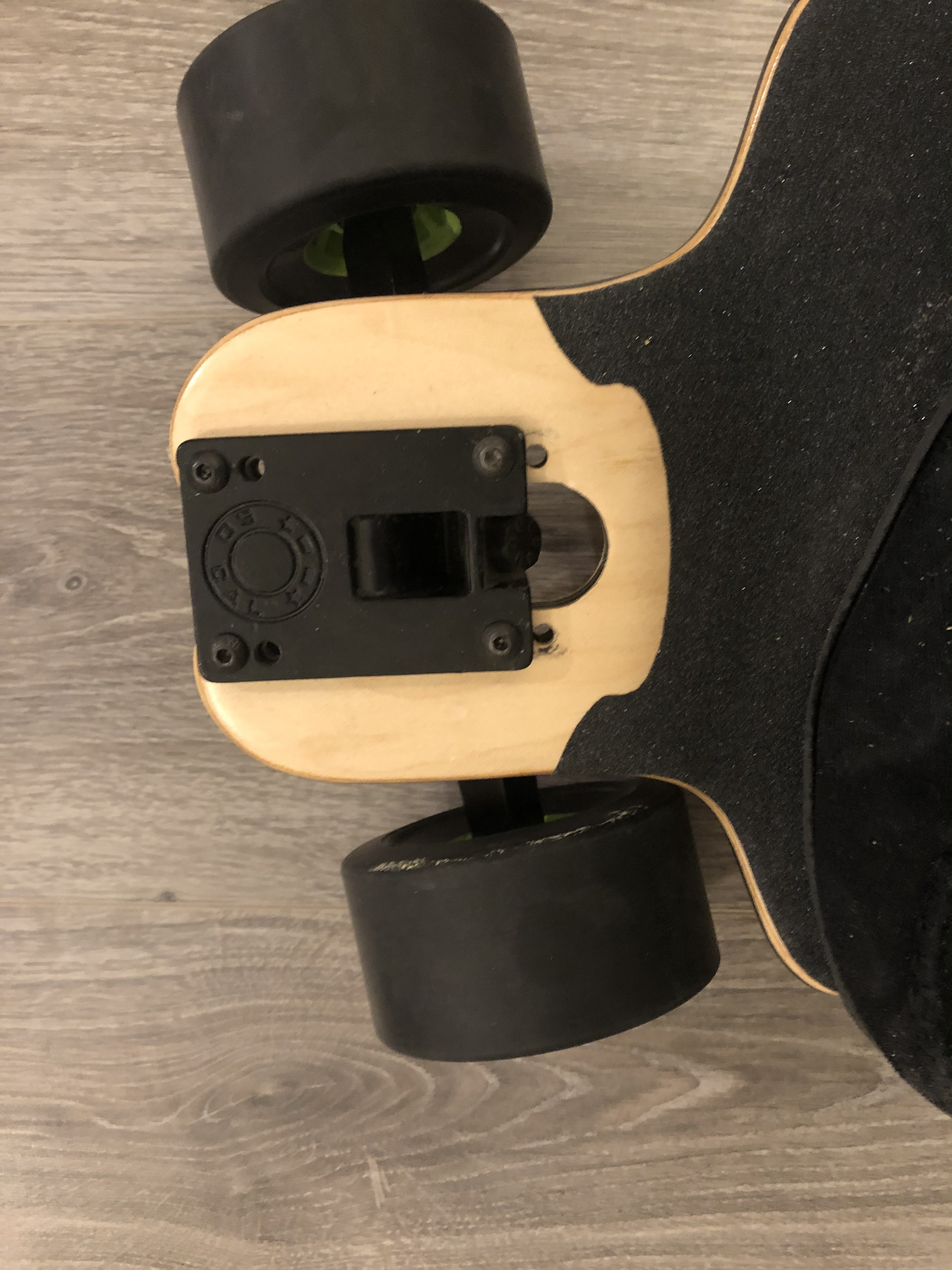

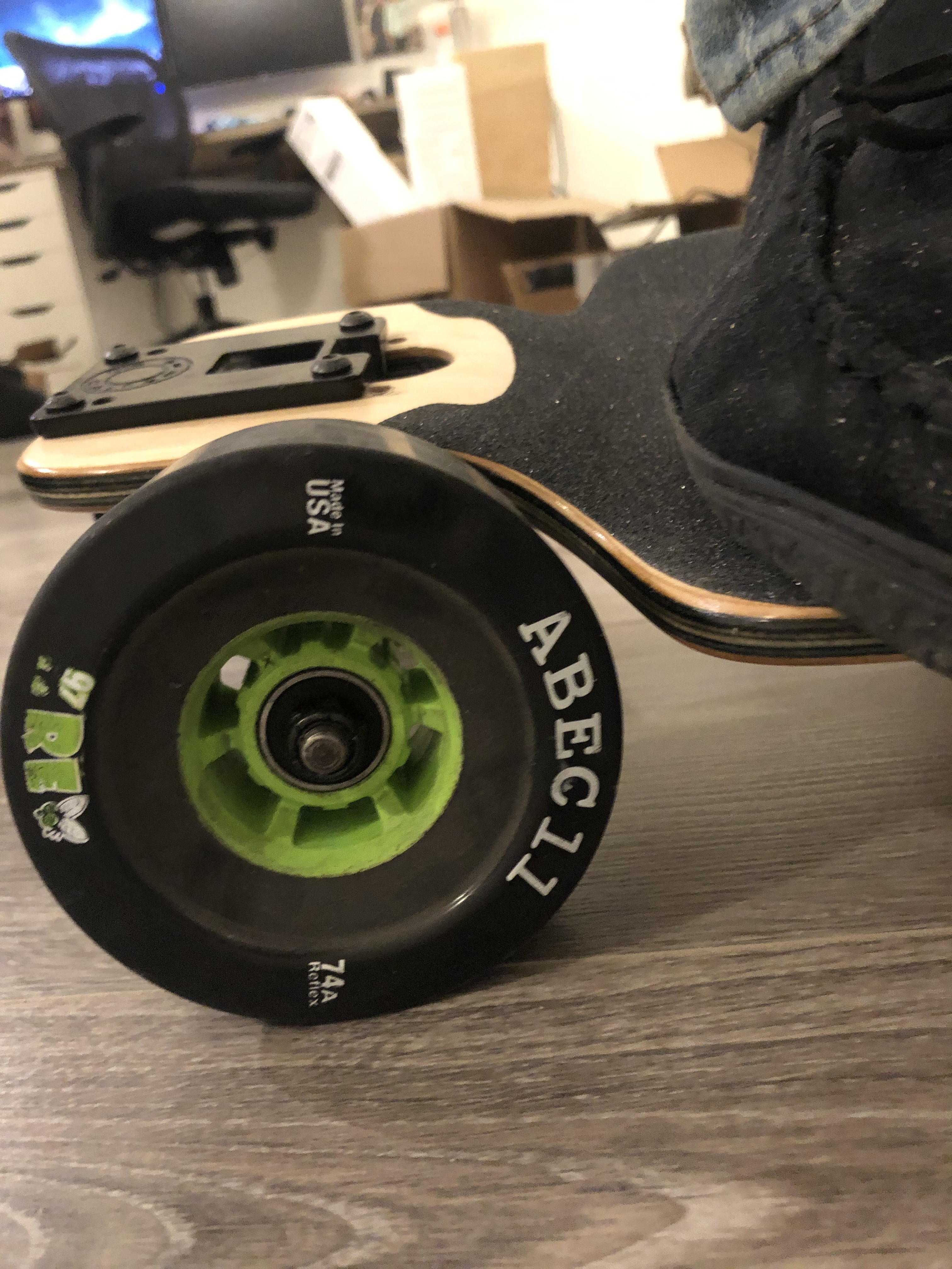

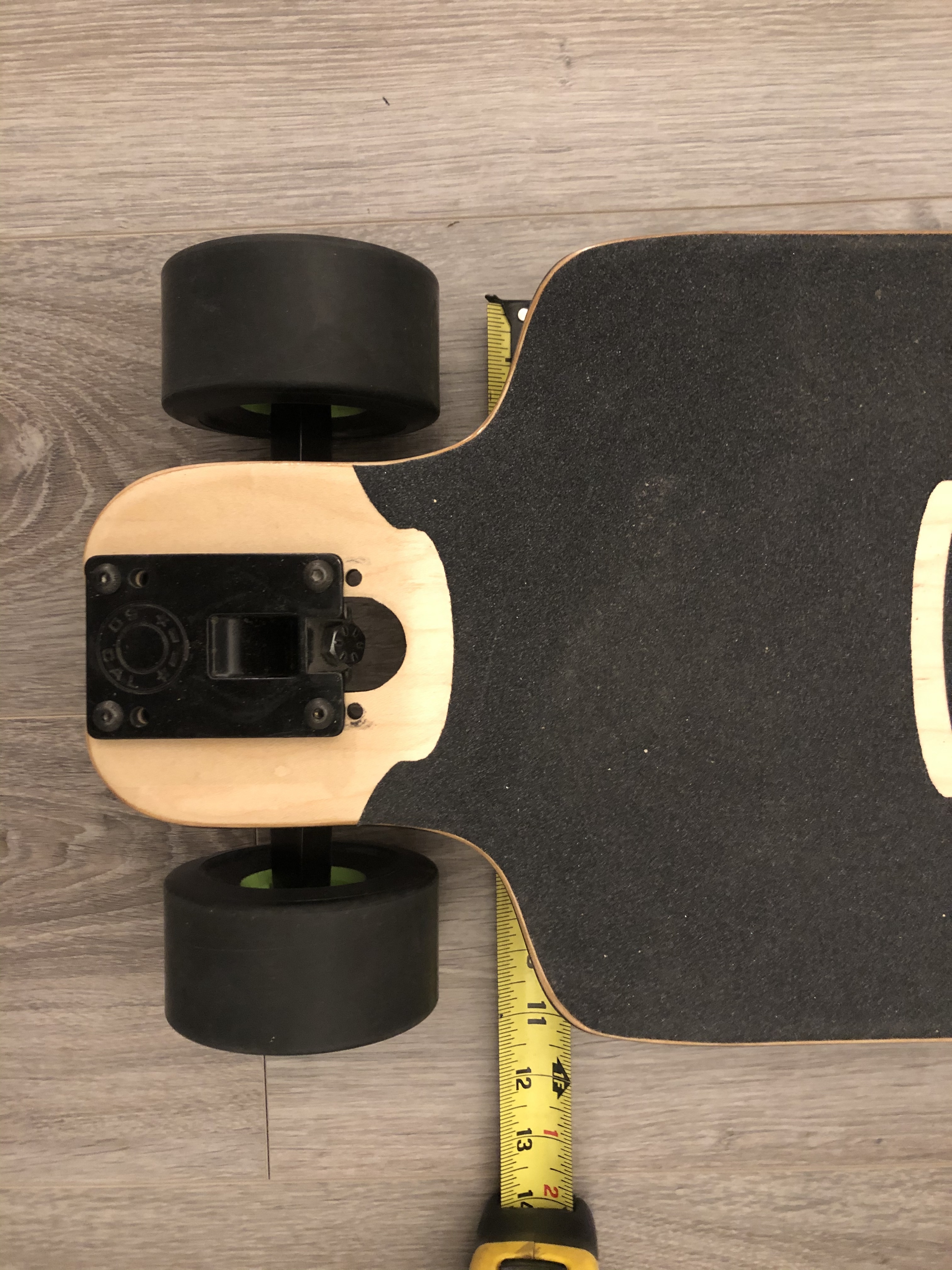

Config below
35” sportster
Caliber 2 45/50
90mm abec clones
Top mount - 3/16” riser pad
Pic below is the front, so 50* baseplate
This is max lean
I’ll switch back to drop through and take some pics later. I can throw the 97s on too.

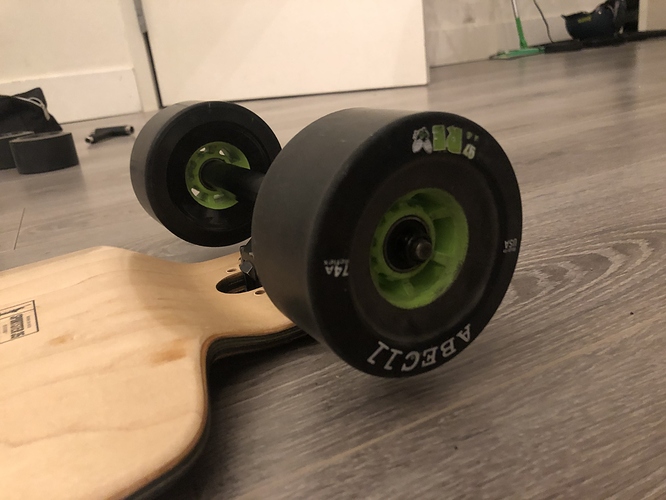

Definitely going to be challenging to use any kind of large wheel with drop through and an RKP hanger.
Edit:
Here is drop through. 97mm abec refly wheels on caliber 2s. This is the front 50* truck at max lean. The wheel clears with about 3mm to spare.
There is approximately 2.75” of ground clearance at the center of the deck

Updated with new pics

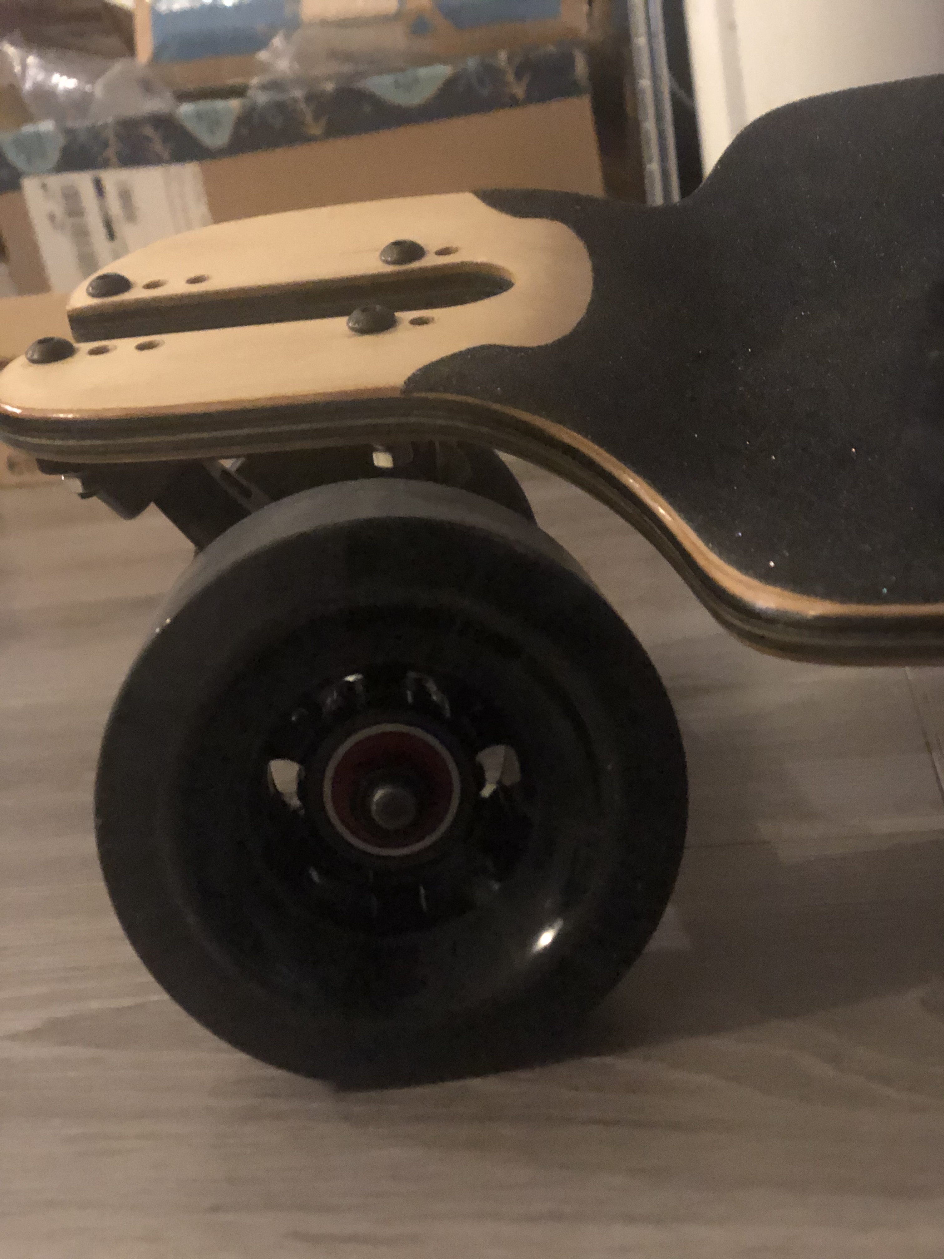

I have some @boardnamics 184 mm hangers coming, I could potentially space the wheel a little outwards or change the axle bolts to get more. Trying to stay as narrow as I can.
I have boardnamics idler mounts coming and I’m considering a rear mounted belt motor setup. However, I may switch to a TKP or DKP direct drive. That will give a ton more room over the RKP angles should I go that route.
Either way, looks like I’ll be able to fit 110s with maybe just a little material removal in the corners.

10.25” across the wheels (97 abecs)
