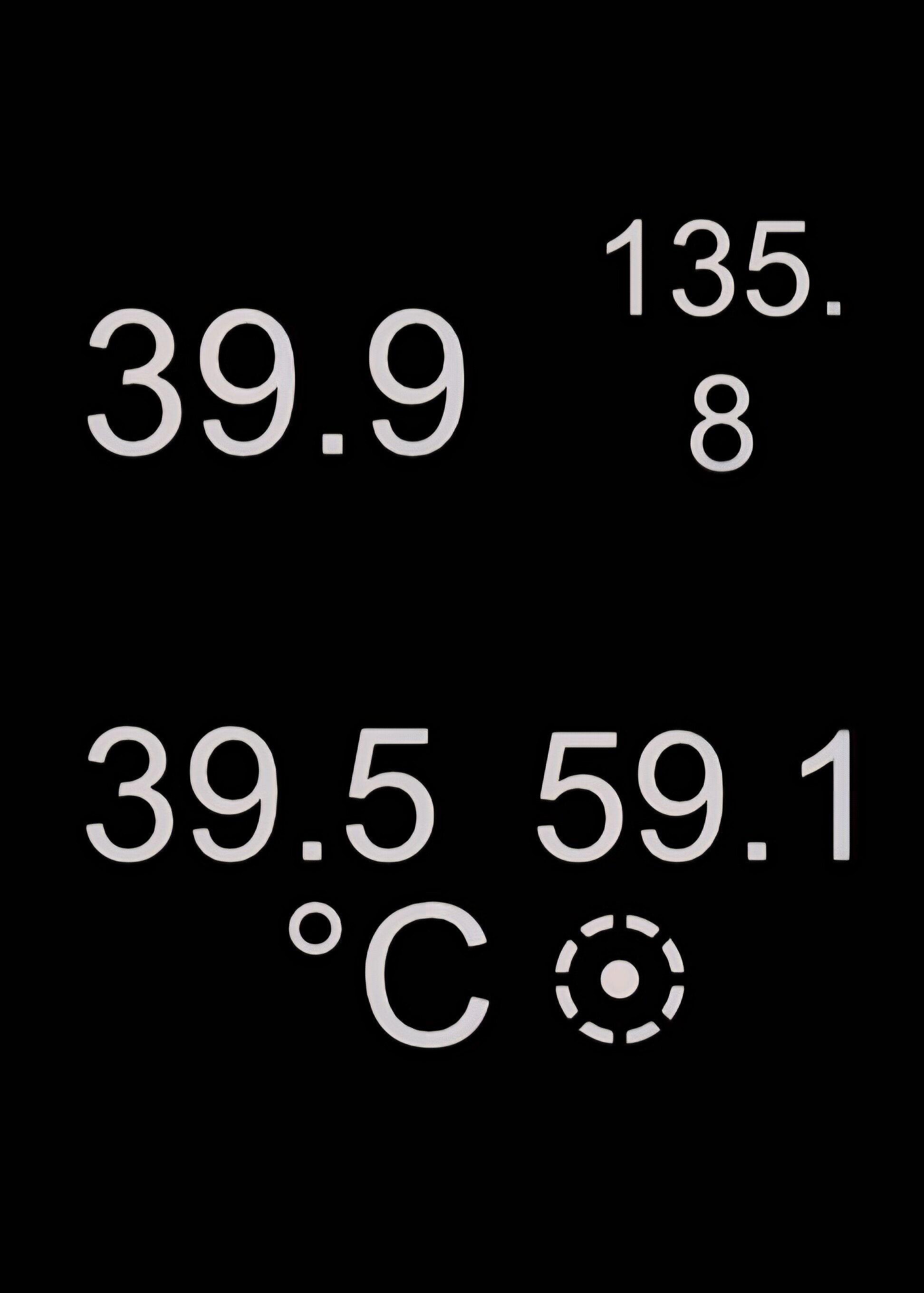

One of my rear motors isn’t happy. Possible winding issue? Motor spin freely, @Pecos opened up the motor and the bearings looks good and still spin freely.
Have you tried switching motor/vesc sides? See if it follows the ESC instead of the motor?
I ended up running 2wd with a smaller 6465 on the problem side and there wasn’t any temp issue. The 6465 heats up faster but nothing out of ordinary.
