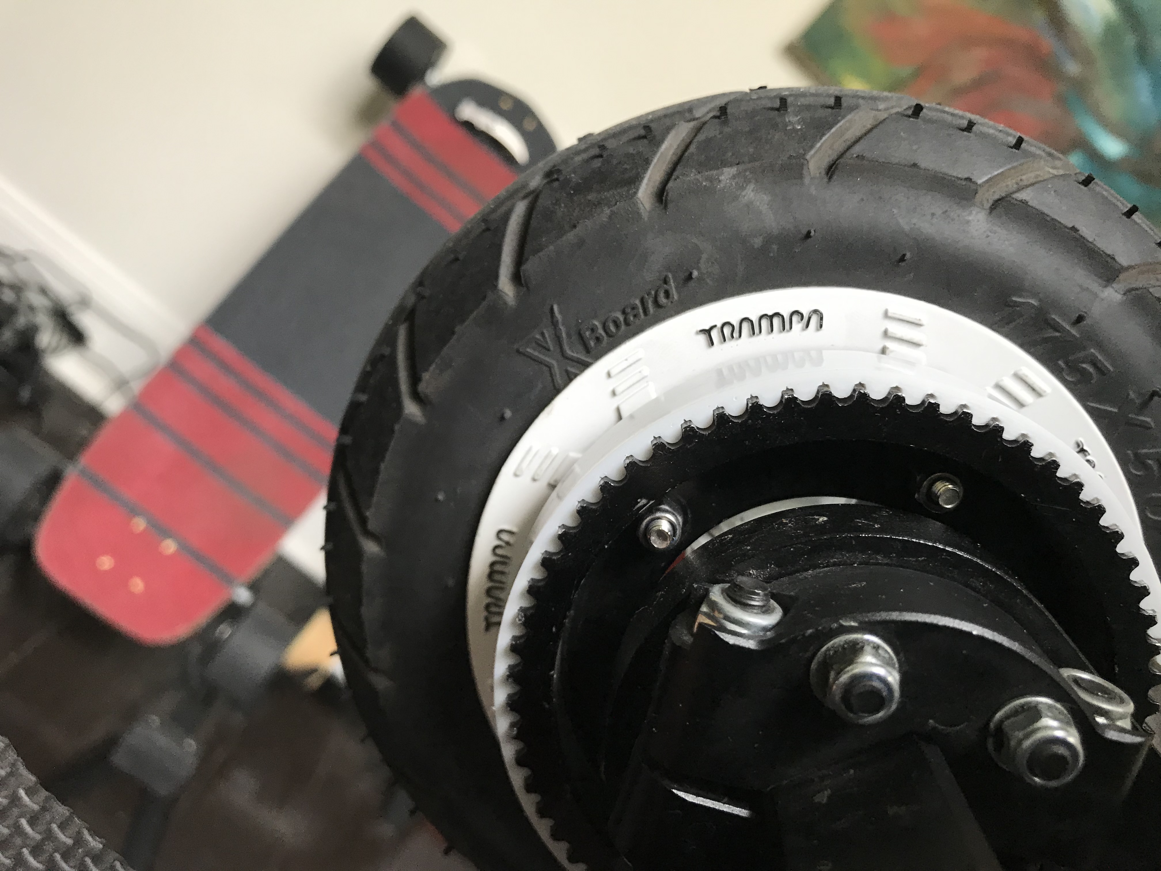

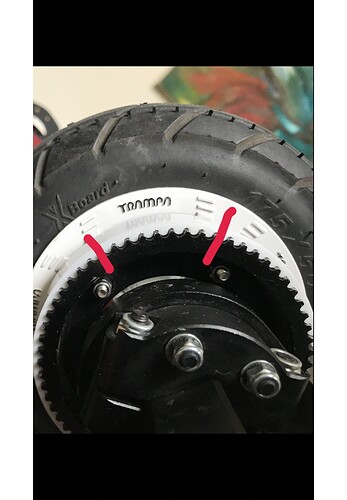

Bad news bro’s the white belts don’t like like large pulleys so hold off on buying them
Womp womp
@Bavioze
What’s the problem?
Seems to get wonky contact between those lines, caused the wheel to “hop” a little as it rotated, didn’t notice it testing it in apt, took it to get food this afternoon and it happens above 13ish
Idk might be able to figure out a way to smooth it out but I’ve run standard belts after with no issue so it’s a belt prob
seems like the belt has the wrong tooth size
Somethings up listing said they were htd5 :man_shrugging:t3:
yeah, they fucked up or you shrunk your pulley or every other belt you use is wrong
Do both belts have it? Could be mismatching tolerances?
The left one didn’t seem to hop too much but it did happen eventually on the ride. The right one was much worse tho.
I have a feeling that if I realign my wheel gears and get them perfectly centered, then run relatively tight belts I could get them to work
They say they are urethane, so it probably has different needs for tension etc.

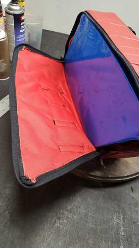

20s8p Tesla pack is done, batt bag is done (ox bloodish pleather outter, waterproof liner inner)
Next is harness soldering, final assembly, and I’ll prob get some accessories for it too.
My frame is not the one in pic she’ll be black so all that red should pop. Probably going to redo the seat in this ox blood material too.

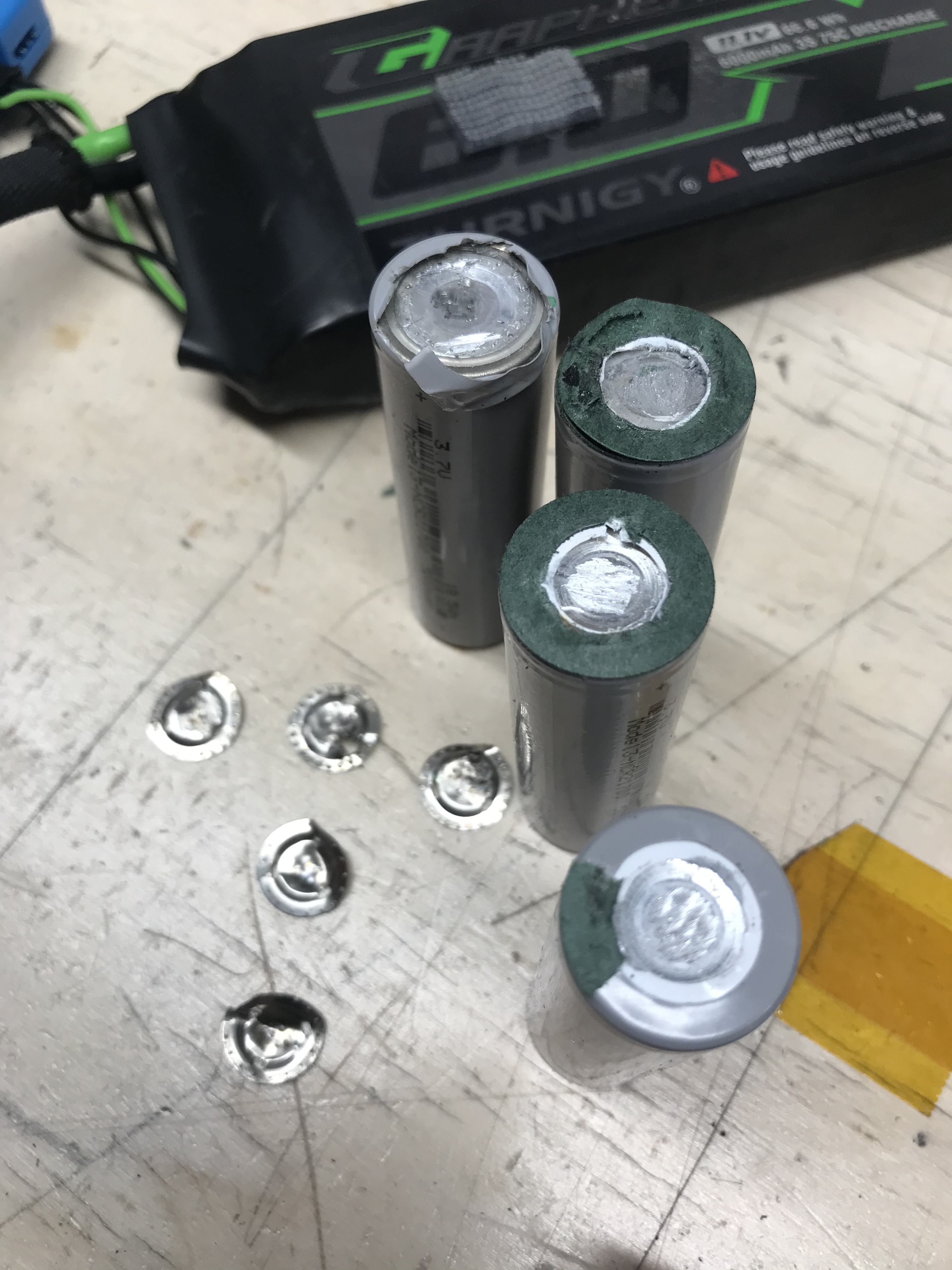

Last photo is some issues we had with a few of the Tesla cells. Cap literally ripped off when replacing some cells that appeared dead. So buyer beware and heed mooches warnings about the fact that these are technically repurposed cells, even if they’ve had no cycles.
Fuck this is giving me anxiety. I did test every cell tho.
you are hopefully good then but yeah just monitor those P groups on the first few charge cycles
