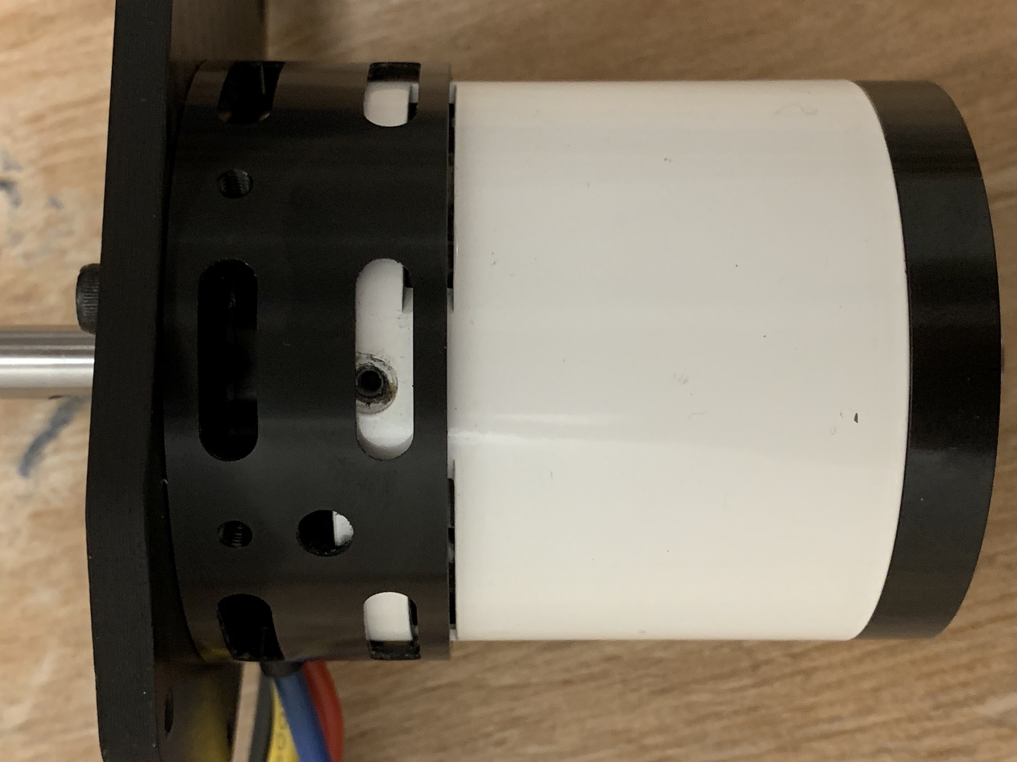

Show me a picture form the top. The Rotor probably moved a bit to the back. You can see that if you look at the 4 screws locking down the fan on the front side of the rotor. Do they line up with the holes in the black front shield? You can gently tap on the motor shaft (back side of motor) to get the rotor back into position.
You can see a picture from the top in the first video. Or do you mean a picture from the side?
Side. If you remove the 4 screws on the rotor side, you can push it apart. It just needs some force.
Make sure the shaft is really clean and free of scratches. Take some 400 sandpaper and smoothen the shaft to eliminate any scratches. The shaft tolerance is tight!
@Trampa Here a picture from the side.
For me that looks completely aligned. Shaft is completely free from scratches, because the motor is brand new as said above. I was able to remove the black part from the front of the motor, so the shaft should be in tolerance.

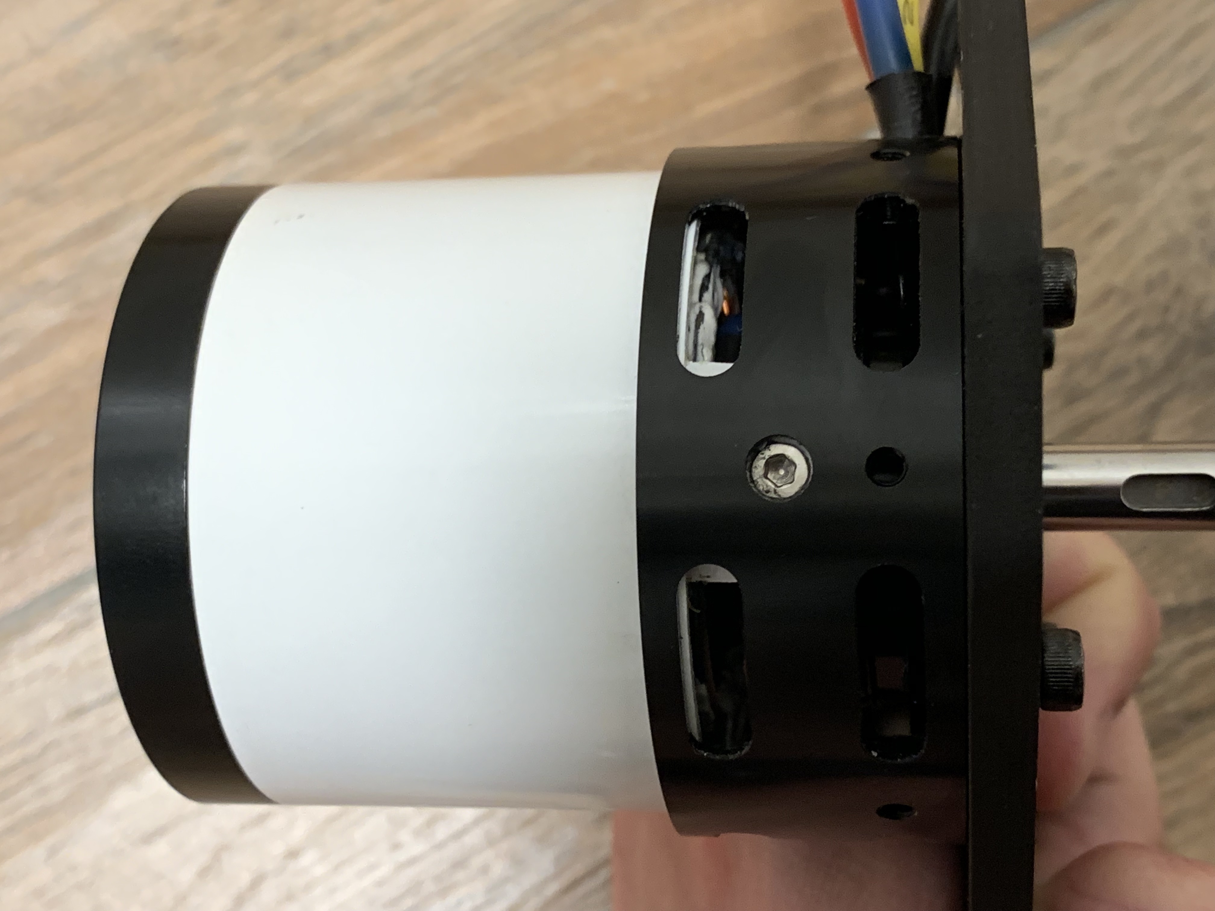

@Trampa I tried that and it looks like the outer white motor can is moving together with the internal black fan. As you can see in the picture the threading of the fan is still aligned with the hole, but together they are pushed out a bit. I guess that is not the way it should be.
Maybe compare to the motor that is still fine? I now remember one of my skate motors also had one can slightly sticking oit more so I had to push it back in like 3 mm.
The other motor has the black front shield also aligned with the four holes on the side when assembled. I did not try to disassemble the other working Trampa motor.
I think when pulling the white motor can the internal black fan should stay in place and the four holes in the white motor can move away from the threads of the inner fan. But that is not the case for this motor.

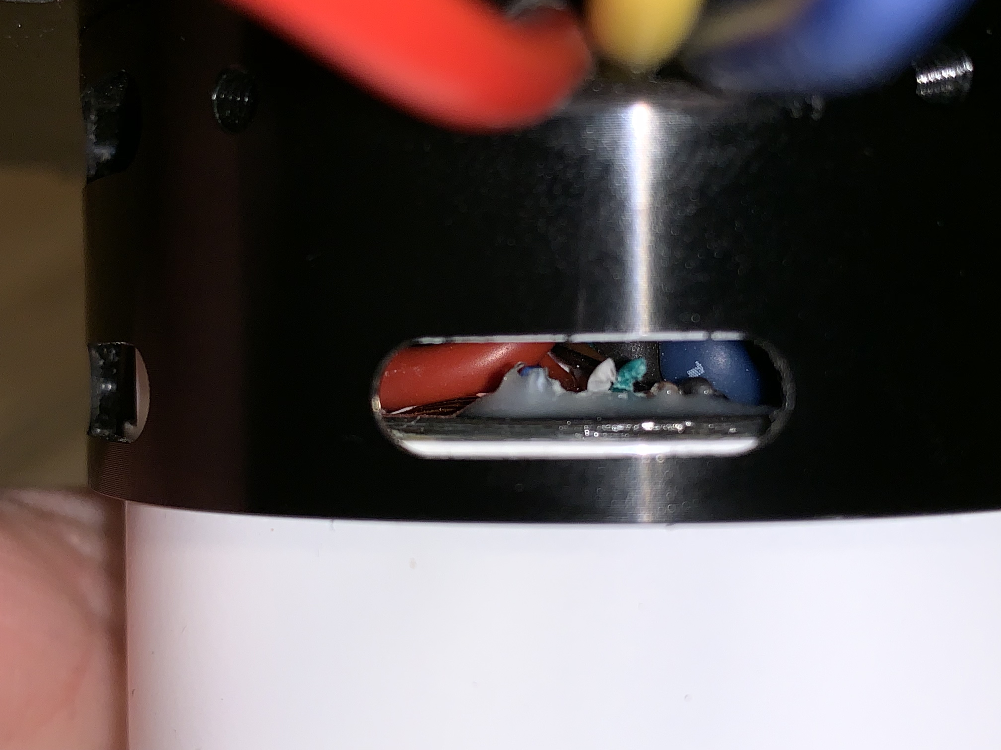

So it looks like what I was fearing actually happened. I was “using the force” like recommended by you, but still tried not giving to much force. Unfortunately it looks like it was still to much. Now I pushed the stator back in the initial place where the four bolts are aligned to the holes of the black front shield and the hall cables look ripped off. :cry:
