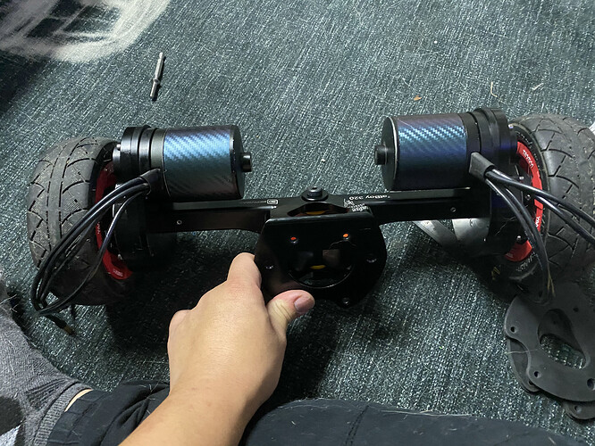

20700 santo pack from a 2.0 fitted to 18650 enclosure

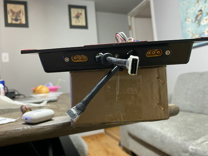

Some time later I fitted te board with AT, 21700 enclosure and a kaly 2020 2.0 deck and added @SeanHacker cable management panel

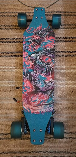

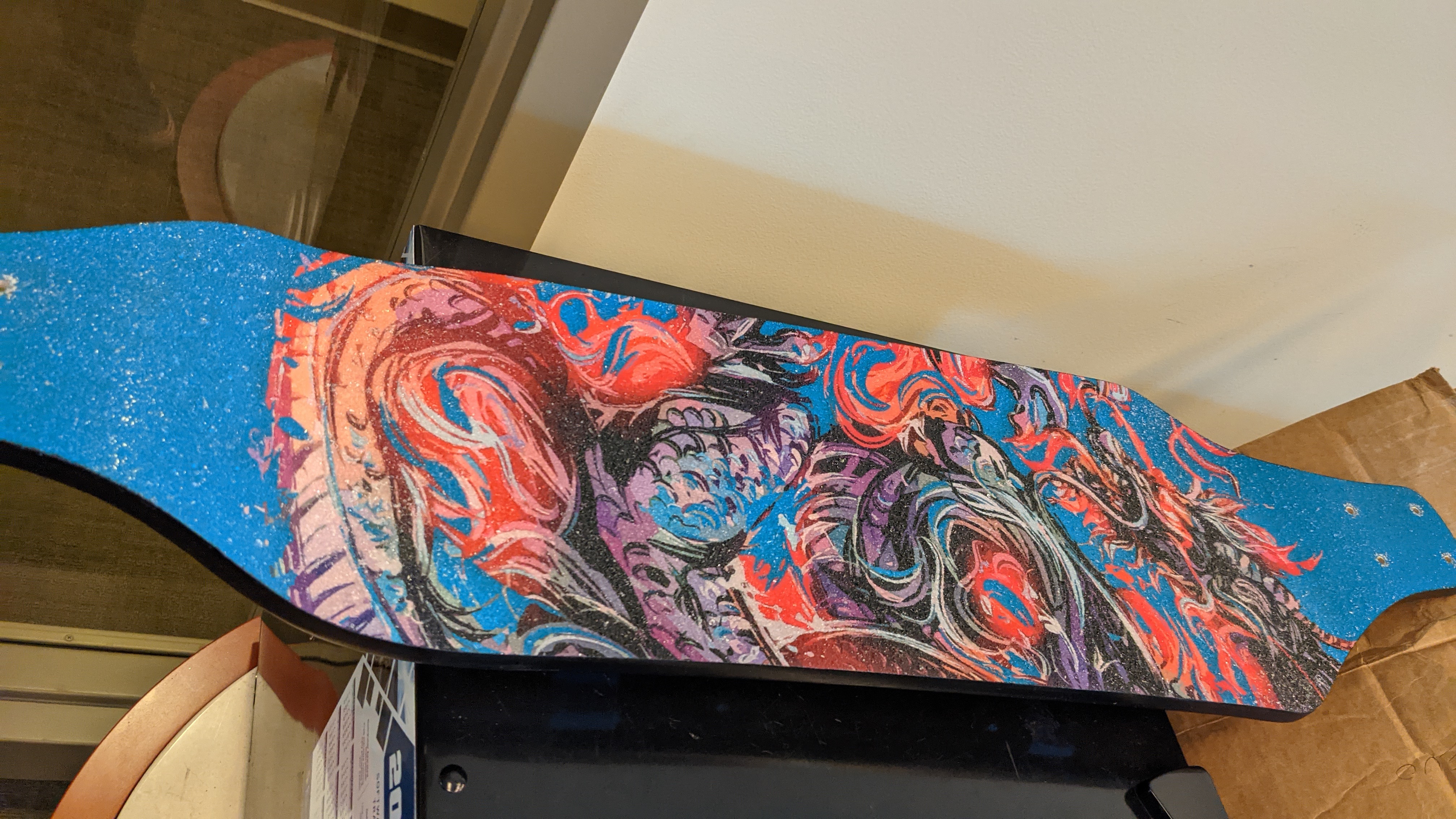

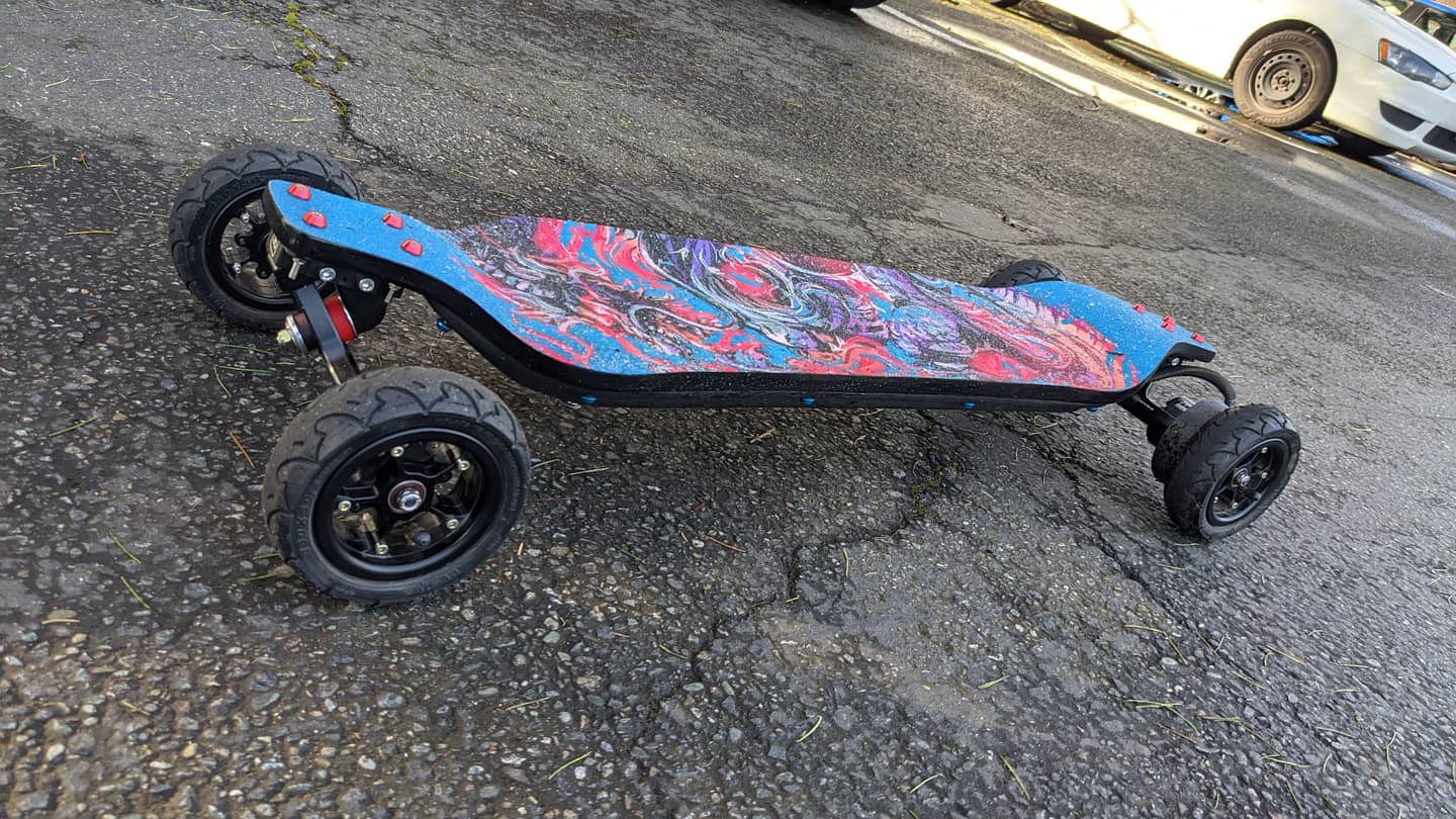

I had a kid right after or before this then decided to send my deck off to @Sender for some art and do a new drive train replacement. And why not a new battery pack from @BenjaminF
A23B5DFC-C2CA-463C-9554-97C0A973DB17
Then I had a unity accident :shushing_face: but had spare esc from just buying a bunch of stuff from @CiscoV

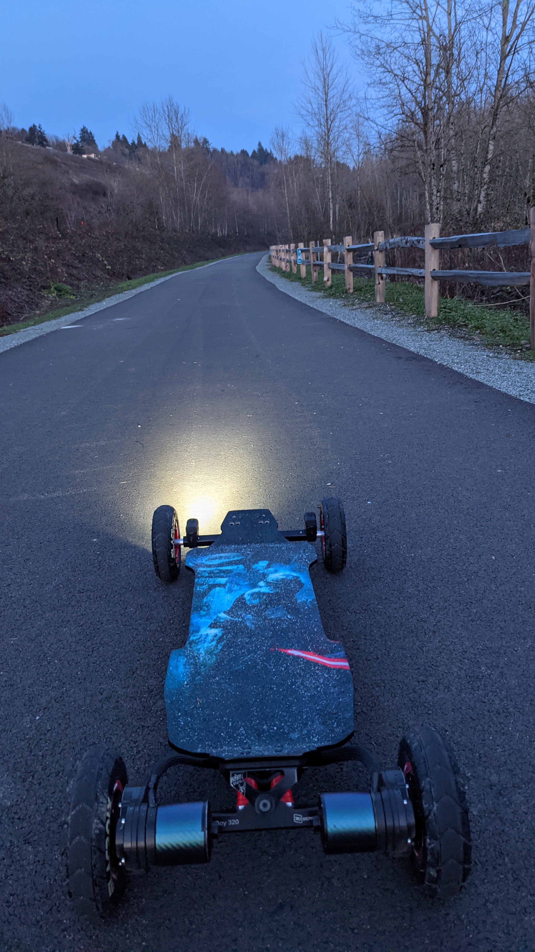

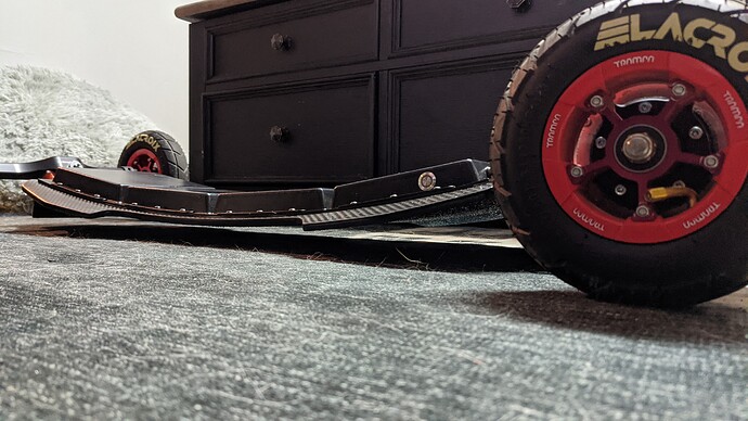

Here’s what the inside looks like now

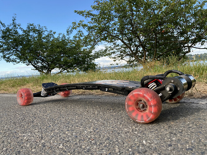

How she sits
All in all not a single thing stayed the same from the original board :sweat_smile: So rebuild complete yeah?

Where’d you get that slick motor can wrap? I think that’d look really nice with my oil slick trucks :eyes:
Promise to give you credit for the find
VViViD XPO Purple to Blue… https://www.amazon.com/dp/B071K99BLS?ref=ppx_pop_mob_ap_share

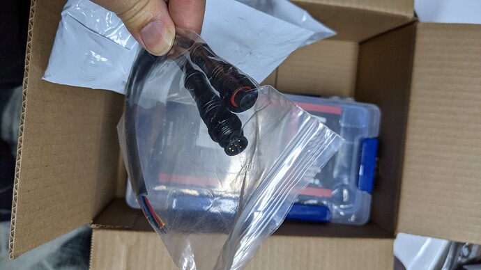

Next project is swapping the sensor cables with these and filling in the holes for the enclosure for them
Linked by @A13XR3
Buy here @b264
And maybe swapping back to a larger motor then these 230kv 6374
Let me buy the old shit
For real though, where can other people find those sensor wire connectors? :open_mouth:
Awesome build btw, I’ll add it to the Ultraboards hall of fame when you figure out a name for it :+1:
uxcell Pair 6 Pin Male Female Waterproof Connector Cable for LED Light Strips https://www.amazon.com/dp/B00X77LQ3I/ref=cm_sw_r_cp_api_glc_fabc_qQgdGbJ1MWZDK?_encoding=UTF8&psc=1

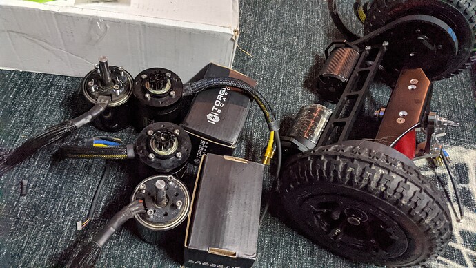

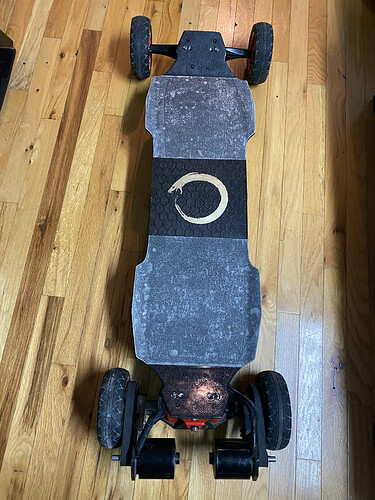

@Resonant parted out his board with a sweet evo falcon that was senderized
13s5p he built. Had a local friend remove a series. Add in a 12s daly bms. Picked up a Bkb Xenith and wires her up with my existing 3D Servisas gears that were on my carbon gt
Plans are to maybe get the trucks or hubs powder coated/anodized match the aesthetic of the colors :sweat_smile: and maybe reverse mount the gears inward for looks as well. This board will be my light weight funsy board to replace the carbon gt
As seen here

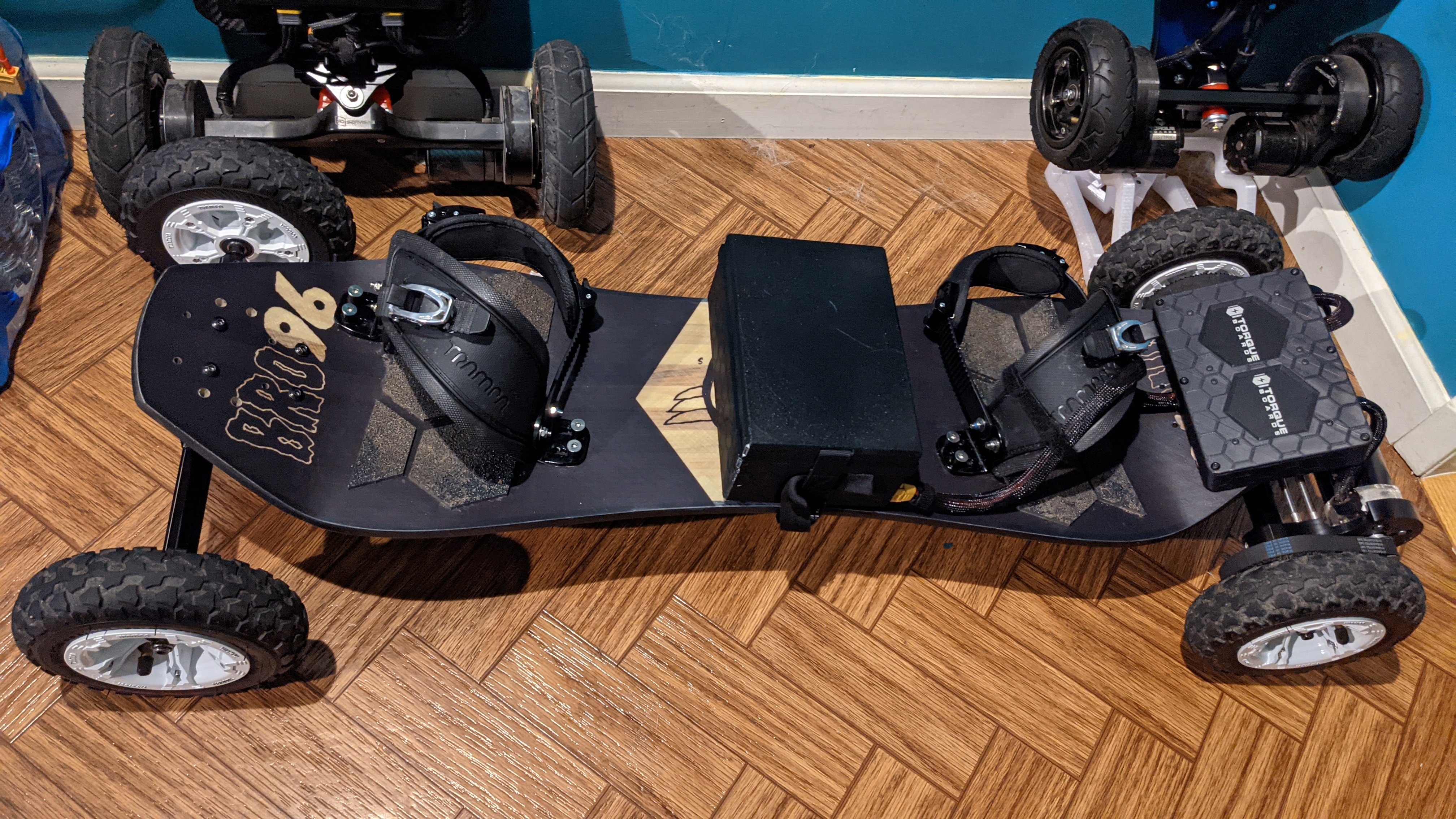

The haero bro
Haero bro deck (stiff)
TB6 esc
Metr pro
Trampa 6376 160kv motors
MBS matrix 2
Trampa bindings
Trampa phat ladz(2 set)
Primo alpha and strikers
ATC v1 mounts
14/62 ratio
Custom enclosures for esc and batteries
1 box 2 zippy 6s 6200mah
1 box 2 turnigy 14AH 6s
Battery box is held with a strap thats integrated into the lid and dual lock. Makes for quick swaps for if you want to carry another box with batteries already in it.

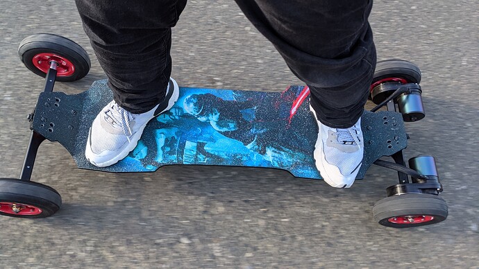

Test ride after adjusting my trucks from the carbon GT to this deck. Feels loose but that might be just from ridig the kaly and haero more the past month then this drivetrain.

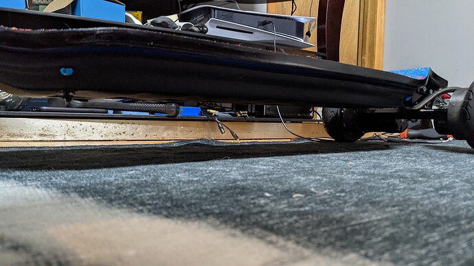

Setup for hfi cause I had the crimper and just connectors in the mail. Will be making sensor cables with those water resistant plugs this weekend.
Also adding some neoprene to one of these boards as well.
Haven’t decided on if I want to silicone pack or not.
