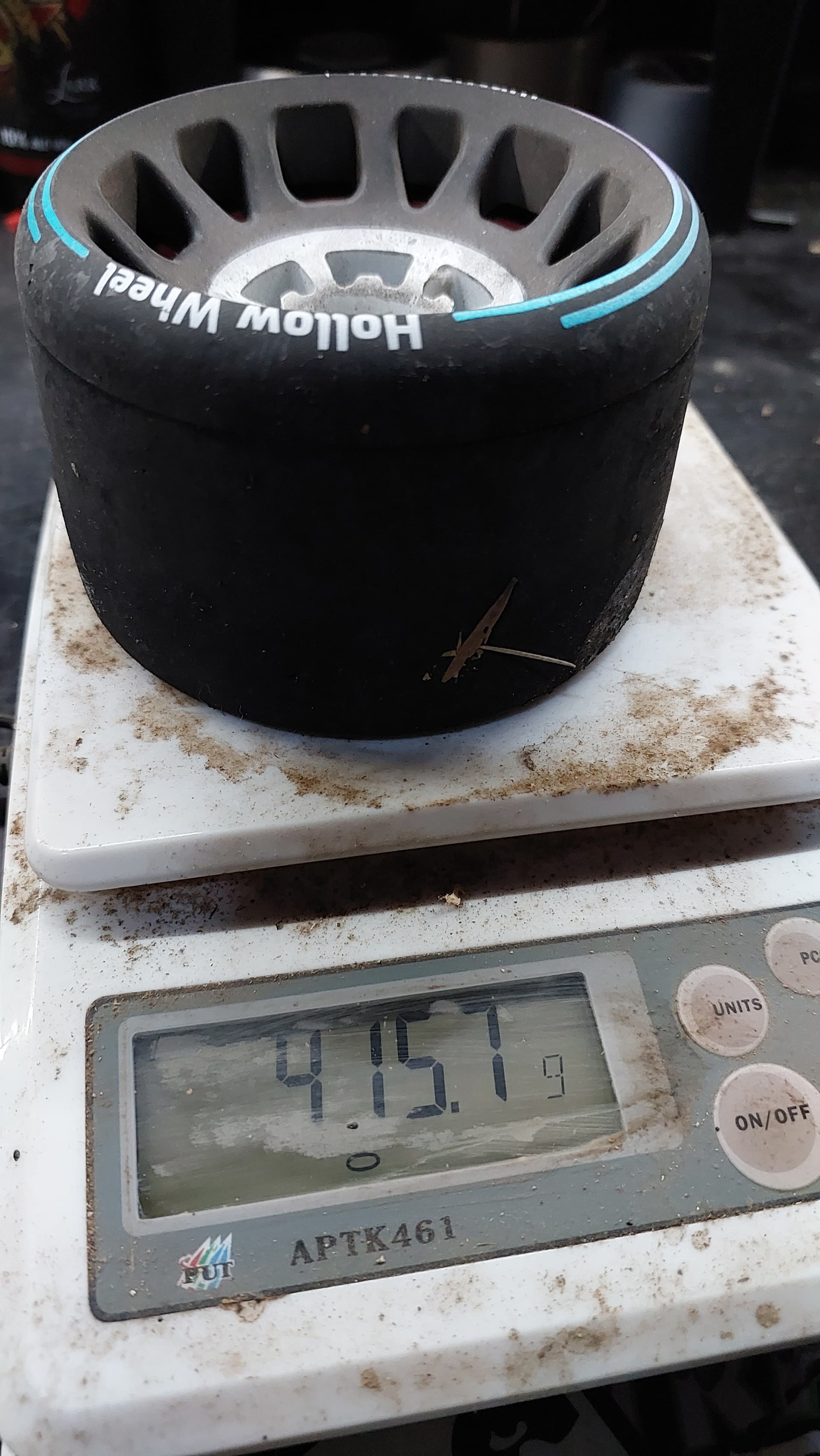

Just out of interest, whats the point of this wheel in your opinion? Where does it sit vs what’s already out there? Weight?
I knew that was going to be asked…
Momentum hollow wheel: (with full inserts)

I think their biggest advantage would be range though it’d be good to see different pulley options on the sakura hub, the phantom hubs now have different pulley sizes, 55t, 66t amd 72t but these wont fit some trucks
The only other product out there like this is the trampa ones, Gummies iirc… from what i read they were plagued with balance issues at speed. I have no first-hand experience with them tho but can say that ive not had those issues with the slime-wheel on their sakura hub.
The point of them is like any other airless wheel, no punctures to worry about, theyre a thane compound and many people like thane over pnumatic, ive ended up in that camp simply from the vast amount of punctures i had with pnumatic wheels on that deck. (150x50) so that peace of mind is nice.
