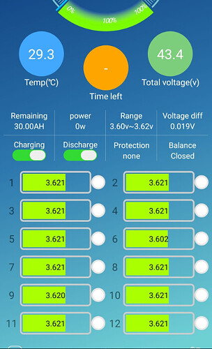

That is looking good, i set my first balance on a pack to .01 delta and then after a few cycles set it to .025v delta. It takes longer to get the smaller delta but let’s me see exactly what I’ve got going on and i take my good multimeter and check to confirm the voltages. You can calibrate in the bms from there but if it’s close I don’t worry about it and my readings have always been close enough.
I’ve been switching it to .025 delta after a few cycles because I don’t see any need to be better matched with how im riding and charging (sitting in the middle 85% of my capacity usually). Seems to be working fine so far. I charge to 4.17 then it balances and settles to about 4.15ish, I live at the top of a hill so i keep head room so i can break hard on the downhill heading to the trails around me and usually get home with 15-20% minimum… also because hills

Your LLT BMS can tell you how much charge is left, if nothing else… awesome you’re finally done! Eager to see how it performs.
Right, I should’ve mentioned that, I can check the battery with the phone app but that’s not ideal while riding. Until I find a constant monitoring solution, this is what I’ll have to do… stop from time to time and check the app.
