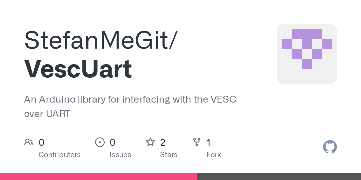

, I’ve made my own rf-nano based remote roughly an Arduino nano and rf module in one. You can use the Servo library and specifically the Servo.writeMicroseconds(1000); on any pwm capable pin (you set the pin when initializing the servo object)
If you share some code or point to a repo can take a look too. There are also ways to do uart communication with the vesc but for simple control of throttle the ppm/pwm signal is good enough.
You are trying to have an arduino control VESC throttle via buttons? or analog input?
Few ways to skin this cat, depending on what you are trying to accomplish.
It sounds like you’re trying to have a pwm output from the Arduino connect into the VESC, and read that as throttle input? You can do that, but ensure that you have the correct PWM output range coming out of the arduino (there are a few servo or PWM output libraries built in), that the correct pin output is connected to the pwm input on the arduino, and that you have the correct pwm/ppm app input selected on the vesc-tool.
It might also just be easier to directly connect the arduino to your ESC via the UART port.
The UART port on VESC-based ESCs will have a tx/rx/gnd/5v line which can be connected to your microcontroller for power & comms. There are some great open source arduino libraries that make controlling VESC-based ESCs that much easier.
Let’s see what code you’ve got so far and we can dig in a bit more.
