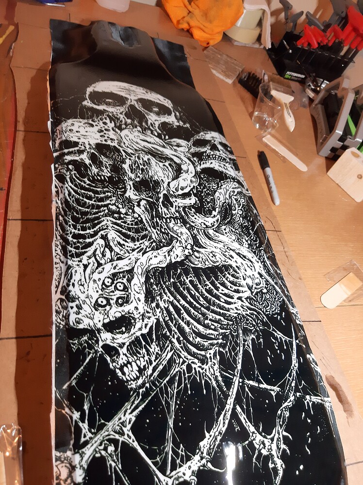

Aesthetics
The theme was inspired by my go-to beer while building Kurby.
I searched for a decently hi-rez image of it, but came up empty handed. @Zach’s build reinforced the fact that I wanted a black and white build. I searched near and far for something that stood out, then ended up in a Vice article about Mark Riddick, a prominent death metal artist, and this jumped out.
I brought it into GIMP, resized/cropped/upscaled to the best of my no experienced abilities and ended up with this.
My due diligence to keep the image within the dropdown paid off :partying_face:
I definitely owe the artist a good bit of beer. I plan on contacting him, and other artists I fancy, to try and purchase runs of skins :crossed_fingers:
Anyway, onto the fun. Let’s skin this deck!
It was my smoothest fabric skin yet which was helped by the large skull was the main thing that needed good alignment. I went with my go-to full ham fine frit: once you think you have enough… add more, wait a bit and add even more.

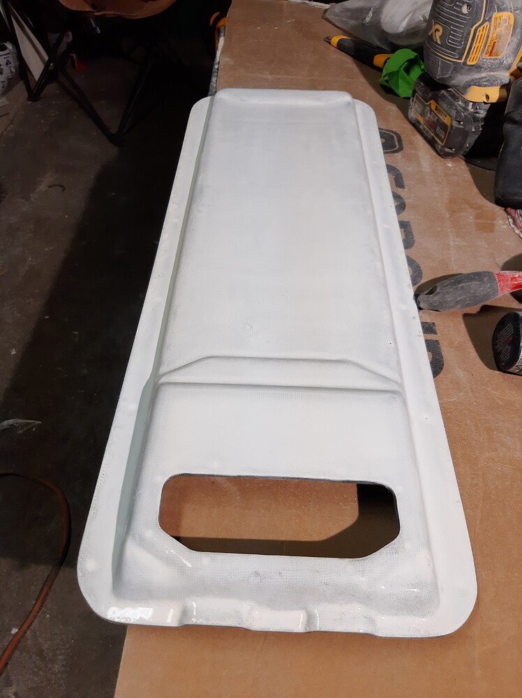

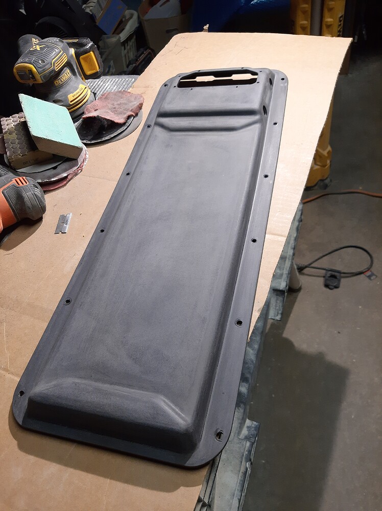

Despite the TB enclosure being a solid 5mm, I still wanted to reinforce it since it’s ABS. Since reinforcing the deck was my first foray into fiberglass, this was a learning experience…
This is where I missed a key step while researching the process…
I skipped the peel ply and breather layer :woozy_face:
Don’t worry, @glyphiks and @rosco were there to laugh at me again :rofl: Deservedly so
I quickly cut the vac bag open and went to town with a cup of acetone and a brush.
That move saved me quite a bit of sanding that was needed to fix my bonehead mistake.
Though, in the end, the mishap caused a decent bit of sanding and an extra coat or two of resin.
In the end, it turned out.

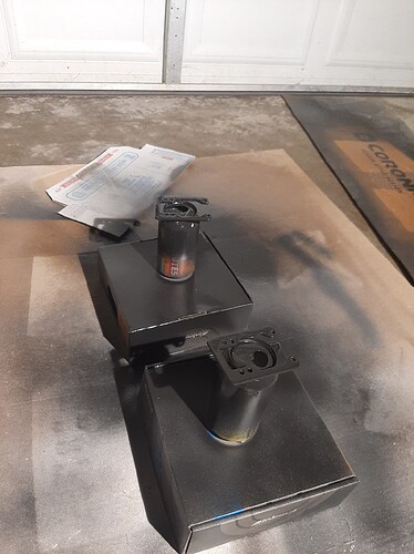

Deck paint was an excursion. I tested 3 different sheens of black and 2 different clearcoats.
I settled on flat black with a gloss clearcoat. I feel it gives it a smokiness with an added depth to it.
Time for clearcoat!
Backing plates needed paint and clearcoat
(Green orings got swapped with black rubber washers)

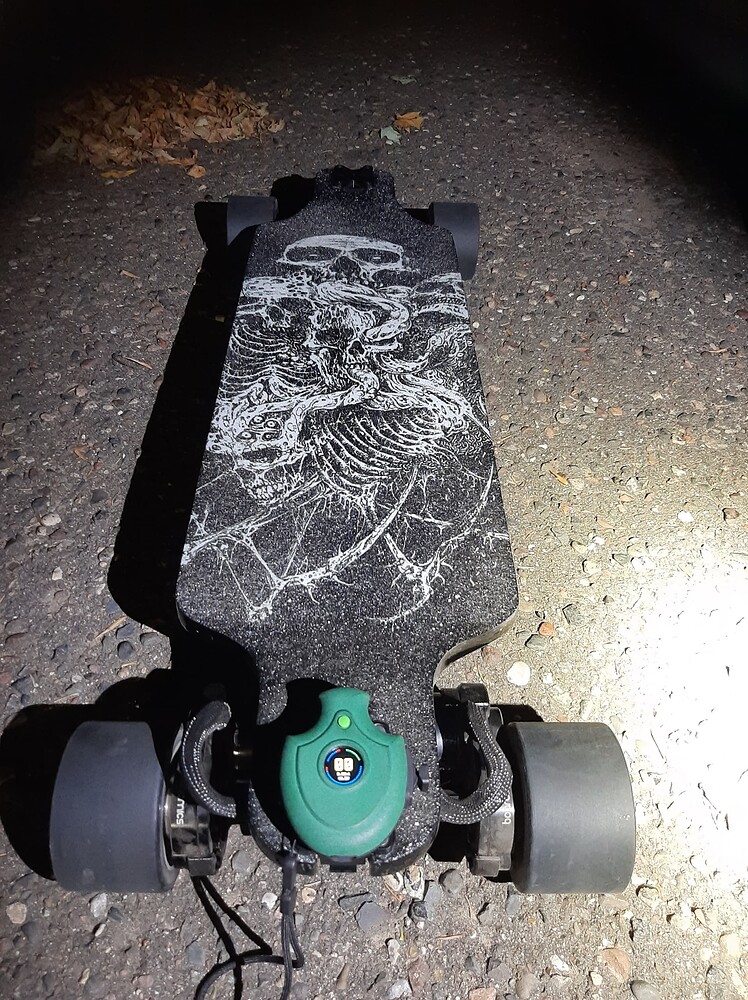

This assembly was a bit smoother than my first board. There was much more room for all the bits and bobs. My end goal was to have it ready for the Halloween group ride in the middle of October.
Swapped from helical to straights
Worked on getting cleaner at soldering
I had to leave plenty of room for telemetry and OSSR receiver soon to come
Once again, the maiden voyage was at around 330 AM. Felt damn good :partying_face: :beers:
Got some sleep and went out and met @whaddys and @Posterduck for a ride the next day
Got some decent miles in that day feeling out the new ride. The deck wasn’t love at first ride like Kurby was, but it showed potential. In time over the fall, I’ve grown fond of it and can see a quiver spot for it.

I’ve grown accustomed to the board over fall. The extra real estate that it lacked was found by utilizing the rear dropdown as a foot ramp while getting to upper speeds. It is pretty much a full stiffy, my FG work may have played into that a little. As of now, I have it set to 50/50 for ride height symmetry (sake amongst other reasons). The carve of the angles is fun, but I get a slow oscillating wobble around 36mph(58kmh). I’m unsure if I’ll mess with lowering the rear angle or not. The rear steer of the 50 degree baseplate is weird, but it is fun as well. Clearance issues will make me be creative if I do want to drop it.
Anyways, I had some good times on it already, and look forward to get some more miles rolling once spring rolls around. Stoked to have filled another spot in the lineup.
