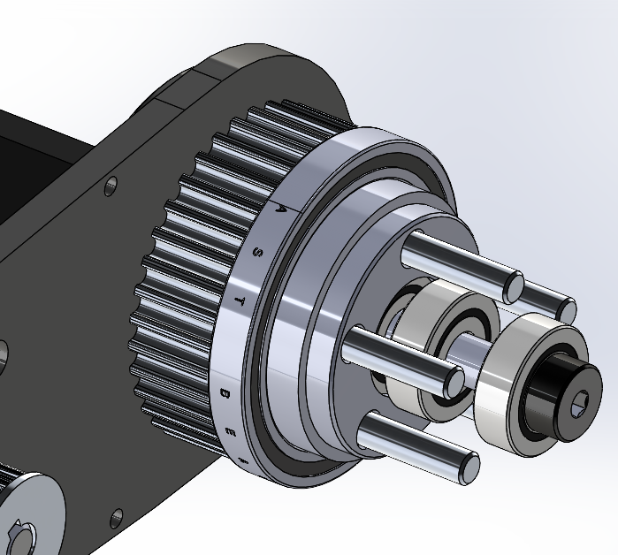

Seeing as gears are evolving quickly, I chose to give belt drives some hope. Want to get some feedback on my sealed belt drive design, my attempt at the best belt drive possible.

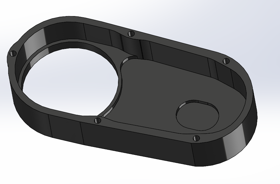

My sealed belt drive starts with a press-fit adapter for my BN220 trucks. I can make adapters for other trucks later. A familiar looking mounting plate holds the motor. The inclusion of a case makes this belt drive special. Utilizing a 6809 RS bearing to provide a splash resistant seal, it provides less drag and greater drive rigidity than a rubber seal.
Overall, this drive combines the best scenarios for a belt drive, both in terms of performance and longevity. There is a high level of ridigity within the pulleys. No slop. The pulley alignment is excellent due from precision machined components vs cast. The belt is sealed from moisture and debris, a big cause of premature belt failure. There is no idler to wear out the belt quicker.
Wheel pulley is fixed 36T (no adjusting this). Motor pulleys can range from 14T to 20T, making this a more high speed drive designed for dual configurations. Motor pulley is steel with keyway.
Belt will be 15mm wide HTD5M Kevlar belt. Kevlar’s weakness is wet environments but has strength advantages over fiberglass.
Some facts about the drive:
Uses a 6809 bearing to seal
Only has kegel adapter for now
Utilizes a press-fit mount
All parts are machined aluminum
The case is 70mm in diameter at the most. Good clearance here!
The wheel can be removed without removing the gearbox.
Let me know what you think. Just getting my thoughts in 3D for now
Price is more expensive than usual belt drive, but cheaper than gears.

I like the idea, I’ve always looked at Trampa’s sealed belt drive and thought it was smart. Clearance is the issue though? One of the biggest selling points for me of belts is the low profile.
If the case makes the drive even more silent, then this could also compete against helical gear drives :sunglasses:
The gearbox diameter at the wheel is 70mm which gives it similar clearance to a 40T wheel pulley. Also worth noting that the 70mm length, unlike a direct drive, does not run along a motor cans length. Only 25mm or so.

This sounds so badass until I read the gear ratio is maximum 15/36 (or 14/36 if you want to use 14T)
:sob:
This is EXACTLY what I need when there is a bunch of snow. Snow breaks belts like they’re defective toothpicks. I’ve broken two belts in the space of 5 meters before. This would completely solve that
14/36 isn’t enough torque for you?
I can probably bump it up to 38T maximum but that is about it. Anything in the 32T-38T range is fair game. @b264 44T would make for an insanely big case. Without a case, that is already around 73mm belt included.
I will probably have a 38T maximum wheel pulley version for urethane only, then a small AT wheel version as @Chaki suggested that would have something more like 55T
No, and I don’t like using 14T HTD5M pulleys
14 isn’t enough bend radius for me.
What’s bend radius?
how tight the curve is. The belt has to bend around the motor pulley, and the tighter the bend, or lower the bend radius, the more strain is put on the belt. The difference in belt popping between a 14T and 16T pulley is not negligible.
