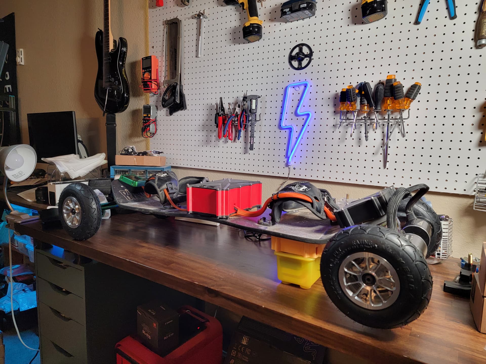

Anyone have a pic using the M1-AT GD with 63100 on matrix 2 trucks? I think I’m going rear mounted on a flux board. Curious if they clear the trucks and what angle is needed.
@ShutterShock
I know that dual 63100s fit on Matrix 2 with Moon drives, so they definitely should on the slimmer M1 drives
I wasn’t using 63100 on mine but this is what 6384 looked like
Also, FWIW the drives are fixed angle now, so they should work. On my set, they were the first set of AT drives and have multi-angle. So what you see in these pics is some grinding where my motors hit the baseplate. I believe that got fixed
