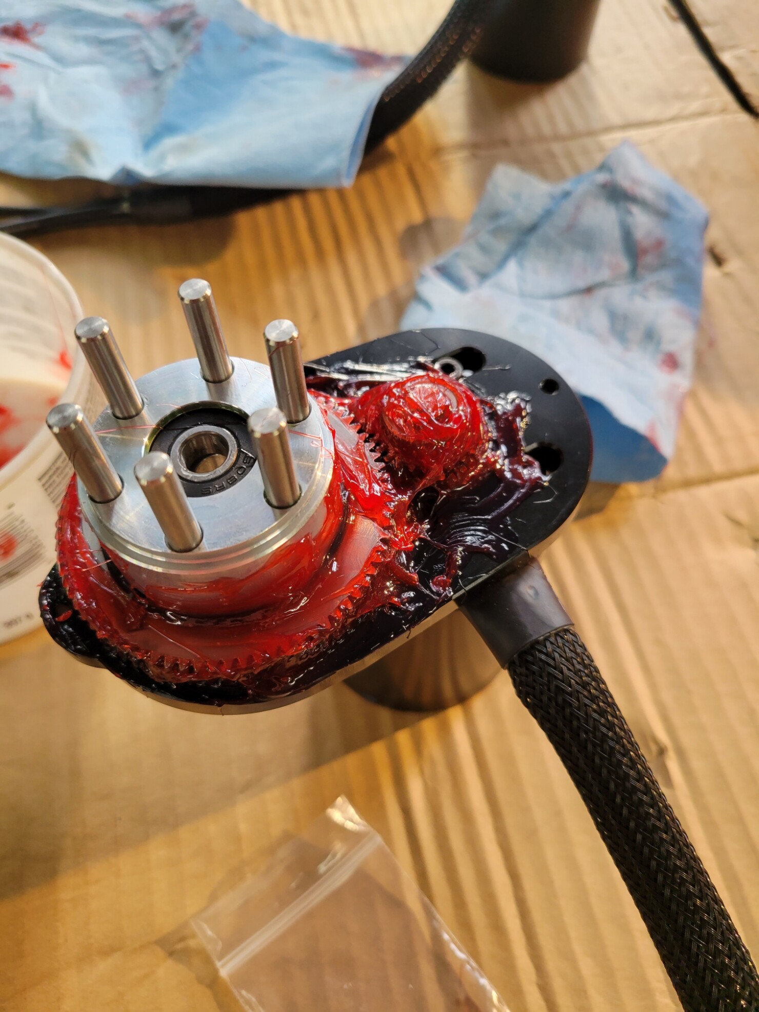

I recently overhauled my drive train with dual gear drives, hangars and adj baseplates from boardnamics. I have probably 200 miles on the gears now, and the original loud gear noise is mostly gone at lower speeds but something else is happening at high speeds. When I hit about 30 mph the board gets significantly louder and higher pitched, as if there is some resonance. It almost hurts my ears in the mid 30s and it honestly sounds like it might explode. it doesn’t happen gradually as rpm increases, it seems to suddenly get very loud and very high pitched. My brother said it was screaming as I passed him at ~35 mph
If this is normal for all gear drives, so be it, but if mine are acting up and there is some way to quiet them down at above 5000 motor rpm I would appreciate tips.
more details, dual 6384 fs battle hardened motors
12s3p p42a battery
xenith vesc set to 76 amps max using 23.46 fw

do you have straight cut gear drives? they happen to do that on the BNs
you coul soften it by adding grease
helicals also do it, but not as loud
no I have helical cut gears from the most recent drop, and I have red grease on them
you could add more grease, it’s just red n tacky grease
or adjust your backlash
how do you have that set? any pics/videos?
I added a lot of grease when i assembled it, given that there has been next to no leakage, there is still a ton of grease in there. There is a good click when i turn the wheels. I think the backlash is fine
the grease tends to go into spots where it’s never touched again, maybe try to add more
(btw it’s completely fine that they hit that resonance, likely due to teeth size + gearing ratio)

that backlash looks too loose

I think you maybe need more grease
I think we got the same thing. Mine make a ear piercing screeching noise that will hurt your ears immediately. I got 400+ miles already and it was doing it with helical and straight cuts. After hundreds of miles of putting more grease or running with minimal grease or adjusting backlash it will never go away. I have a feeling that metal shavings got into the motor and thats what’s causing it but with opening the motor and cleaning everything Its still there. Just my best guess but not sure. We are both running flipsky motors :man_shrugging:
