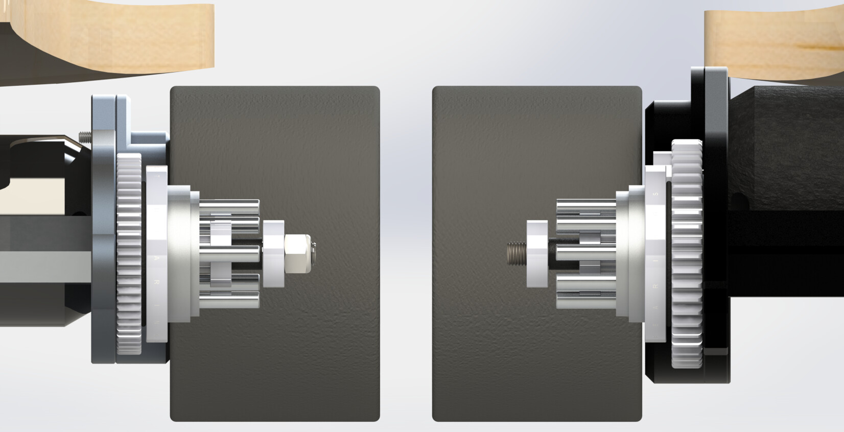

To make a virtually silent gear drive would require almost a complete redesign. The helical implementation was an attempt to lower the sound. They’re still pretty loud for several reasons:
The teeth are not ground. They’re commercially hobbed. Not that smooth. This is why the sound decreases after some use. They must break in.
The gearbox is not very rigid. Not made to nearly the precision of your average car transmission w/ ground gears and steel shafts.
There are a ton of size/cost limitations that make producing an ESK8 silent steel gear drive difficult. Increasing the helix angle would certainly cut noise but our motors aren’t designed for this. The best approach for our application is a POM wheel gear. The M1 drive wasn’t designed to be super quiet anyways :stuck_out_tongue:
Moving forward, I think I will do 2.20 ratio straight cut only and 2.78 helical only.

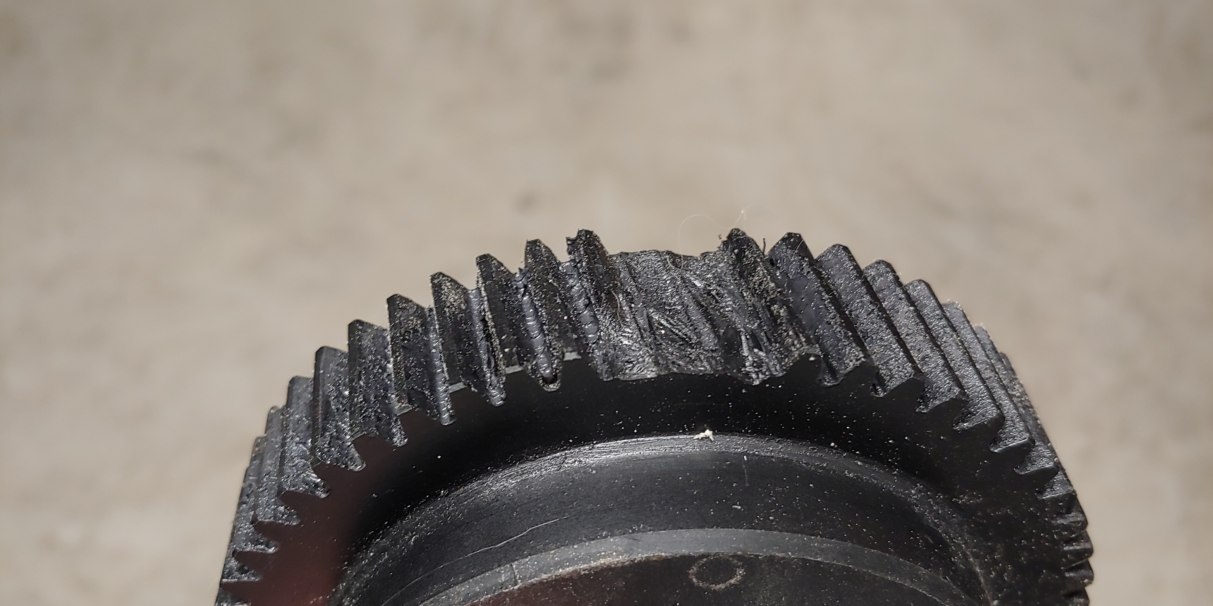

POM gears are excellent in nearly all cases. The only weakness they have is shock loads. It seems people break them when there is an unexpected surge of force such as jumping on an eMTB and landing, causing a huge change in speed. POM gears are much more forgiving to misalignments and do serve as a “weakest link” before something more expensive breaks.

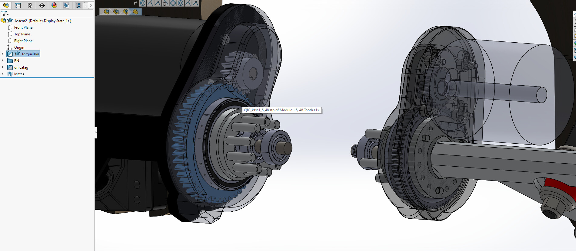

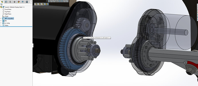

It’s not as easy as changing the material to POM.
The gear size would have to increase greatly. Id have to go mod 1.5 and around 12mm wide. Much quieter but I can’t fit those gears in this gear drive. Every part would have to change.
ahem
not allll of them. Same M4 screws for one!

POM gears are great for keeping the replacement costs down.
Not a Boardnamics gear:
But if you’d prefer to just avoid replacement and front-load the costs, then I beg to differ. :crazy_face:
So what you’re saying is to make Boardnamics POM gears, then charge $50 for replacements? Sounds lucrative, thanks B!
Better yet, you can just charge $10 less than a whole brand new gear drive, and it’s still better just to replace the plastic gear than change the whole thing, which is $10 more expensive and more labor.

The only time I have had POM gears fail me is when I locked up motors at 30mph due to spintend spontaneously combusting or when I slammed into the side of a curb at 45mph. The rest of the time they have been great.
