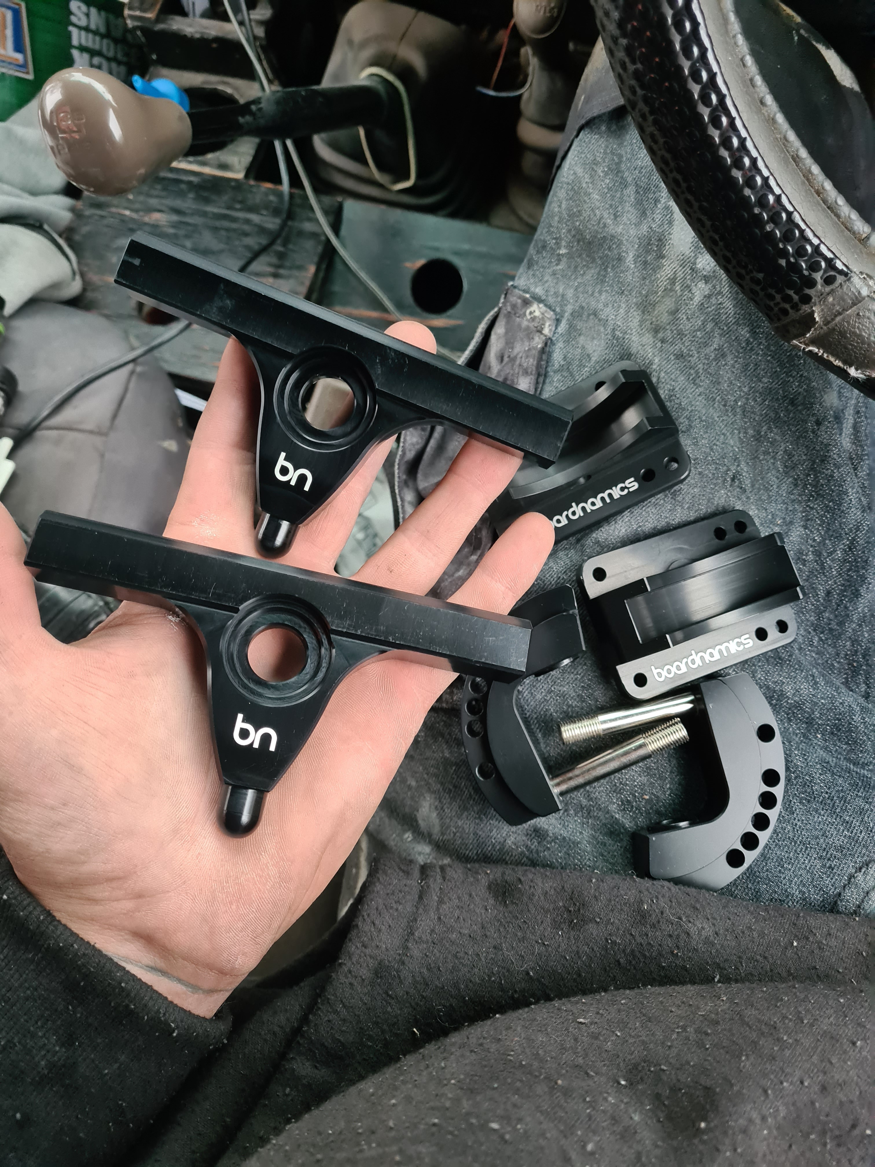

These little beauties came today :star_struck: did we ever find out if these can fit dual M1s with 6355?
they should, they should!
So all good, bro.
