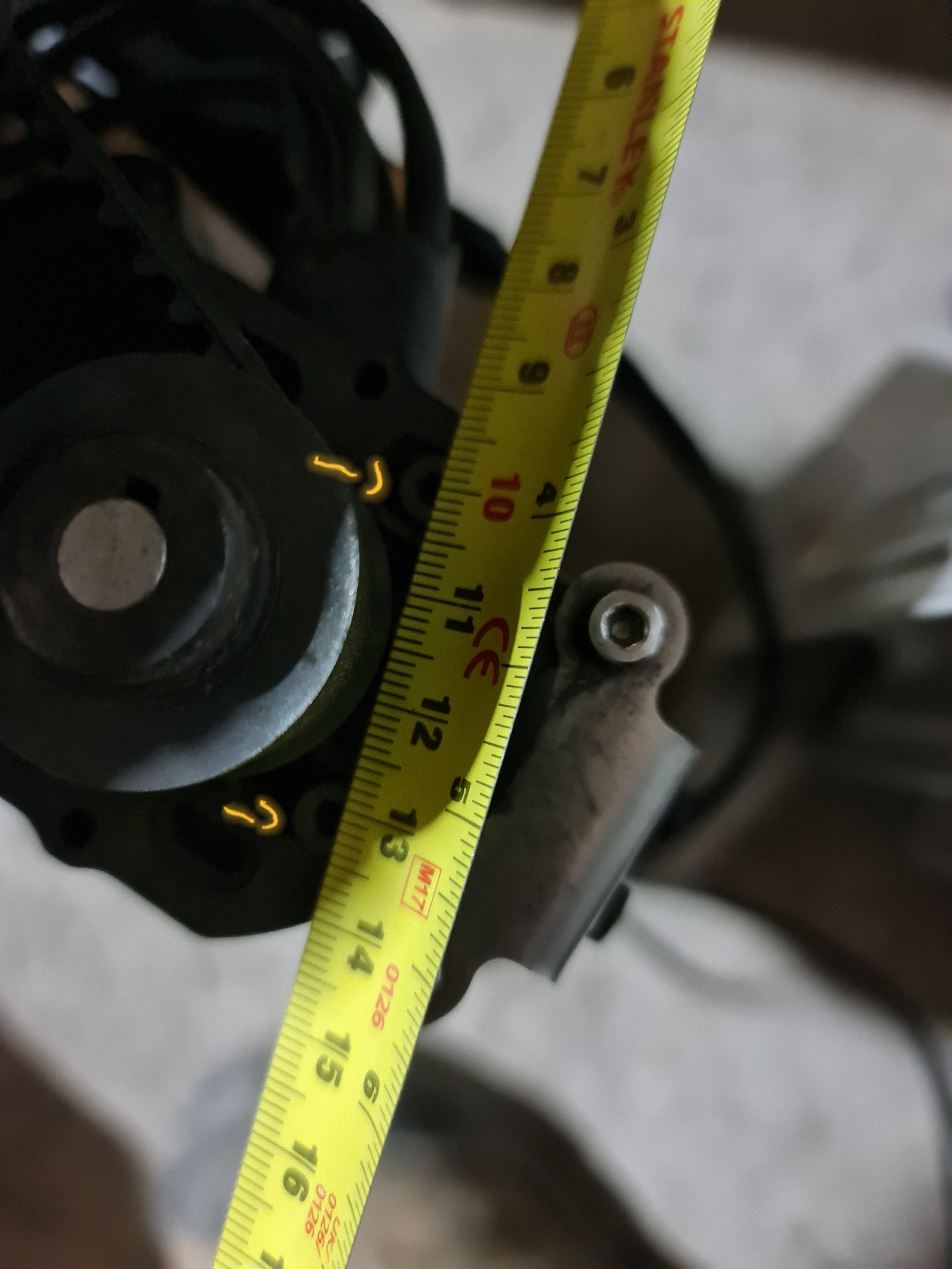

@Boardnamics can you measure this?
I think they teach you how to do this in high school. Idk I’m still in kindergarten.
@Fosterqc @b264 thank you.
I am asking because the current motor bolt pattern doesn’t fit my mounts correctly, and when i read 44mm it didn’t quite click in my head.
Motors should fit without problems :smile:

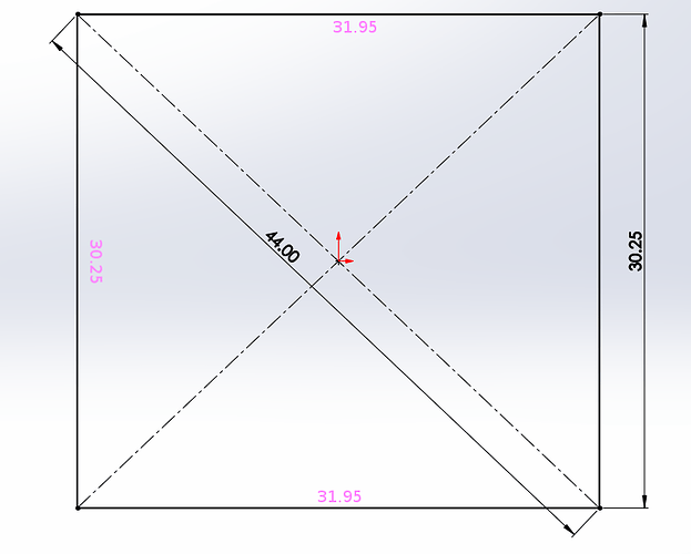

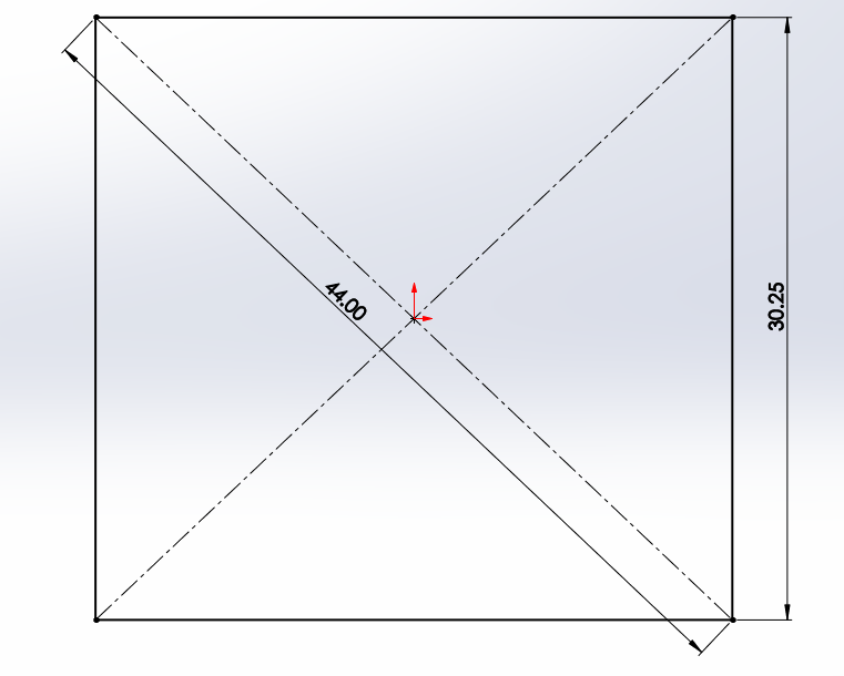

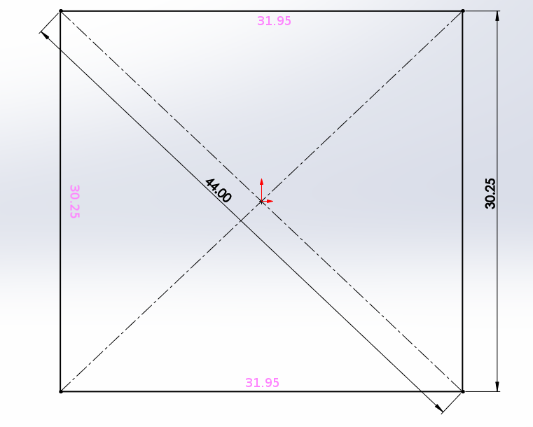

I am not very good at this

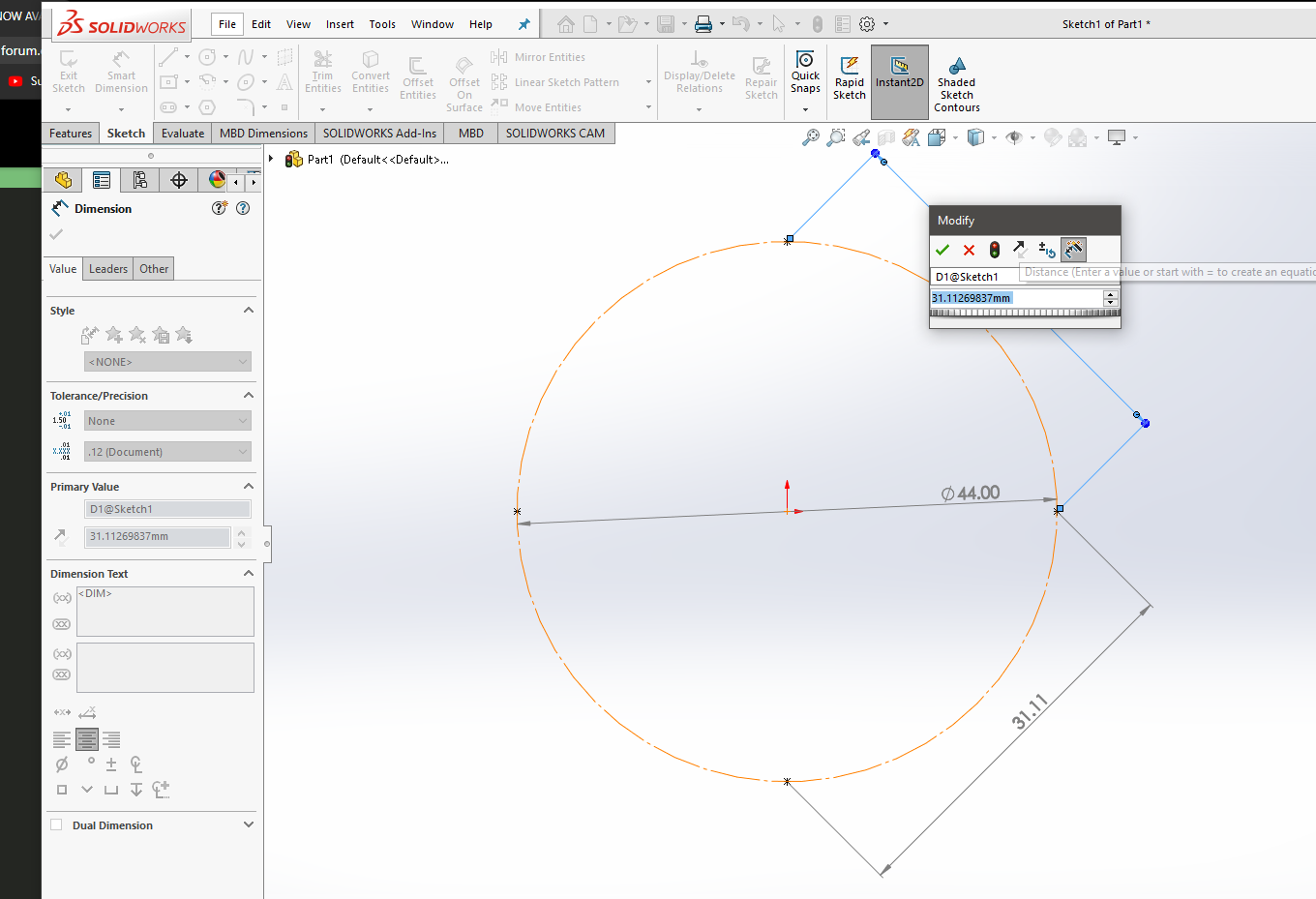

Something about Pythagoras, he did the hardest work there
22 multiplied by sqrt2 is 31.11 :thinking:
i see what I did… damn non snappy squares
