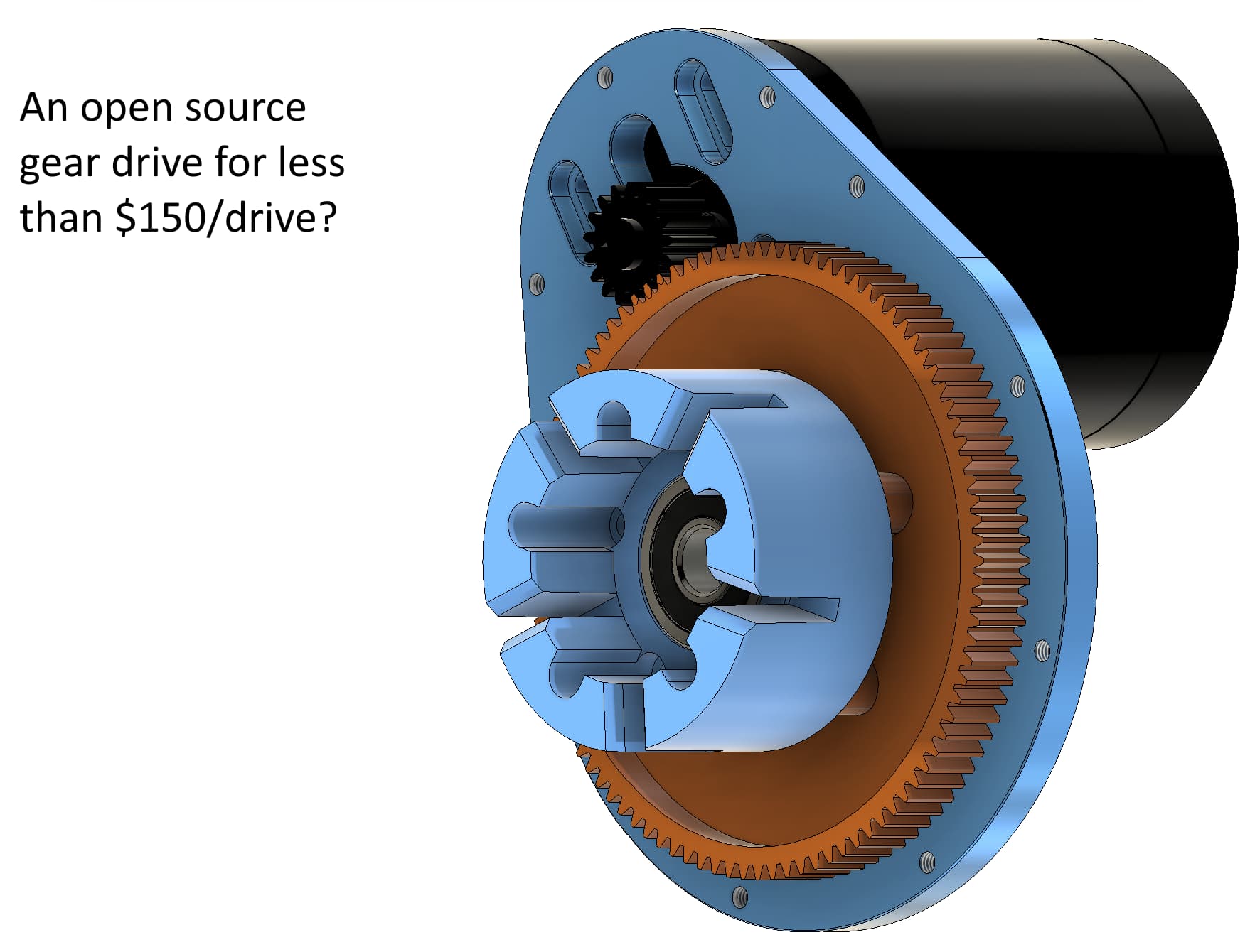

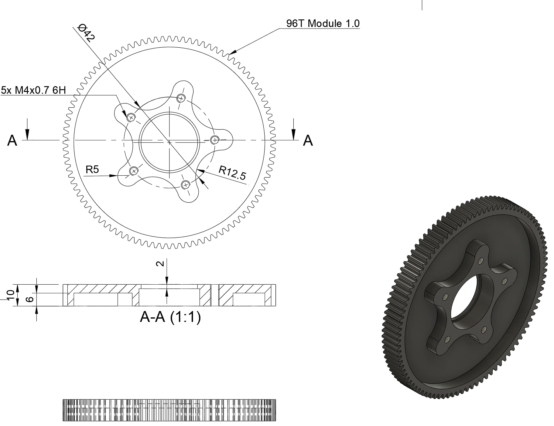

Very cool. You can probably get away without using case hardened gears for the wheel gear if you were trying to reduce costs.
Hehehe
Can I ask you to expand on that?
It was a consideration in our closed beta group, but I ended up finding a mfg that specializes in gears and machines custom ones that are by default case hardened
