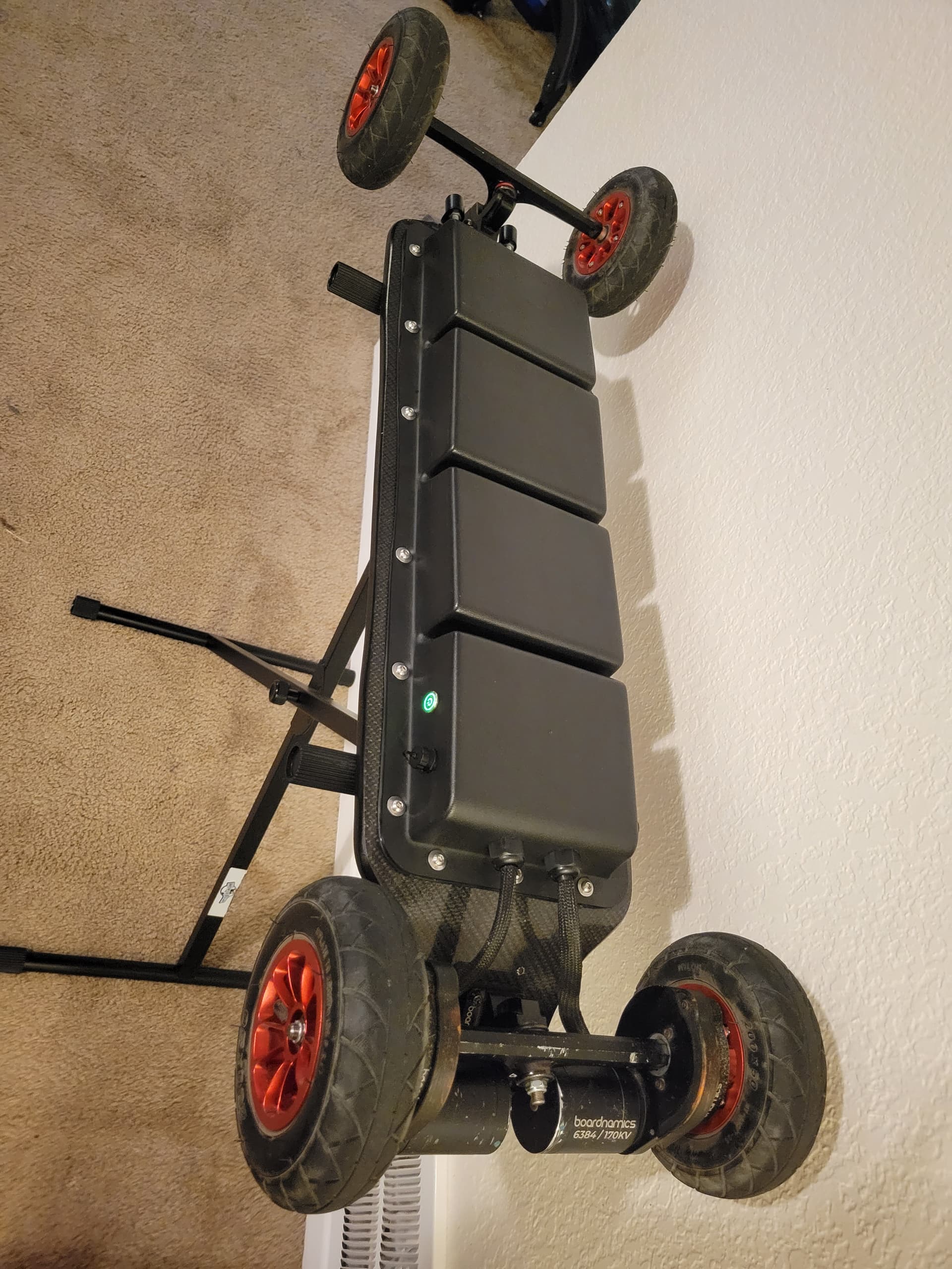

so today was the real test with my new board ! , and i am very happy overall (its scream once vtech kicking !) but the only thing i really notice is the weight of gear drive affect the stability of the board at high speed its not very stable , let me explain, on my previous setup my mountainboard on chaindrive was maybe 1-1\2 pound and this geardrive is maybe twice the weight so i have to upgrade with the red bushing (matrixll) . i start to feel small wobble at 40 to 47mph and i was at 50% trottle i think its to dangerous to go at theses speed anyway , i don’t blame the geardrive, its just a observation , its feel tail heavy and to solve the problem i will not going above 40mph , this setup is for top speed and act like a big turbo with lag but once you get 30mph it scream and be prepare for the boost but you all ready at 40mph and you feel the tail no following , maybe a damper like my sportbike can help to reduce the wobble but it think like a say previously i will stay below 40mph and stay alive :rofl:
just to remember my setup is 3.95 ratio with 6384 190kv at 18s , 100A motors current ,90A max battery
Interesting I never thought about how much heavier the gear drives would feel. Will you try to play with angles for more stability, what are you running now?
Still not sure how the gear drives would cause the wobbles even if it’s heavier. I wonder are your wheels balanced? At those speeds it probably matters more…
the deck is mbs COMP 95 Deck Tip Angle - 30
they are not balanced , but i feel a little shake at 40 to 47mph

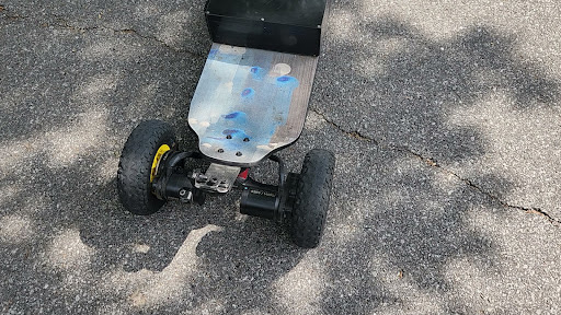

running 3.95 helical with 6384 170kv on 12s… top speed exactly 40mph with 8 inch wheels. more torque than I need… it’s a perfect setup. in the process of upgrading to a tomiboi deck+12s8p battery

wow nice work , the wheel , the deck , theses are the AT trucks from boardnamics? i am not very familiar with other mtb products ,
btw the setup you have is great to get top speed on 12s but on 18s is just to much even with 170kv , mine are 190kv and they heat up a little bit but i iam not to much agressive with the trottle they are just warm not frying, also you got balls of metal at 40mph without binding .

Thanks man! Yep, Boardnamics 270mm trucks. Going to switch to these Luna 350s though, I was getting some wheelbite with the BN270s. Just waiting on truck adapters.
