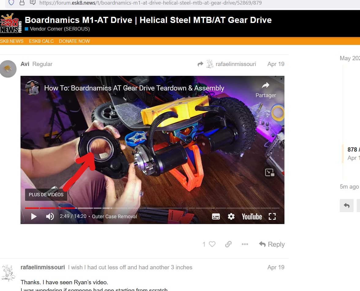

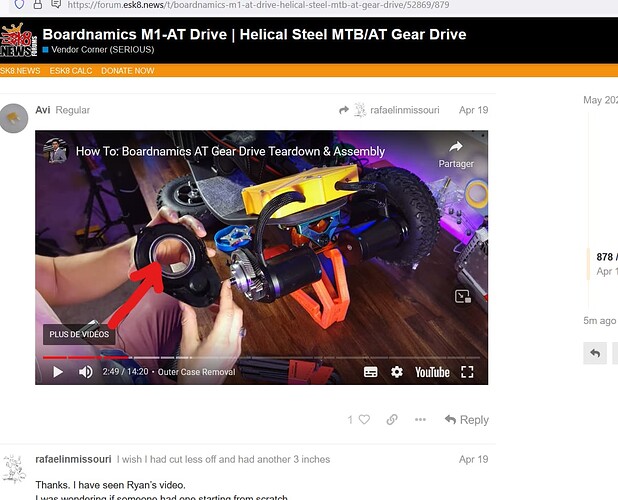

l found the problem !! the bearings are missing ! ShutterShock save my live again! , it time send a email to boardnamics .

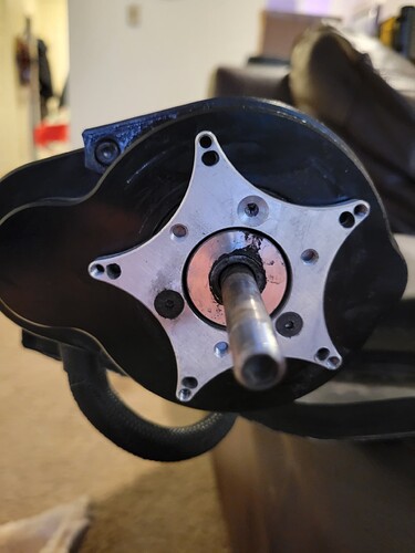

Anybody got some tips for getting these drive adapter screws out? Trying to switch to the new ones. Can’t seem to get any more of them to release, even with heat. Also the adapter just spins when I try to loosen, makes it super annoying. Worried I’ll strip them…
Could put a clamp on the gearbox to keep the star from moving.
Did this. Seems to make it a lot easier. Although I stripped one :sob: any advice besides dremeling a place for a flathead?
Damn, sorry. Easyouts/any good extractor set might be the next step. Other option, sometimes you can pound an oversized torx into a hex hole
What loctite did you use on them?
Came pre-assembled… the residue looks red though on the ones I got out. Definitely doing blue for the new ones. Fuuuuuuck I hate stripped screws
If you’re going to replace the star anyways, then don’t hold pack really grinding down the screws.

gently tap a slightly oversized torx
:sweat_smile:
And heat. Be careful with heat tho, as it could easily melt the rubber seal on the big bearing of the case. One of those little jet lighters directly onto the screw would prob be ok
