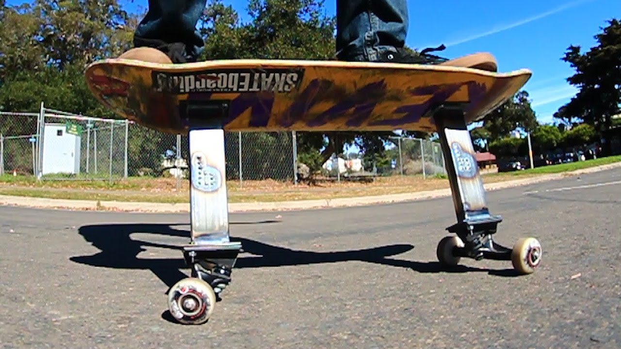

Just keep adding half inch riser till you’re clear bro lol
