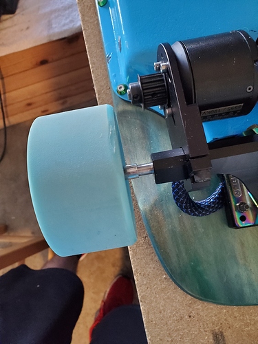

Yo has anyone had this happen before, I have @Boardnamics 184s and everything was great until I tried to take a shoulder bolt off and it was so tight I thought it had completely seized. I’ve managed to muscle it to this point and it’ll still turn but the bolt won’t come out. What the fuck is with that?
Might be a pressure seal? You can roast the aluminum and hope it expands or drill a pin hole into the void space at the ends of the tapped hole
It’s been roasted, this is some bullshit
Make sure you’re only heating the aluminum, if the steel gets hot and expands too it’s not gonna do much good…it’s not like there’s gonna be rust to break away
Poke a hole in I guess, unless you wanna cut the end of the bolt and thread it…have a permanent axle
Lol I don’t wanna cut, drill, anything like that. Just want the bolt to work like it should
Probably a pressure seal. They fit really tight, which is great imho
I’ve found not to overtighten the shoulder bolts as well. Just rather snug is perfect
Any tips to break the seal? The suction seems extreme. Like I’m malleting this bitch and it’s not budging
And there’s no threads engaged anymore
Note taken: don’t screw in the bolts until I’m 500% ready
What mounts would you guys use if you can’t remove the bolt? :thinking:
Put that shit in a vice and get in there with pliers… Or maybe try and lube the bolt and slide it back and forth to hopefully lube the whole thing?

Try loosening the motor plate clamp. It might give a little more wiggle room in the aluminum.
Did both, vice didn’t work, and it won’t go in any furter. These suck

You know that the shoulder bolt can also contribute to this
Well fuck whatever the shoulder bolt is lol, gonna take it to a machine shop tomorrow and hopefully then can do something. I’ve never seen something this tight, I can barely turn it anymore
Maybe a fucked thread?
Possibly
