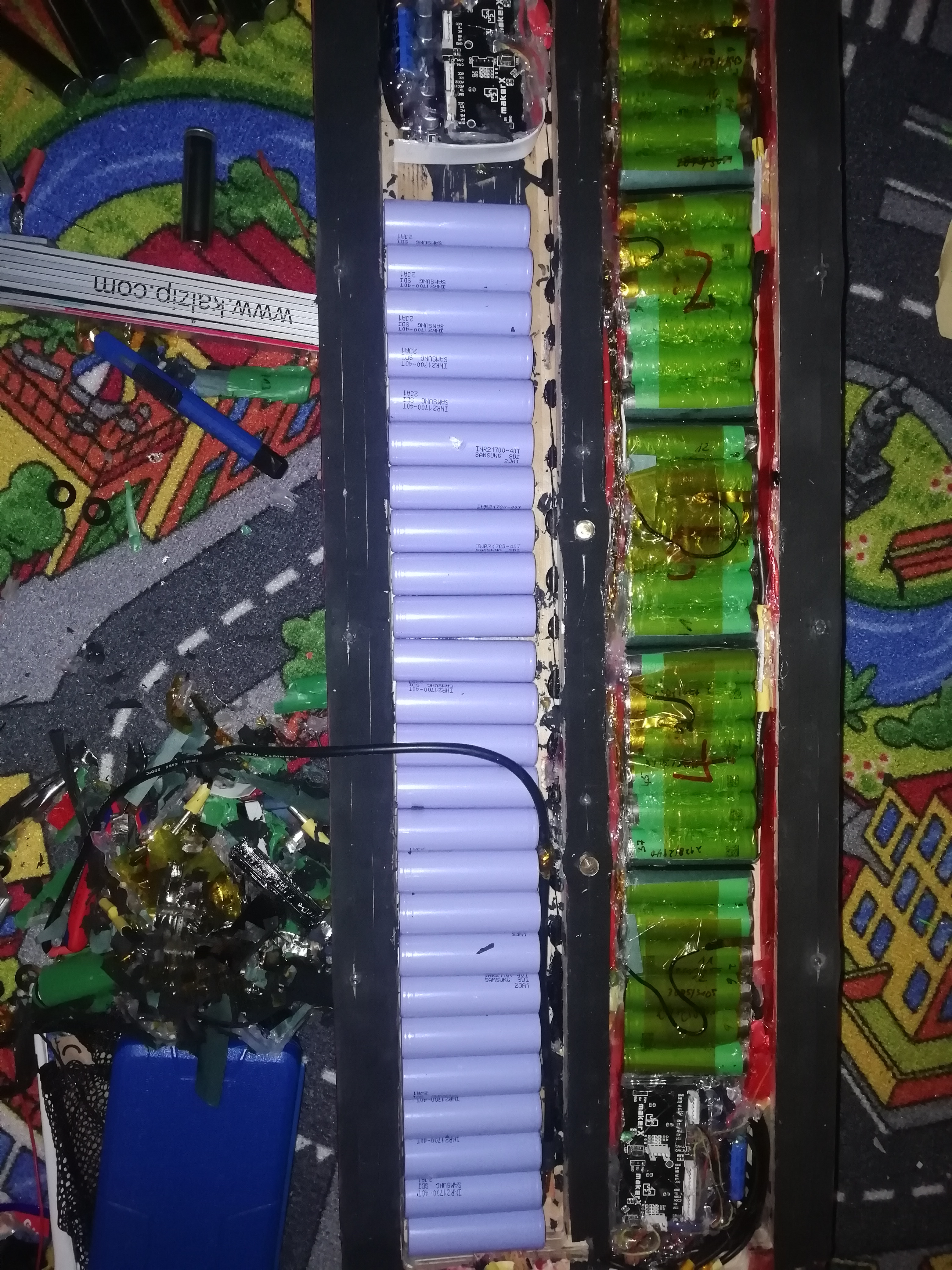

no, its 10s5p. 2Ah more capacity with less overall width of the pack(s) compared to the old battery. Plus I gained some knowledge in the meantime meaning it will be better build than before :smiley: Should also sag less since 40T are rated at 35A continuous making the pack theoretically capable of 175A compared to the 10s6p VTC with safe 90A-120A peak :slight_smile:
Maybe I try to resurrect them but won’t use them in an electric vehicle :smiley: but as a power source for some IoT-thing :thinking:

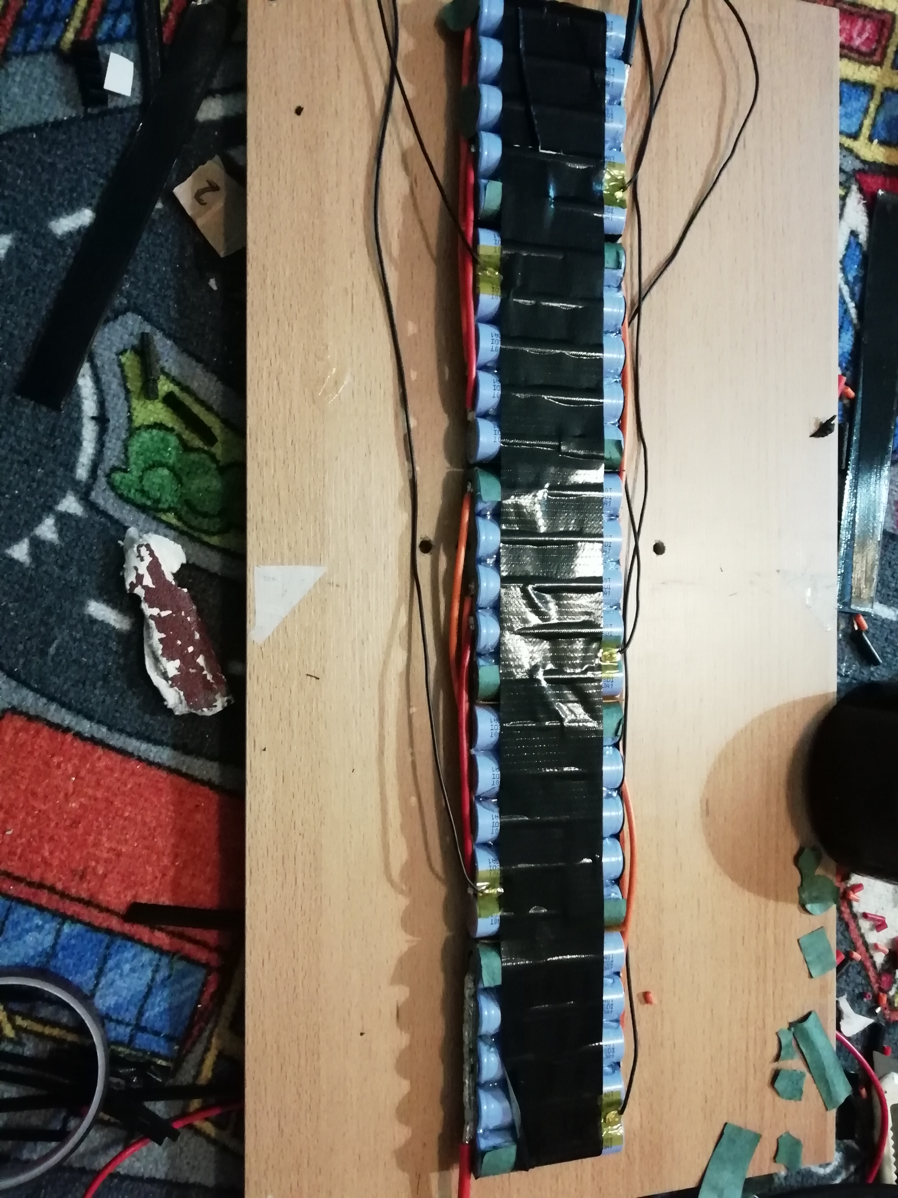

Making progress:

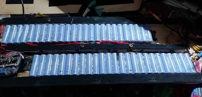

Tomorrow I’ll take the packs to work where I can spotweld (My Sunkko can’t be run at home, blows the fuses :D). Btw, the Sunkko does make welds that are tiny compared to most others but they hold up. No broken welds discovered while I disassembled the old battery.

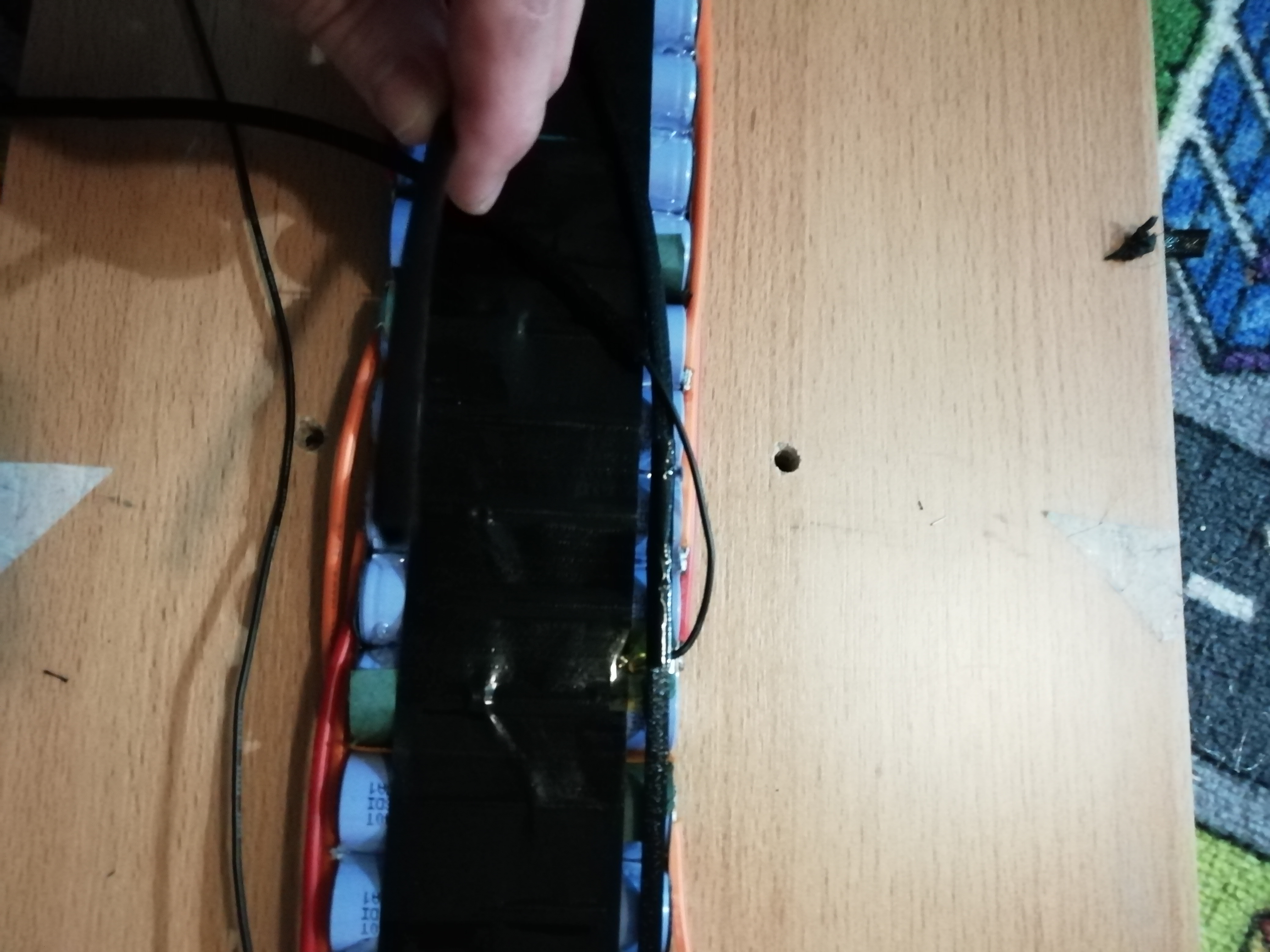

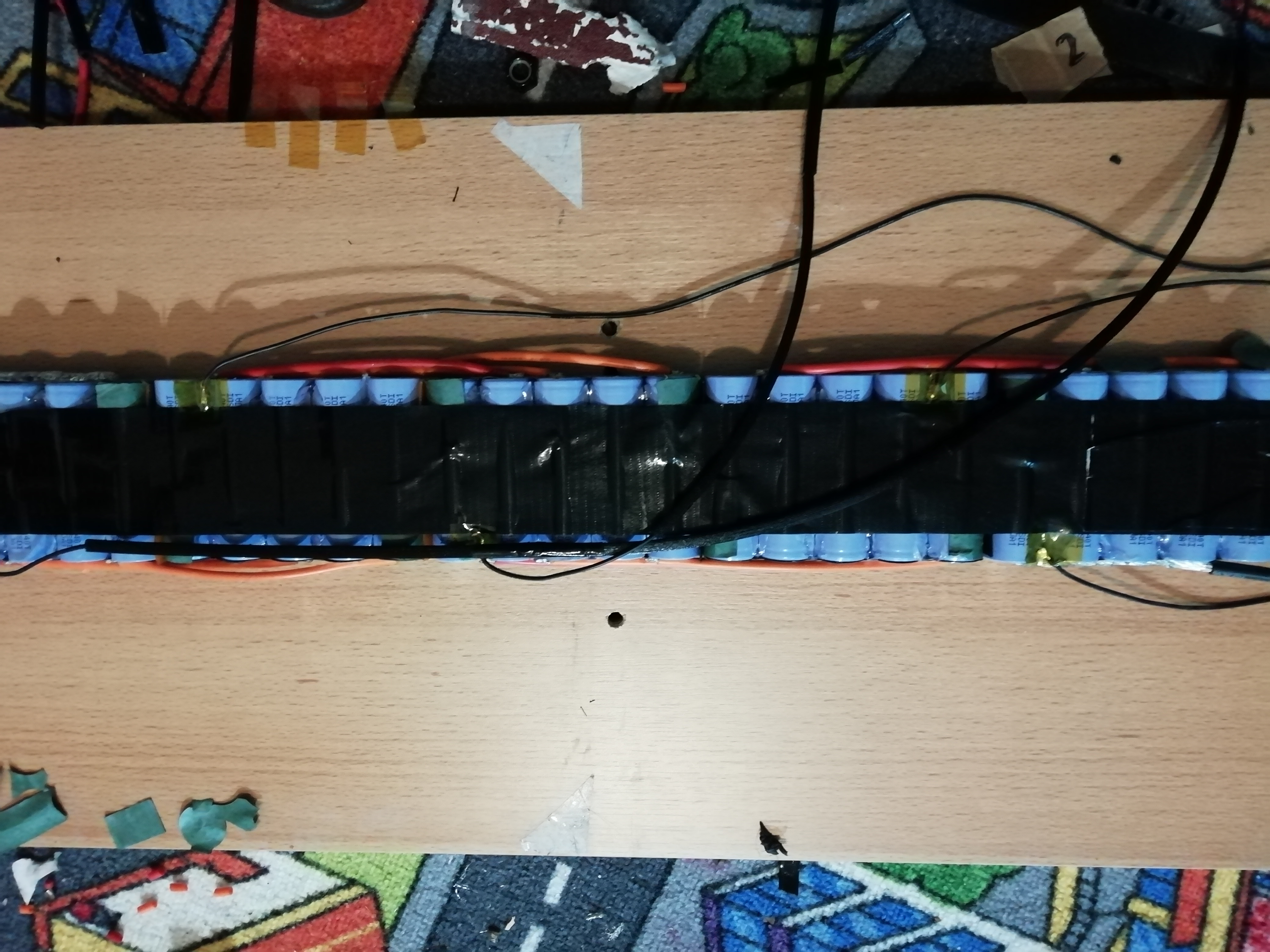

Trying to match the slight curve the deck has. Tried it last time but mixed up the order or something :smiley: This time I learned and documented everything. Cabling will also be much more thought through :wink:
Printed tpu tubes for the balance cable routing :wink:
I know your pain, sounded like a great idea when assembling
What I do now is to put in a heat shrink and only let the silicone touch it, if I need to remove the battery, just cut it and remove the cells, still a pain to remove the shrink remains and silicone residue, but at least there is no chance of damaging the cells
This time I’m doing the same but with kapton :slight_smile:
I connected the 5p-packs with 3x14awg silicone wires to have some flex. It isn’t needed but why not :slight_smile: Its for my tank so a bit more security is not bad :slight_smile: They are seperated with fishpaper and a TPU strip i printed. TPU is very abrasion resistant and has a high molding point so I think its a good choice. For this battery I took my time, put a bit of brain in the balance wire routing before I put everything together and have to improvise :smiley:
