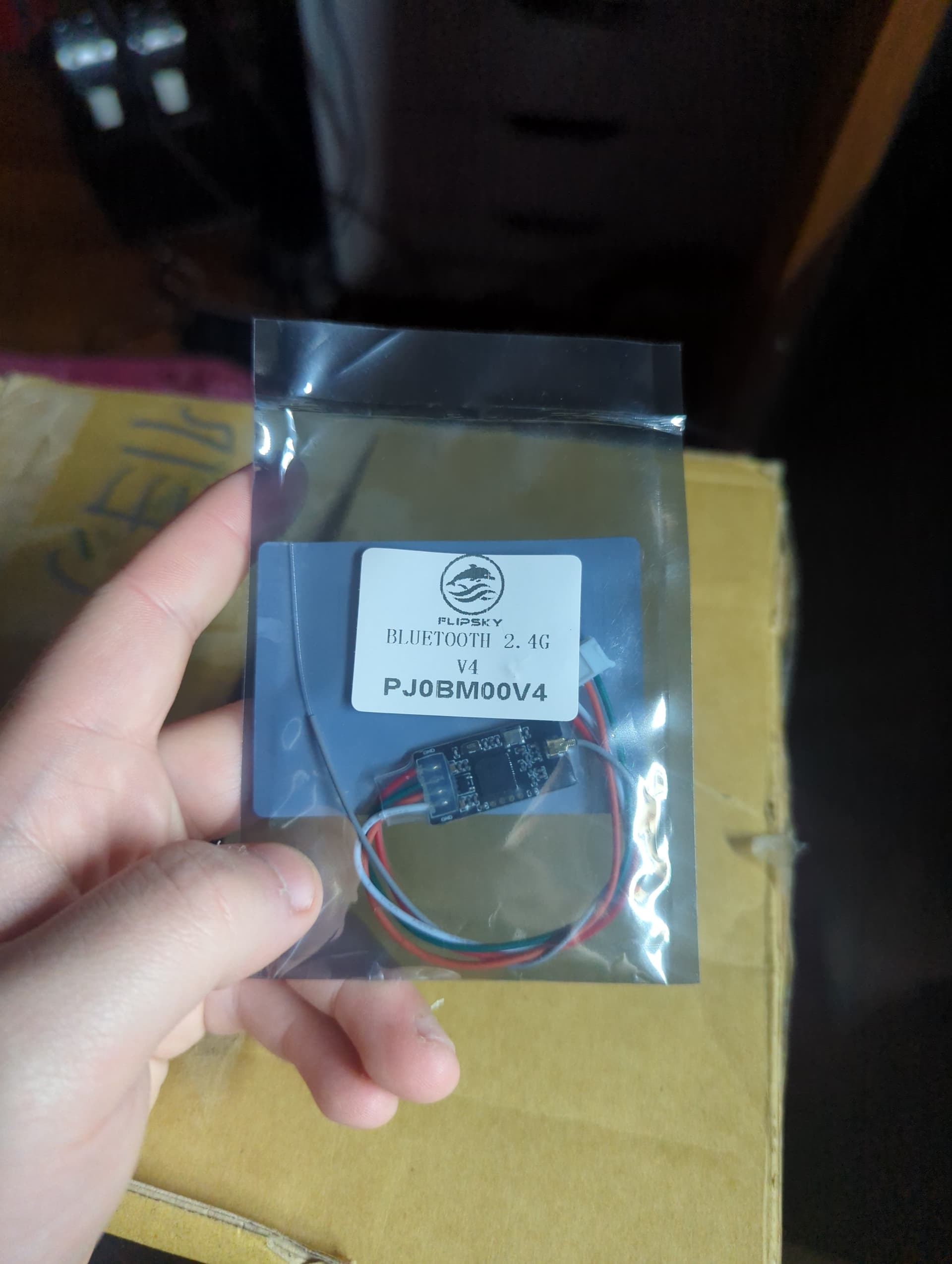

I’m struggling with the phone apps and connecting to both sides of my vesc through BT.
I am using Yours Truly (also tried Xmatic), connected properly to the app, but when I set a new speed setting then write it to the vesc it only applies to the motor/side of my d100s connected to BT.
I’m sure there is something on this page or in the vesc app, I just don’t know where to look.
Anyone know how to diagnose or fix it?

Would my HMsoft BT module connect to the vesc app?
If you can connect to Yours Truly already, I don’t know why VESC tool would be any different. Give it a shot.
How likely is it that my BLE FW is just out of date? I have a d100s with the default FW, all I really want to be able to do is to setup different ride modes in my Yours Truly app but every time I try to “Write to Esc” the new top speed is only written to the side of the ESC my BLE is connected to
Hmsoft? Like an HM10? those haven’t been supported in vesc tool for like 5 years

Ya I think I need to get a new one, Amy recommendations? Is the flip sky one on Amazon up to date enough?
Is right in the vesc tool the best method?
I have one of those burning a hole in my pocket. I bought like 10 of them at one point, don’t ask lol. You can have it for the cost of shipping
That would be amazing! I’ll shoot you a message
