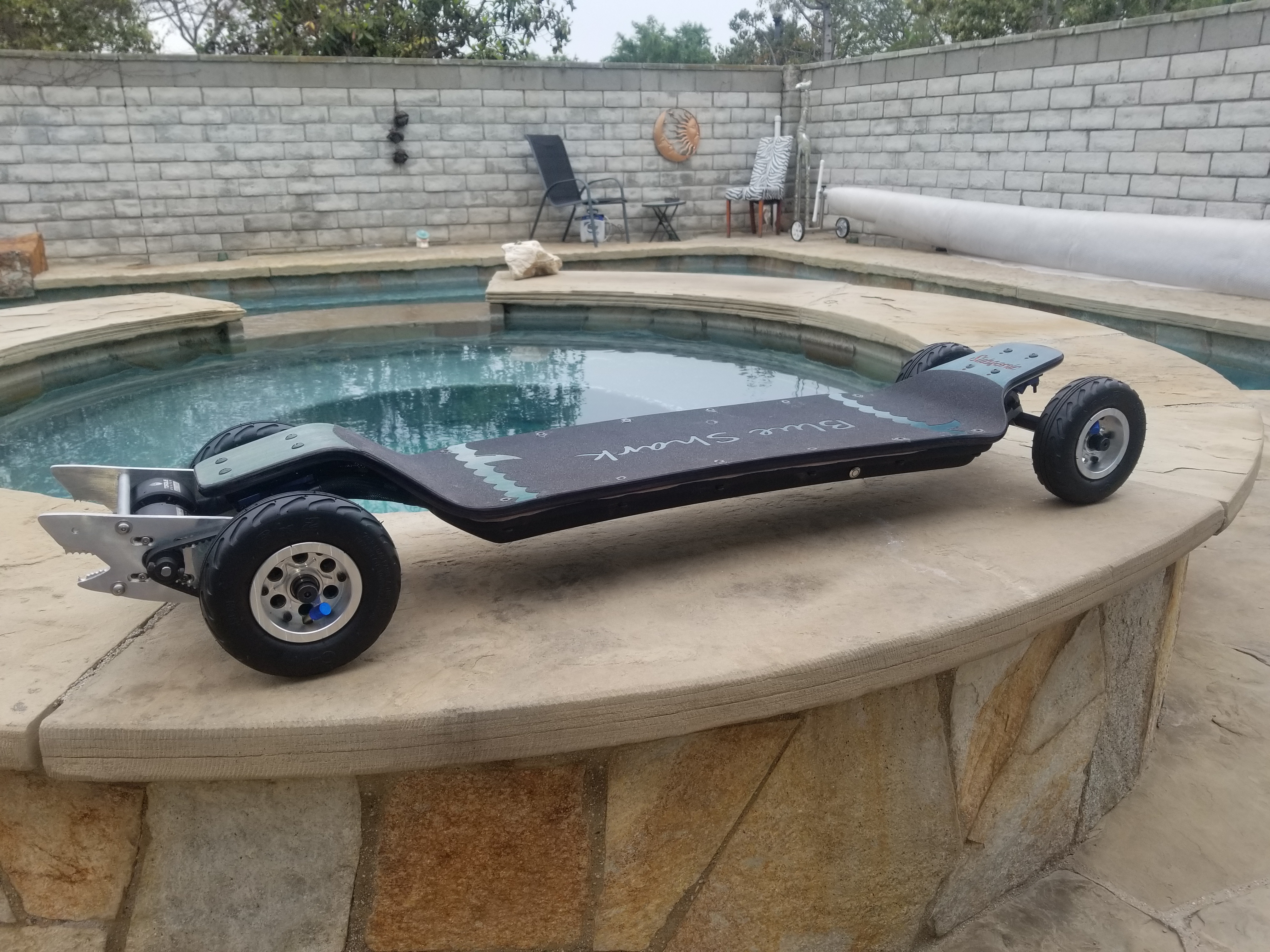

Blue Shark, custom Subsonic Century 40, eBoosted enclosure, Surf Rodz TKP, @damon 10s5p battery, Torqueboards 190kv 6355 motors and 16t steel motor pulleys, Psychotiller Six Shooters and 60t pulleys, @akhlut motor mounts, Torque ESCs, Hoyt St. bamboo puck
I don’t use bullet connections, or xt-60 y blocks to save space. 15 percent of your useable space is connectors .
Well it is officially a skateboard. It rolls around on the floor and all. I don’t like the ground clearance so I have ordered another set of Riptide tunnel risers. Add some Loctite, the risers, and balance the wheels. I will be riding this weekend.

Thanks to a last minute save by @taz, with a fix for my leaking inner tubes, I rode my build for the first time today. It took a year but it feels beautiful. Carvy like I hoped. Takes off smooth as butter. I only went a couple miles and didn’t go past 20 mph. I want to check all the bolts again before I let it rip. Thanks again to everyone that helped with advice and parts. Time to end this forever thread.
Hmm. Now what?

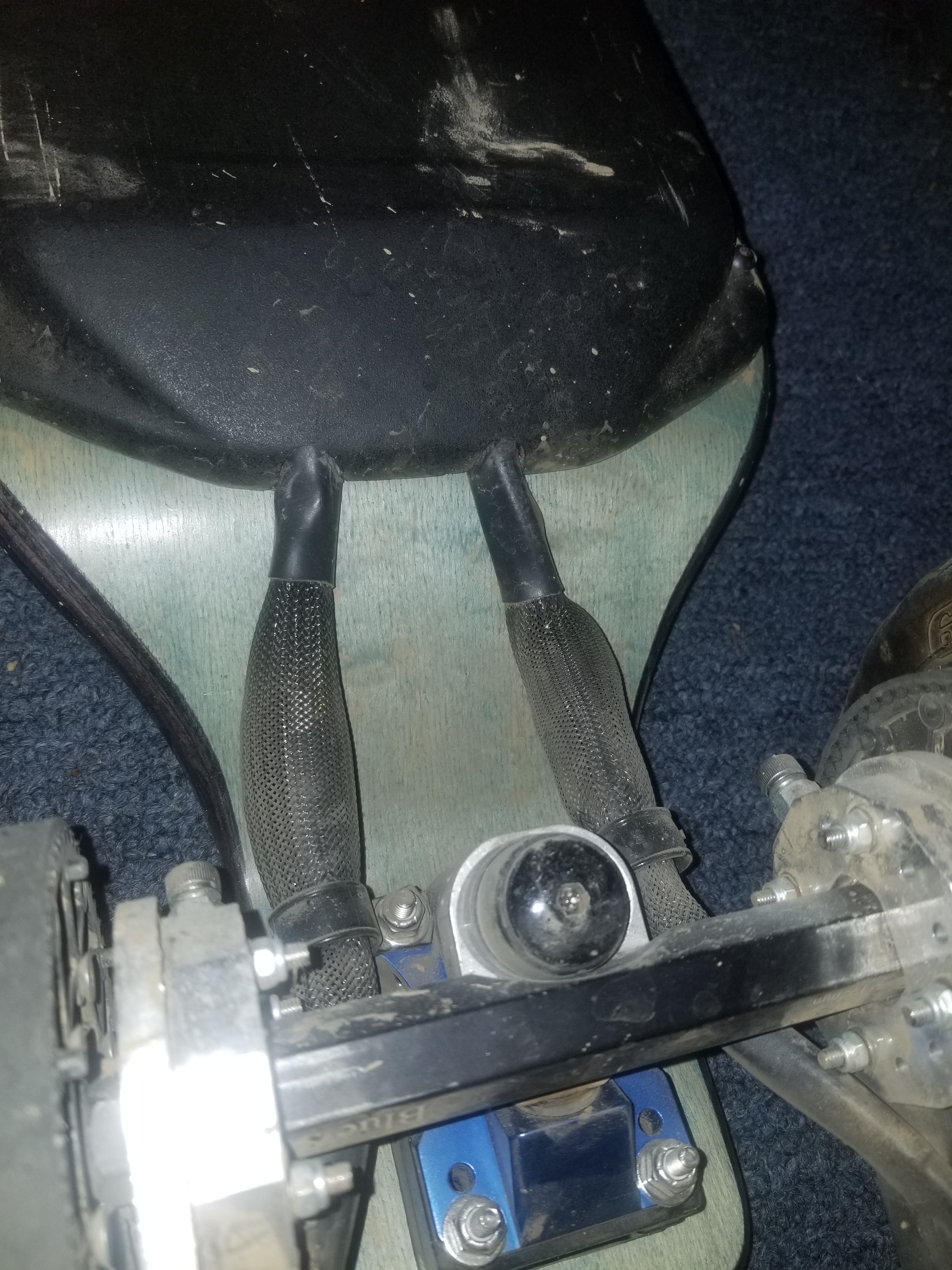

Ooh where did you snag those circle clamp things holding the phase wires to the bottom of the truck in picture two? Nice Build!
Lowes. They had in stock a lot of what I needed for finishing touches. Rubber washers, those clamps, etc. Home Depot didn’t have either. Plus Lowes is just a couple mile skate from home.

Got a pic how you routed the motor cables into the enclosure, please?
I skipped the fancy grommets. I drilled holes through the enclosure and then filed them open to U-shaped slots.
