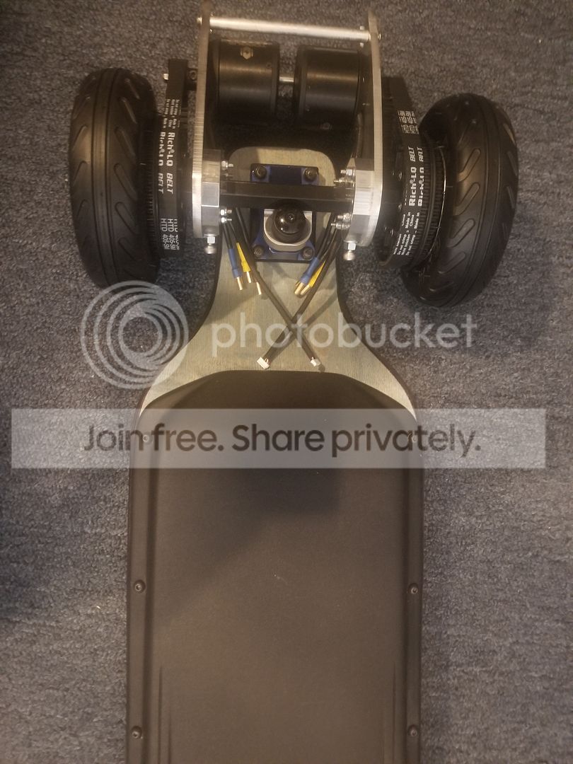

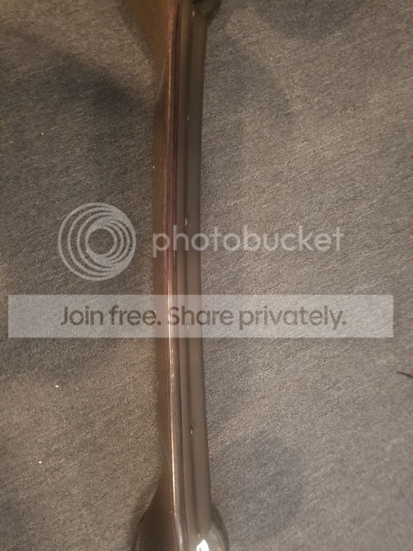

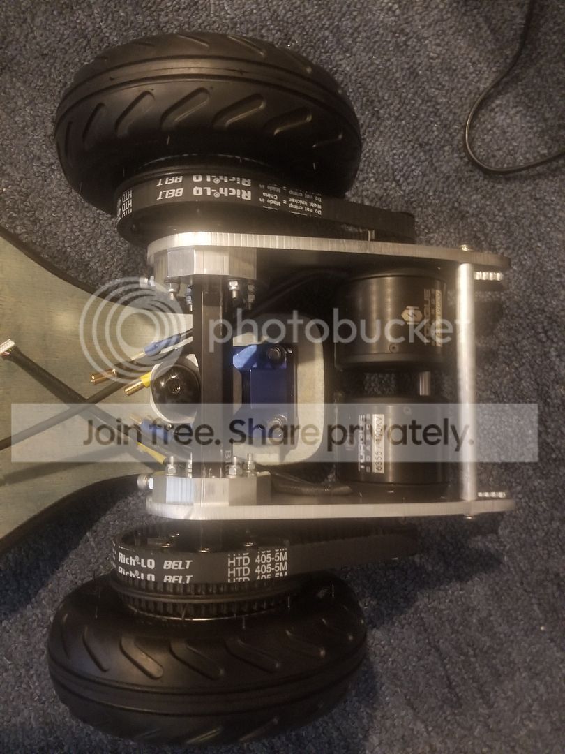

Well I mounted my first enclosure. It could have gone better but it definitely could have gone worse. The holes all line up and the enclosure is nicely centered. I could have done better getting the inserts flush to the top of the deck. Lesson learned: use a circular hole punch and remove the grip around the fastener location instead of trying to drill/countersink through it. I haven’t cleaned the top up yet. I also tightened up the drive train. I installed crossbars. I decided to go with solid aluminum and tap the ends so I wouldn’t have threads and nuts sticking out of my shark mounts. I went a little undersized on the belts to increase the clearance between the motors and crossbars. Despite my lousy picture taking everything is nicely symmetric.
I was concerned about getting the holes the correct distance from the edge of the enclosure so I made a little tool from a drill bit and one of the inserts. Line the bit up with a pencil line on blue tape and then drag the flange of the insert down the ramp on the enclosure until the bit hit the pencil line.

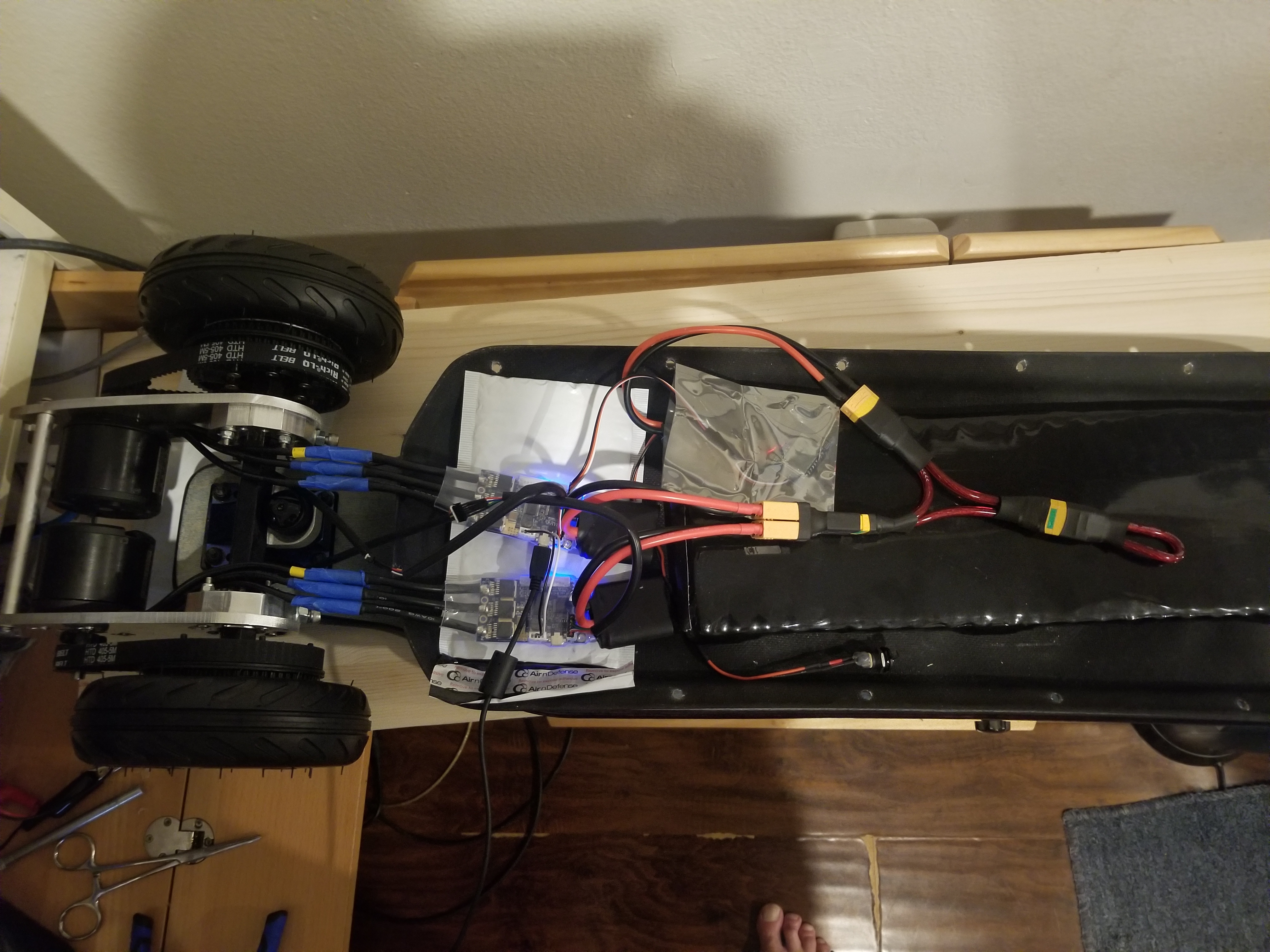

It’s alive!!! Bwahahahaha! Wheels turning full FOC sensored.
The xt90s loopkey setup with 10 AWG was my trial run for setup. The tinned braid arrived today for the build key.
PM me an address an I’ll send you some XT90-s covers & panel mounts.
