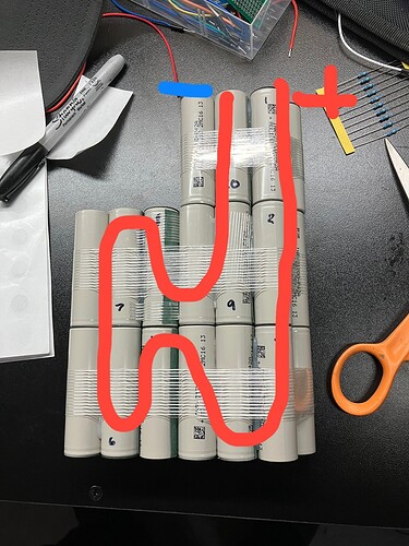

Wanted to mess around with the spare parts popsicle deck i was messing with and realized I didn’t have any small 10s batteries but i did have some serious surplus cells from my leftovers pile so i whipped up a quick pack to fit the enclosure i made while procrastinating this build. They are all matching - was a scope change that left them unused. Don’t judge the tape and fish paper - it was all from my scrap pile :grin: and I didn’t get pictures of the fully insulated or mid points. Went too quick

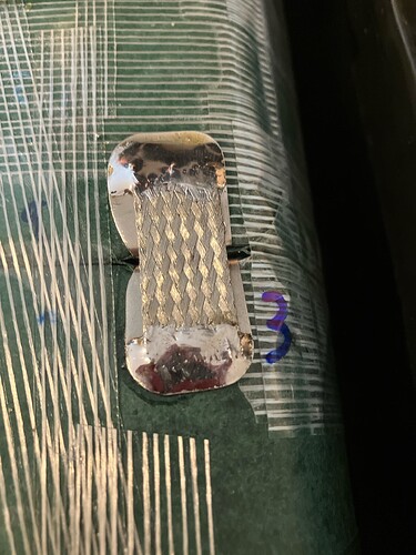

Good test to get my kweld calibration dialed for all the batteries in the que right now. Looked for a used kweld but they are just too good. Really impressed with the ease of use. Took less then 8 tests to get good welds

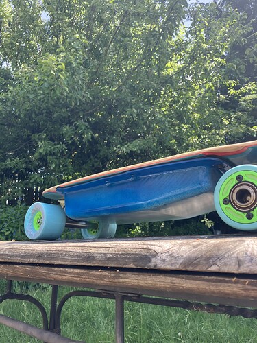

@tomiboi enclosure that @haven traded me was just a bit too big and long and wide for what i needed so i got trapped by indecision on how to proceed. Decided i liked the kinda fat belly look so i came up with a plan.
First i redrilled the front truck holes half an inch further down the nose so the enclosure wasn’t so tight and to give me room for wheel bite. Replaced the boardside barrels with tall barrels. Added 1/4 risers. No wheel bite
Next i did the front and rear inserts. The curve of the deck didn’t fit the enclosure well as it’s such a small board. Also there was a solid 8mm of overhanging enclosure which is no good. Clamped some wood to squeeze the enclosure into about the right width and gently heated it with a heat gun. Did that there or four times until it started looking a little better.
Added the side inserts and went around on each one and heated the lip - pressed it to get it to conform better - then heating around each screw hole and tightened it down with a washer to get it to confirm better and keep my gasket padding nice and uniform. Added a full sheet of high density neoprene foam and trimmed it to size
Seals up well now with a good even print all the way around.

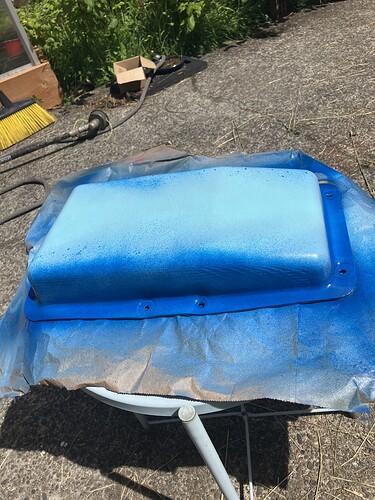

Now to sand and paint it. Imm going to see if i cant find something with darker tones similar to the wheels and grip tape. I might put a mask over it to get a little of that fish scale texture but definitely need to sand the crap out of it first - there is a layer of something that scraps off with a fingernail i need to get under first
Uhhhhhhgggg dry already
Close enough

Ok so 1/4” riser - cupwasher tall 100a barrel boardside, soft (80ish?) cone small cup washer seems to cure the wheel bite i was having.
I threw everything in the unfinished enclosure with the button and wires just through the gasket to tour around and it seems good. I think i need a new set of riptides as the cone is too soft and i cranked it down almost to the point of deforming. Ill go up a duro and be happy i think.
Very carvey still but my big turns are from the kick tail… manuals and 180s are back on the table :grin:
Still dont love the chunky start of the vss but it is done and rideable. And so much fun
Feels nice, still a little loose but really fun in the 12-20 mph range which is exactly where im riding this thing. Has a bit too much power so i might go in and mess around with the settings a bit. Wish i could tweak the vss settings to improve the 0 speed torque and cogging but it’s so light and easy a push to start and stepping off is nbd.
