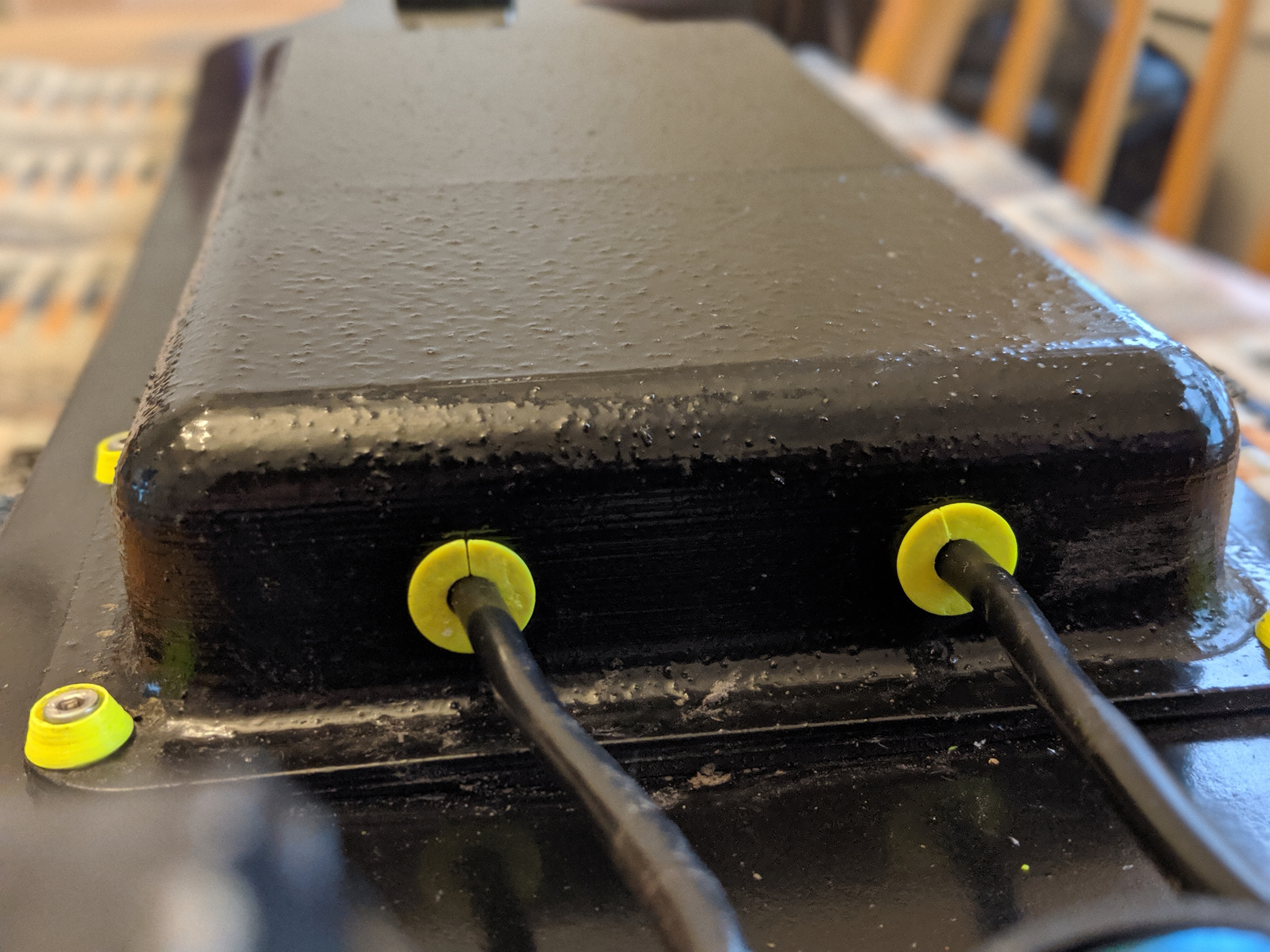

BLACKLIGHT - Elofty Direct Drive / Focbox Unity / 97mm Abec Clones / 10s Swappable Lipo / DIY 3D Printed 2-part Enclosure / Skateshred Deck w/ glass & 3d printed frit

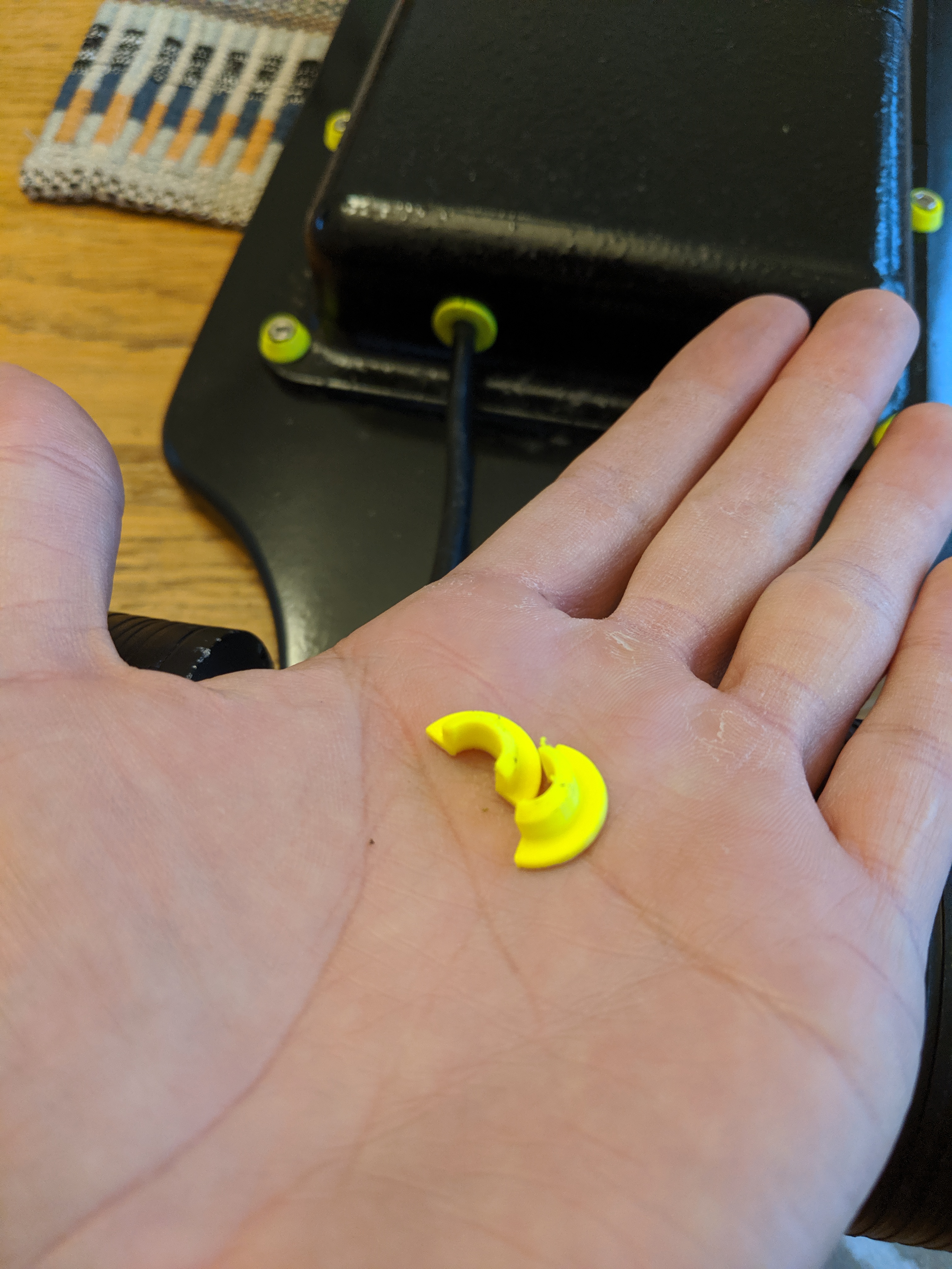

Vapor bathed ABS definitely wasn’t the right solution
Is this breaking from.normal riding?
Yeah completely normal riding. If even call it mellow riding. I need to try petg or maybe design some bolt on until I can get metal ones
weird… so weird I have 100s of miles on my ABS vapor bathed ABEC adapters… I’ve only experienced one failure and that was when the outer wheel bearing disintegrated and then the adapter failed…
Is your STL public?
More accent details. :+1:
I have a feeling that I now understand what may be the culprit of your adapter failure…
On my adapters I made, I added an internal bearing support…
and added an additional inside wheel bearing.
without the additional bearing, the end of the motor can, can “float” I.E. the can is not supported at the nut end and only held in place with friction on the oversized stator.
This caused a misalignment of the motor and the wheel during loading or while riding, the weakest link in the existing set-up is the adapter lugs that will work while in the relatively unsupported wheel, and will eventually fail.
