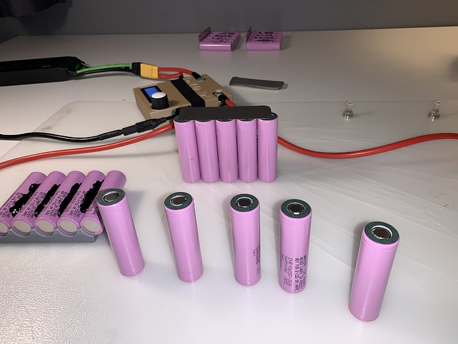

Every time it gets a little easier to make these, and every time they come out a little better quality
12x parallel groups off to be assembled in Florida
I fucked up and I don’t have any final pictures before they were packaged lol
you use black hot glue or something different?
Yes it is a highly elastic lower temperature black hot glue, unlike some other hot glues it does not have a fracturable boundary with the cells so it is nearly impossible to seperate the cells without the shrink wrap shredding first. Both sides have it and there is a slight bit if flex but the radius of curvature is still extremely large
Also black hot glue looks sexy AF and I love jt
yeah it does lol
do you buy it on the good ole internet or at a shop near you ?
I bought 100 big sticks on Amazon for like $20
Can i has link please? I’m only copying you because I admire your work :innocent:
With flattery like that? Of course!
