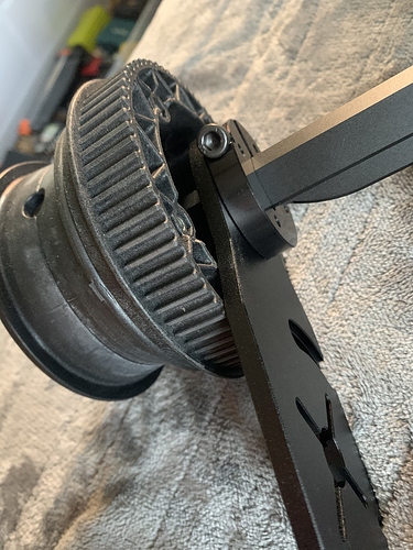

So the front trucks look perfect, the axles go in nicely and it all looks great, but the back is giving me problems…first of all the extra meat in the hangars is preventing the hub from sitting up against the axles because the pulley is already pushing against the mount, and secondly the idler isn’t going to work because the 72T pulley is too close already. I think I’ll be okay by using a 2mm washer and getting the exact belt I need… otherwise I’m kinda boned until the long motor mounts come out

Can you install the motor mount backwards? should buy you .25" if it doesn’t interfere somewhere else
Yes and no, it can be mounted that way but the pockets that hold all the screws would be wrong. There would be a big air gap between the plate and clamp which isn’t great
I think I can get some washers to do the job, I need them anyways. But yeah if all else fails I’m installing them backwards

P.S. @Boardnamics the BN270 do actually work with Rockstar II hubs and MBS’s polymer pulleys, you just need to bottom out the mount to the middle and use a 2mm M10 washer, but you absolutely need the right belts since the idler doesn’t fit…but damn it feels SOLID, I love it so much
Edit: 15:72 with 420mm belts is a magic number for these mounts

Since I can’t get the idler in with the 72T pulley and the motor is a fixed position, the best option I have is to get the right belt and stick with it, in that case 15:72 with a 15T belt

Belts and pulleys came in these evening! The tension seems perfect, a little tight but the belts should wear in very soon, I feel like I very narrowly escaped catastrophe
