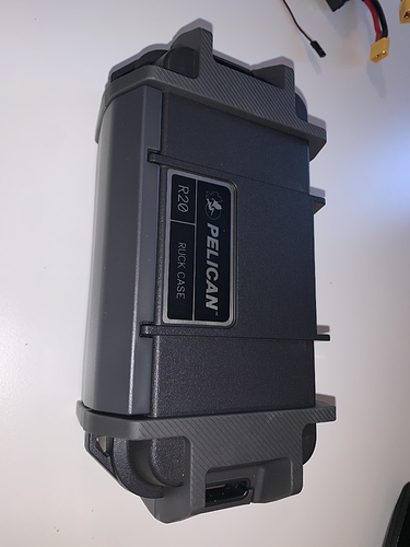

I had some space, l had a little buffer room but apparently not enough. It’s the biggest Ruck case they offer and I wanted it to all look purdy on the outside so I’mma just have to live with the fuckery on the inside
You could technically chew off the rubber and gain a little
@Flasher @Skyart we had a false alarm, I’m just dumb…8x6 stagger is the move lol. I knew this made more sense when I was doing the pre-purchase math
Also I am NOT going to vandalize this beauty…too fuckin’ purdy to go stabbing at
I know
If you didn’t show me that I would have been running another cheap Harbor Freight case lol
Think that will pack dual FocBoxes?
No idea. Never had

The battery has a twin!
I like Pelican’s R series. Stylish
I’ve been hemming and hawing over the cost of the cases for a little while but I’m so glad I got them
