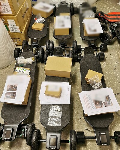

Three more finished this morning :call_me_hand:
Now I understand why I have to wait 3 more weeks for my black Davega :smiley:

More finished this morning:
Pictures of Plutonium are so pleasing for my eyes. What’s the weight of the board?
Roughly 20 kgs :stuck_out_tongue: shes a heavy girl, but I like 'em big so <3
That was not a criticism at all, sorry if it looked like it is.
I’m really ok with the waiting time and grateful of your massive work :wink:
