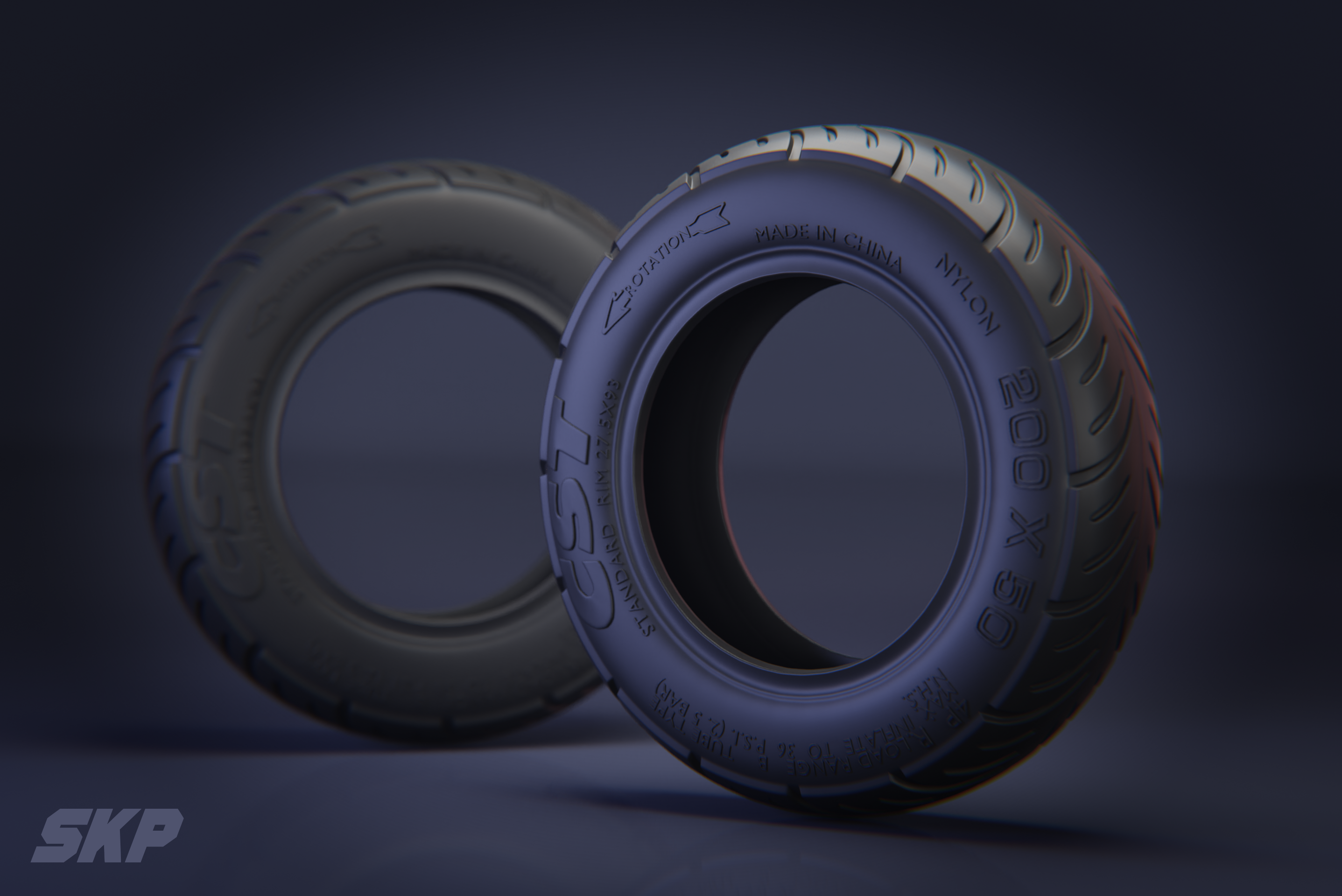

the Hubba hubs from Tomiboi though, looks like they say they fit 6-8’ tires mostly, any opinions on tires or good places to check?
I was thinking of starting with a tire similar to the MBS Roadie? Or the MBoards Nove in 8" as well
I replied to your DM, but just to note, the hubba hubs are quite wide. The MBS roadies arent great tires in my experience, and i’m not sure how well the novas will stretch. I recommend these tires and tubes. They have good wear characteristics, great balance, and good comfort
it requires a phone connection to work. it grabs GPS info from your phone
8” NOVAs stretch onto Hubba Hubs very nicely
7” might work too, but haven’t tried it

Im running 7inch novas on hubba hubs.
Works great!
