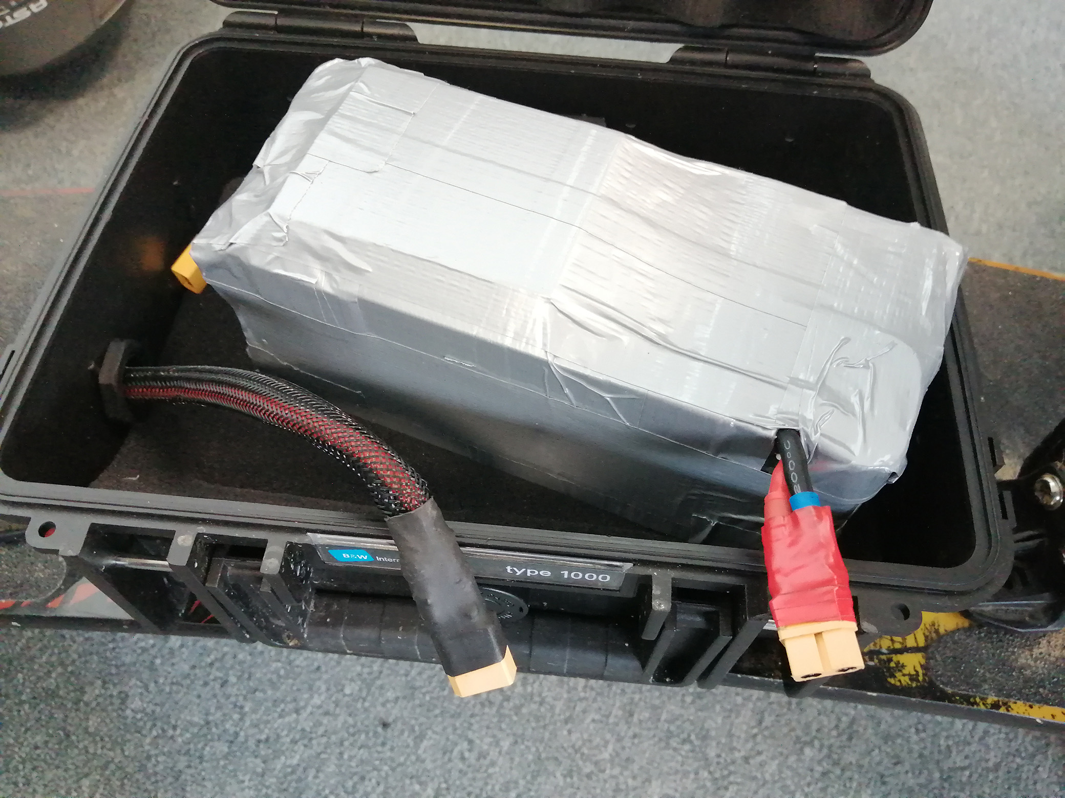

Battery
A friend found a 10S4P bike li-ion battery pack made of LG 18650 MH1, so 12800 mAh. I didn’t asked where it came from and it was already perfectly balanced (insert Thanos meme here).
I put a 10S 60A common port BMS and use a 5A charger, 10 cycles and nothing to report.

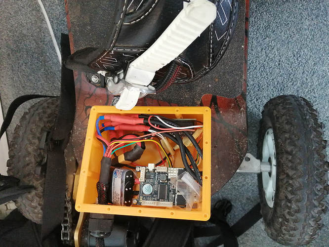

ESC
On my first build i used a prepacked ESC with build-in switch and receiver. This time i wanted to try the VESC so i ordered a Flipsky 4.12 FSESC. Had to find a Korean dude that uploded a VESC tool version that was compatible with it, lot of fun.

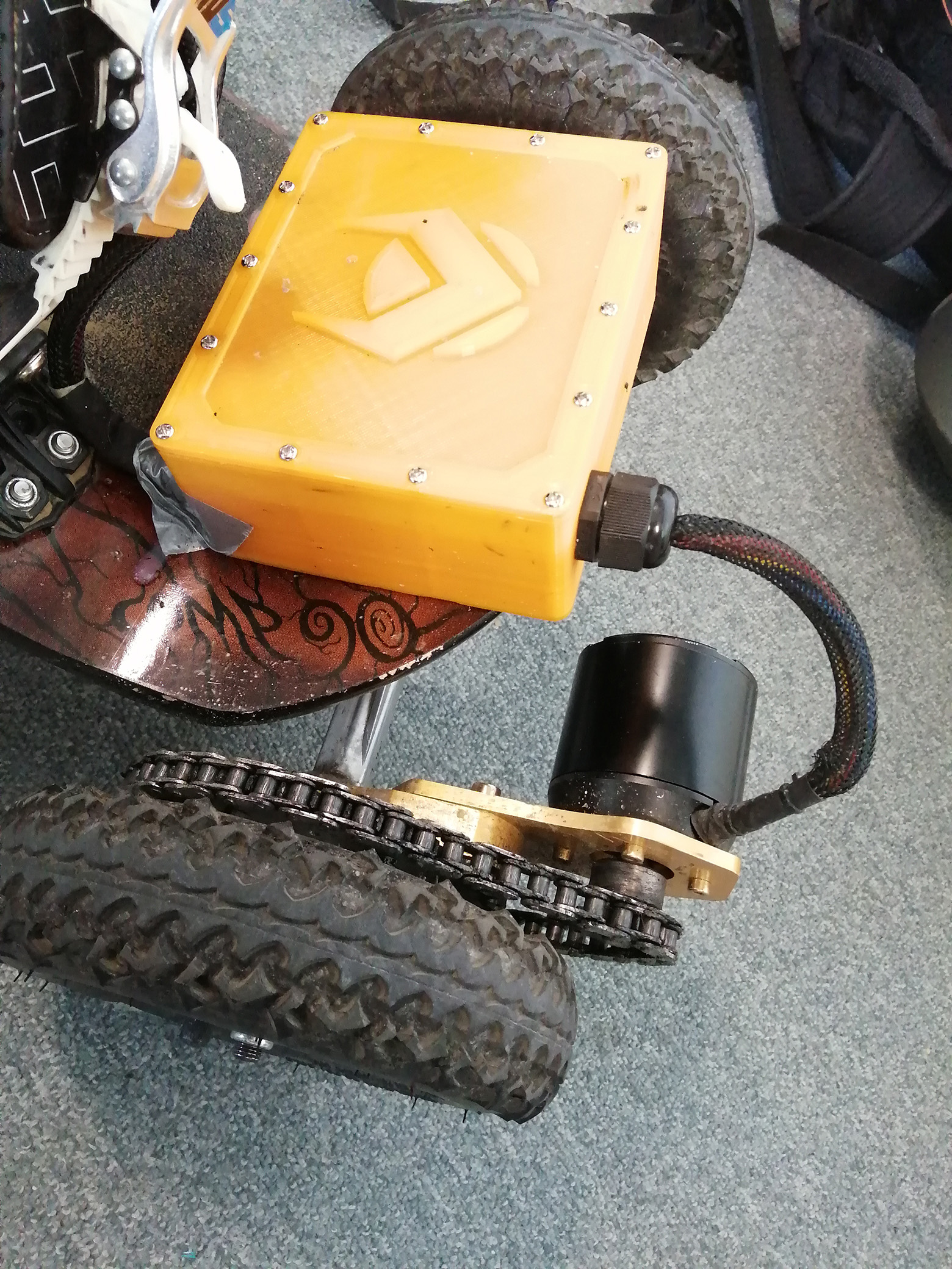

Motor & transmission
A unbranded 6374 170kV whith hall sensor. But a pin of the JST connector broke off so i run unsensored, will fix that next week.
Motor mount and transmission from Overion, the dude is awesome and had everything i needed, even for old vector trucks. The transmission is a 10/42.

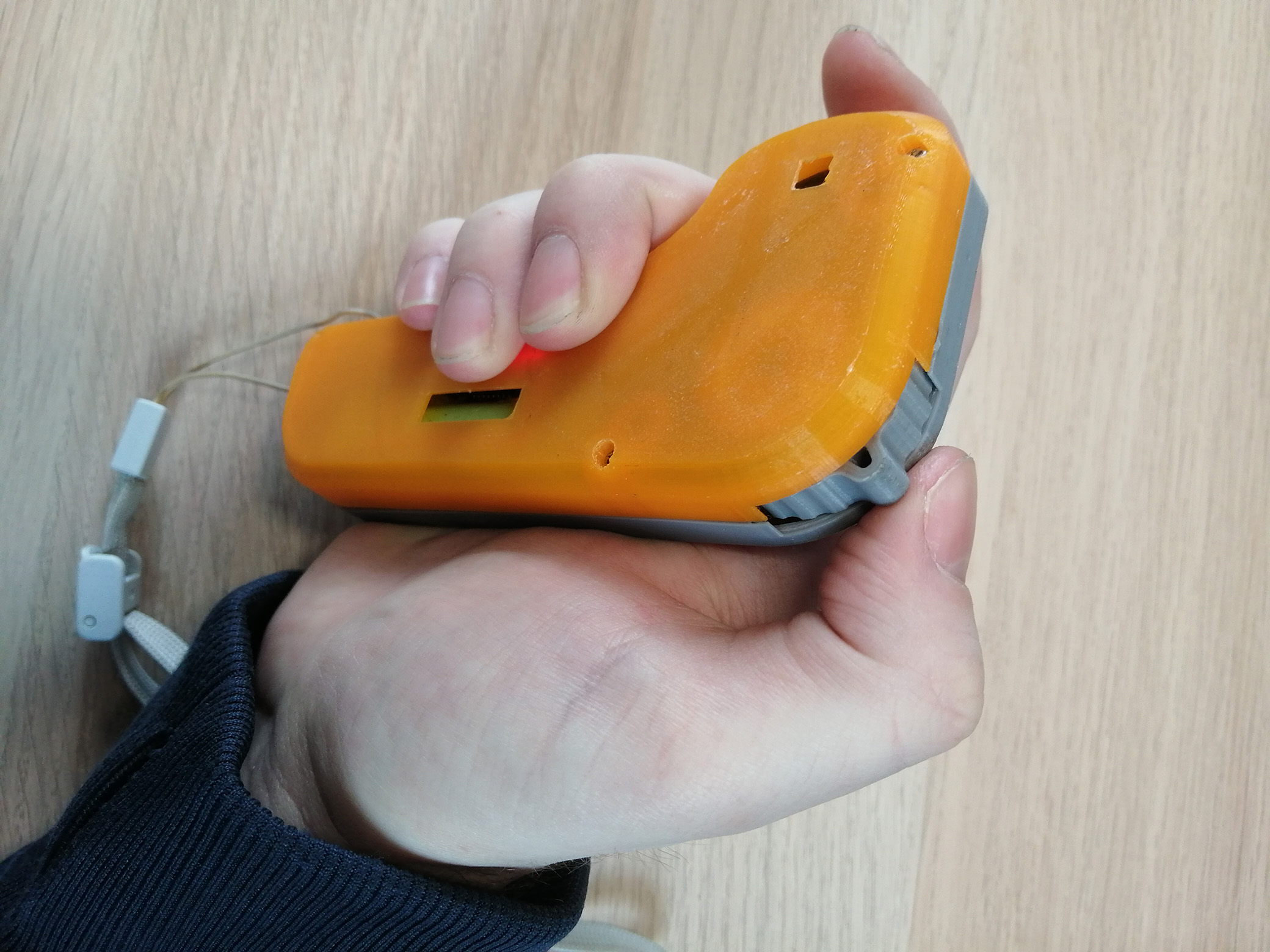

Receiver & remote
Now the shady part. The receiver is an arduino nano with built in RF module.
I looked at many githubs and found the codes to be very good but very complex and with a lot of features i don’t really need. So like most programmers i know, i did y own better shitty version because i think i know more than other people.
So the receiver connect to the remote via the build in RF module and just send a PWM signal to the ESC, keep it simple.
For the remote, i took SolidGeek’s remote and literally switched everything but the thumbwheel mecanism. I use another RF arduino nano and wrote the code for it. I wanted to put a little screen but the battery was too big ><, i don’t have small lipo so i just put a 18650, i think the remote can last 2 weeks between charges.

Think about getting some HW6 VESCs, apart from suboptimal performance in general, HW4 VESCs reportedly have very non-linear acceleration:

Even with a single motor, that battery might lack for power a bit, especially on mtb. MH1 cells are only capable of 10a per cell. At 10s and 40a, especially with a 4:1 ratio on one motor, your motor is gonna be working pretty damn hard.
Also, the 60a BMS should probably be 40a if you are discharging through it.
I agree, it’s pretty weak in some situations. My biggest problem is going from a full stop, it takes 3/4 seconds to get me really moving, i weight 100kg (220lbs) and sometimes cars aren’t really patients with that kind of delays.
The BMS was ment for a 10s4P of 18650 samsung 30Q, i ordered them from nkon and they are sitting in the box, waiting to be soldered.
Is it really a problem tho, since you can setup a max battery discharge rate in the ESC ? Real noob question here, i don’t want my thing to explode under me with an impatient bus on my tail :stuck_out_tongue:
Nah its not a big deal if you are aware of it and have your vesc settings set appropriately.
Many people here bypass the BMS for discharge and rely on vesc settings anyway so its all good.
